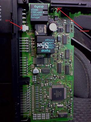

Originally Posted by Dan1969
Try operating your windows individually, if they work from each other control then you new a new one of these. If that doesn't work, then you might need one of these, but this would read as an implausible signal for ALL of your interior electronics so I think it's just the master switch. If it's not the switch, it could just be the wires connecting the door to the body of the car.
Thanks for the reply.
windows do not work from any swich. door wires seem to be ok, I have lights in door, mirrors work, central locking work from remote.
I do not think it's any comfort module.
I attached a picture of motor driver side windows. I measured with a voltmeter and i have power, but when i press the swich nothing happens
If this window motor is down why the rest of the windows does not work.
relays on this board works, but only make noise when using central locking.
many thanks

Old 11-28-2012, 02:37 AM
Dan1969's Avatar
Join Date: May 2009
Location: South Korea
Posts: 1,682
Try opening all your windows with your key, if they open then get another switch. If they don't then it would be all four motors... I could very well be the one motor on the driver side, but don't rule out the switch quite yet.
