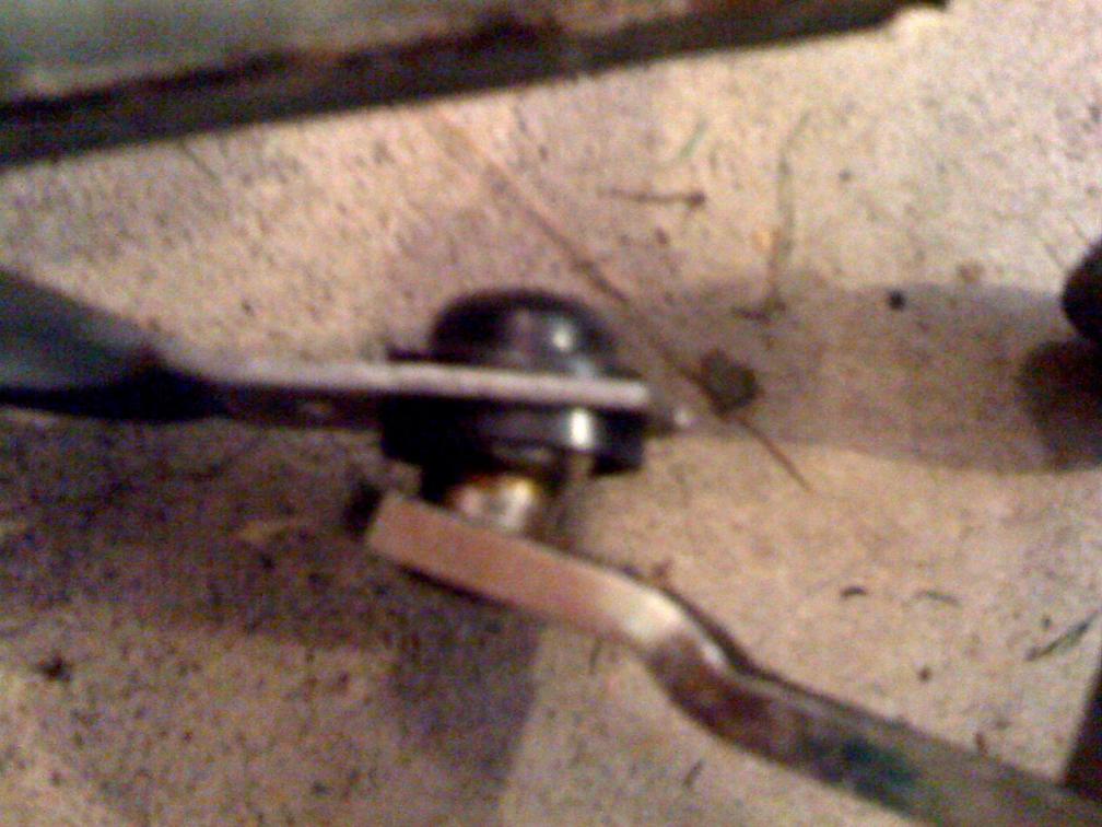

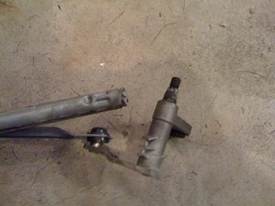

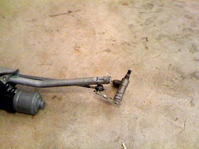

I had the same problem, but the wiper motor actually twisted the frozen spindle until it broke off of the support bracket.
So, I bought a new bracket at the dealer - $200 - removed the wiper / motor assembly (note, I used a gear puller to get the wiper arms off of the spindles - loosen the nuts several turns, hook up the puller such that the screw is held in place by the loosened bolt)
My problem now, is how do you separate the ball and socket joint connecting the linkage from the motor to the spindle? Is this pressed in or is there some trick / tool I need?
Thanks for your help. I think this is the last hurdle before I'm done.
Hey, you may have completed this already but for what it's worth, I actually completed this on my vehicle yesterday. Take two flathead screwdrivers and put them on either side of the joint then use the arm as leverage and you should be able to pry it right off.

* Getting the linkage off of the spindle ball joint: I actually used a suspension ball joint separator (that I had from when I used to work on old Mopar Muscle cars). Gently place the fork around the connection and give it a light tap - pops right out. Overkill maybe, but it was quick work.
* Getting the wiper assembly out of the car: tricky, but since my driver side spindle was broken, I was able to move things around a bit more. You might try different wiper positions to get it out - manually turn the motor with the gold bolt to see if it gives you more room. Disconnecting the wire may also give you more mobility options.
* My windshield was already broken - when the spindle broke, the wiper promptly crunched into the windshield and cracked it.
* if you have to remove the nut from the motor in the course of the repair, be sure to mark the location of the little arm that drives the linkage to the spindles. At "home", the arm points directly to the passenger side of the car, but, if you move it around while extracting the whole thing, you need to note it's location. I was able to remove the motor from the base bar without disconnecting the linkage from the motor.

So, I saved around $300 in dealer labor and spent ~$200 for the new wiper base
Thanks to all who posted and helped me with my problem.
