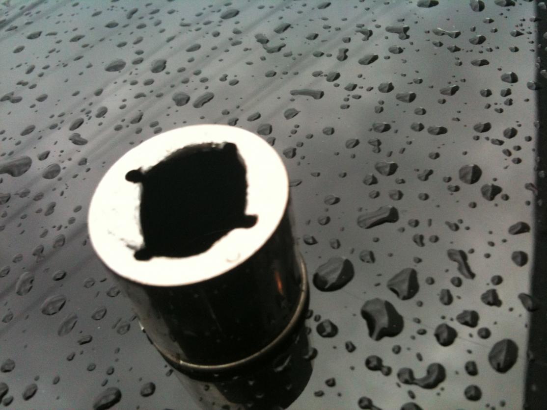

My warranty runs out at 119K. I decided to check the cam follower just to be on the safe side and I guess by the picture you can see that this one has bitten the dust.
The cam follower has a hole in it, and the cam shaft although soft to the touch, when you run your nail across it, you can feel the scoring on the cam lobe.
Need new cam, new pump with cam follower, and also check the engine for any metal left behind from the follower plus a complete oil change. I am very very lucky, that I had this checked or else it would have been a very costly repair. The dealer is going to replace everything on warranty.
