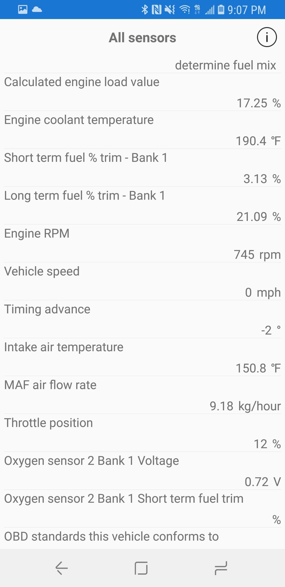

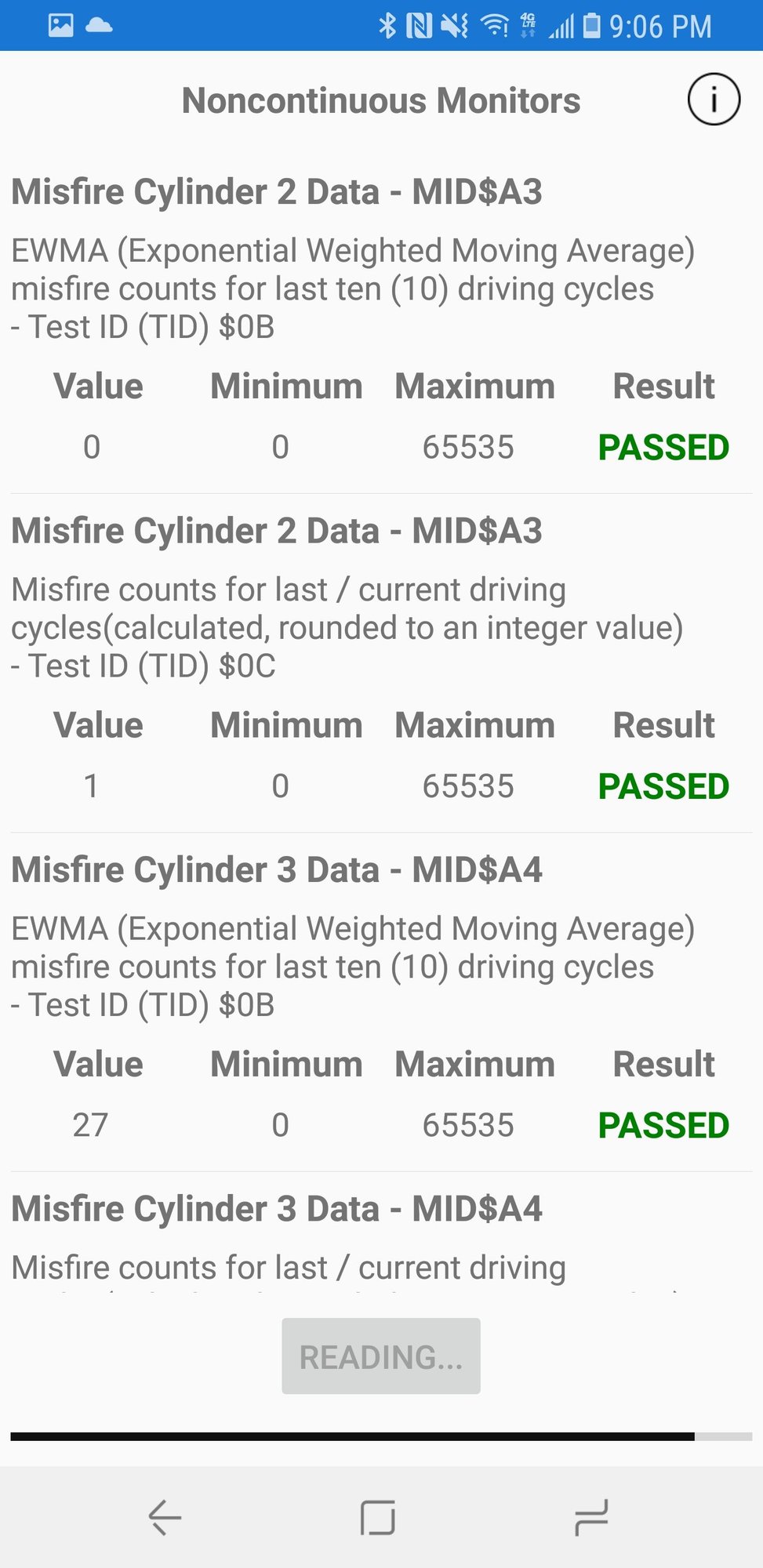

So prior to all these problems i had a broken timing belt/destroyed engine. The shop i took it to rebuilt the engine and ive had nothing but problems since then. The biggest culprit being a cylinder 3 misfire. Along with camshaft position slow response, and system to lean. One other code went away after replacing the vvt solenoid and the cam position sensor. A pcv valve also got it running smother. A compression test was done. Still working with the shop since about February and i dont really know what else to do?
Going to try to include screenshots as well from my wifi odb reader
​​​Thanks in advance guys
