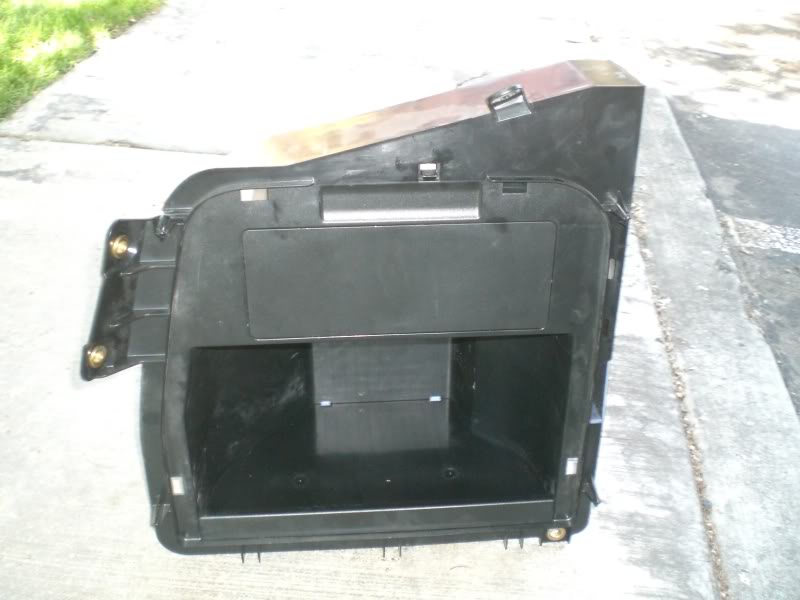

This is the front of the little cabinet. It's an older model, so it doesn't have the same hinge door that ours does, but the SAT location is still the same.

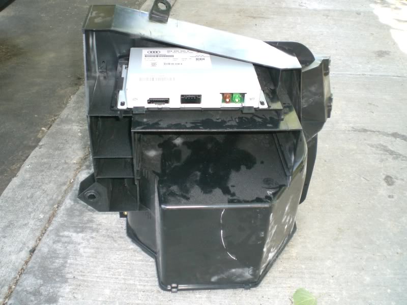

If you spin that cabinet around, you'll see where the factory mounted SAT turner goes. This way it isn't in the cabinet, to possibly get damaged.

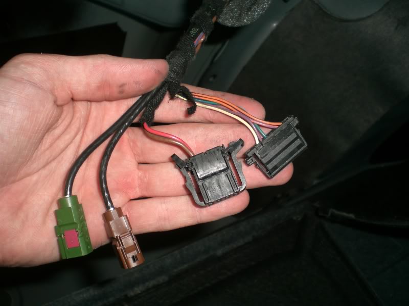

Your car will be pre-wired for all of this. You simply need to remove the drivers side (left) trunk lining and take out the cabinet. Then locate the wires to plug everything in.
