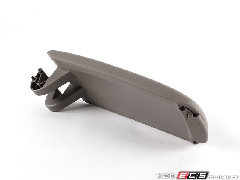

I don't think there's a real answer to the interior color question. Audi only does a few different leather colors, so it's pretty easy to pick. Your best bet would be to physically remove the lid itself and carry it into the dealer with you and say "I need this."
It really was a quick fix. Just flex the hinge and it comes right off.
Here's what it looks like:
Where did you get that pic? Can I buy it online once I get the name of the color and type of material (leather or faux)?

I just did a google search for "Audi A4 Arm Rest Lid" and there it was.
