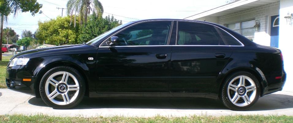

Sport Suspention is springs and struts only. Not a wheel package. My B7 and B6 before that both were sports but had 17's. If your car looks like a monster truck you are not sport. If the gap is small and looks clean then you have a sport.
See attached pic. Not monster truck!

Yeah I got a monster truck. It's irritating.
I wonder if going to 18's will fix the gap? The funny thing, the gap is much larger in the front.

18's with proper tire size will be exactly the same size diameter so no, it won't help. Unless you go up in size on your tires to fill the gap a little but your speedo will be off.
