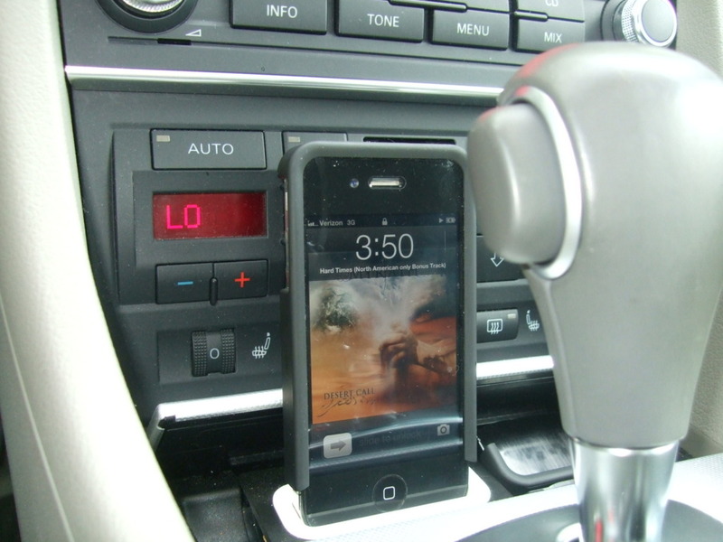

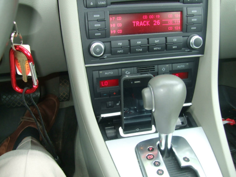

Cracked a black ipa and installed tonight. Took 1 hour and 15 minutes. Most of that time was running the wire from unit to sat module for sat pass.
A couple of observations:
1 The video for the specdock install shows drilling a 1/2" hole in ashtray. This has changed as the end of cable has a female ipod end to it now. Using a dremel with a cutting attachment, I cut a slot in bottom of ashtray to fit the end through.
2. This is worth it.. Nice clean finish, even wife was impressed with fit and finish.
No step by step for this one, videos do a great job showing what needs to be done!
