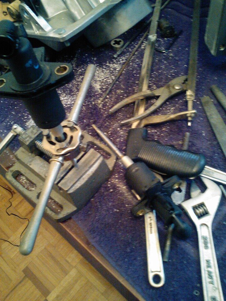

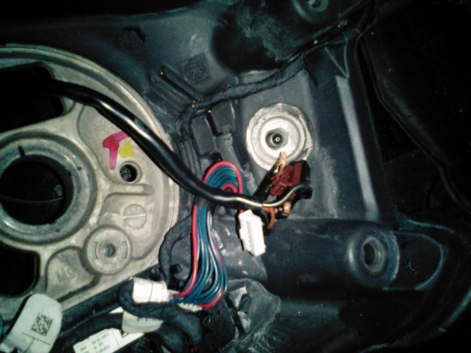

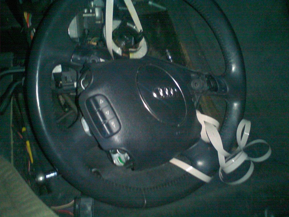

steering wheel
8 Attachment(s)
Attachment 23717
this is kinda how you'd start
Attachment 23718

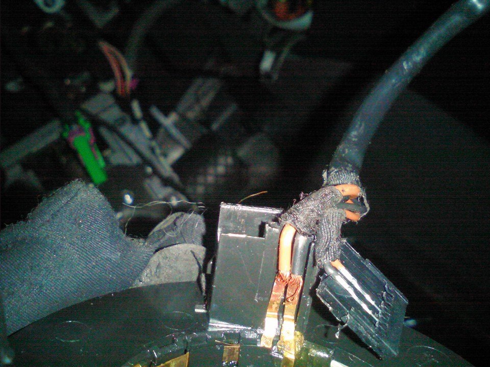

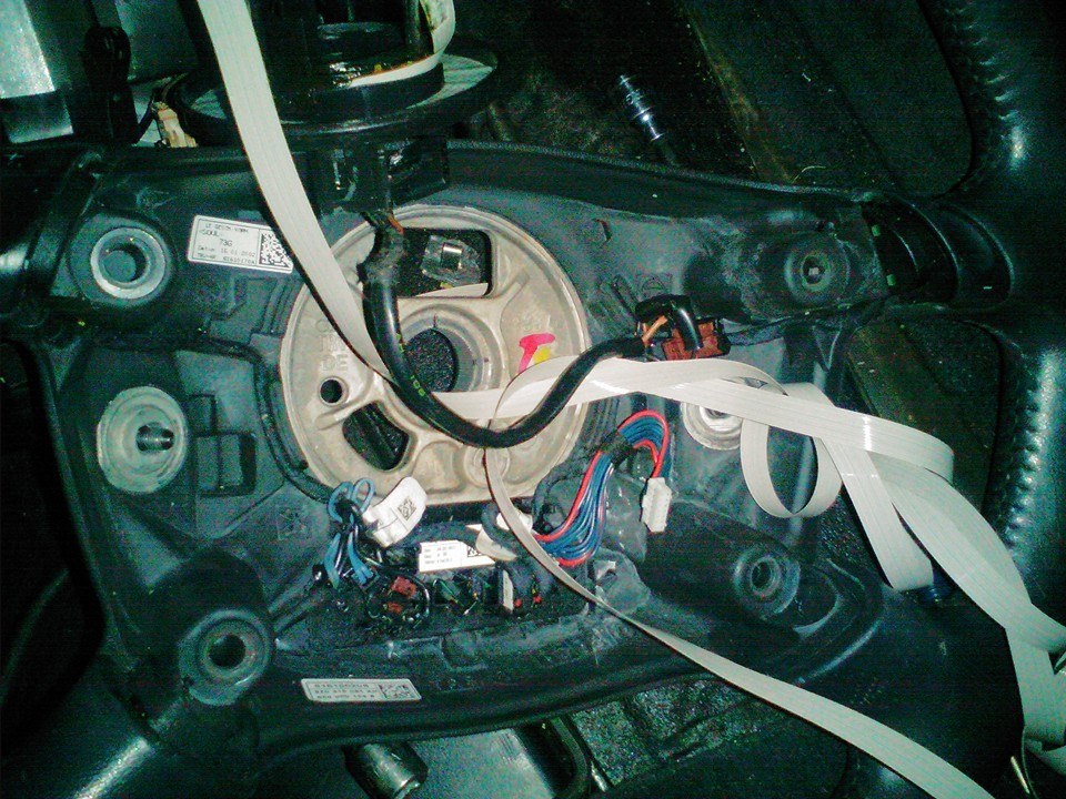

take off airbag by screws in back of wheel
Attachment 23719

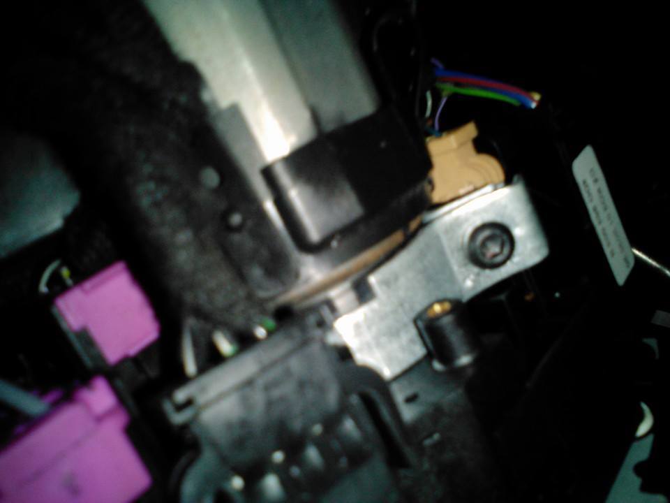

then you're here. the black wire take off from this side because
Attachment 23720
it will look like you can disconnect from here(rotating piece) but you CANNOT smh...it looks like a disconnect but is not
Attachment 23721
one screws holds ligh signal module on remove....
Attachment 23722
comes free
Attachment 23723
WARNING if you take off rotating piece from signal module this ribbon will unravel
Attachment 23724

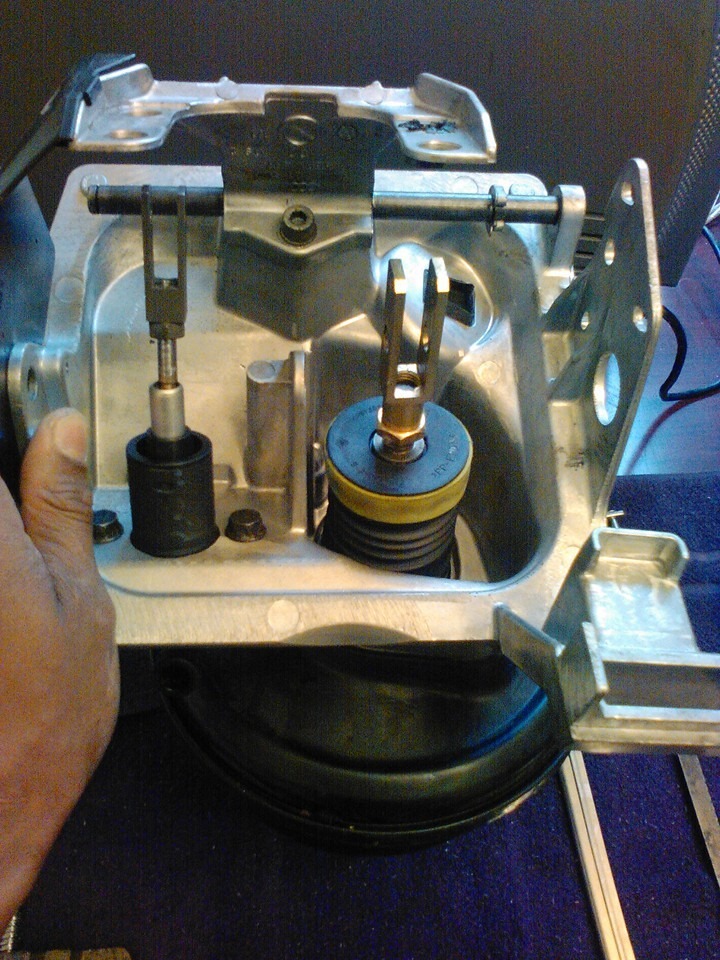

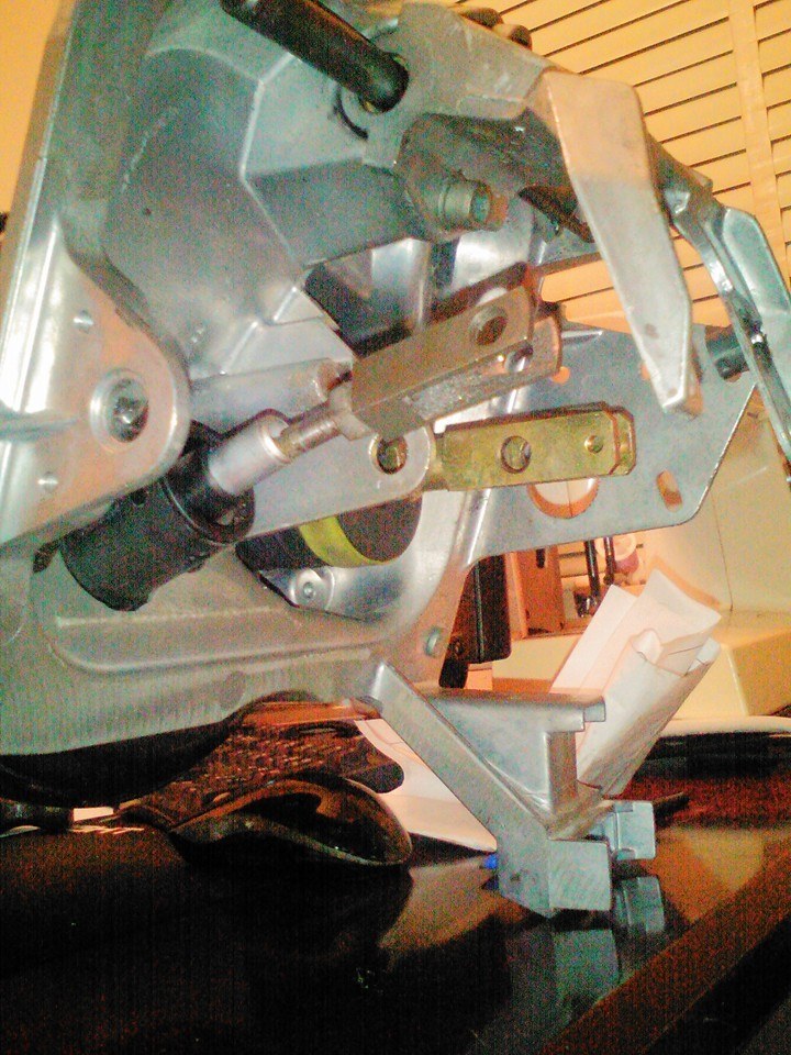

tiptronic cable lock... put key in and turn to 'on' position to remove

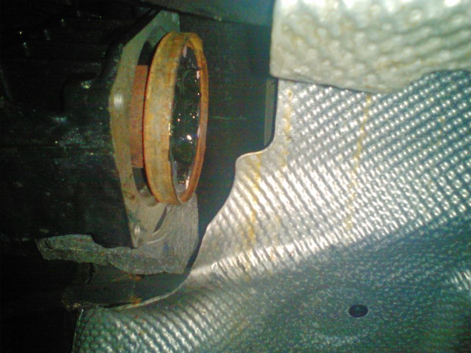

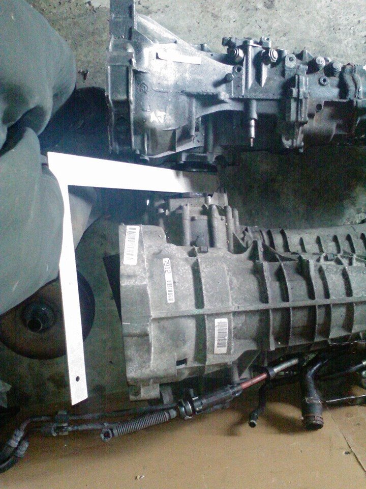

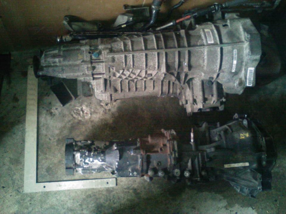

the two trans
Attachment 23689
Attachment 23690
Attachment 23691

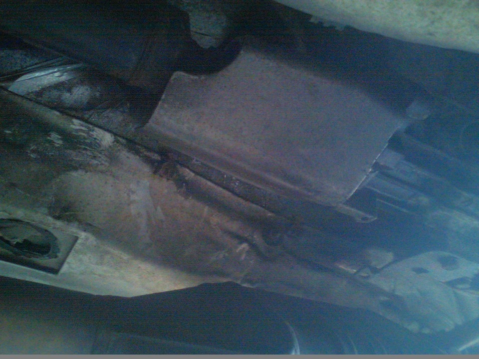

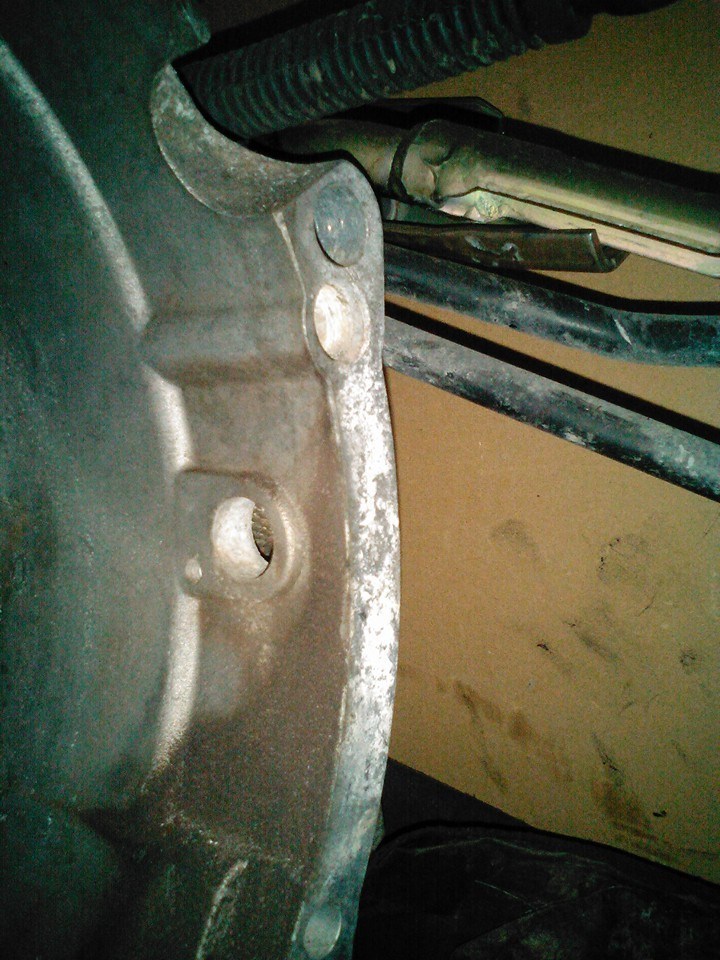

CPS on 01e is above dowel pin.....
Attachment 23692
CPS on auto is below dowel pin
Attachment 23693

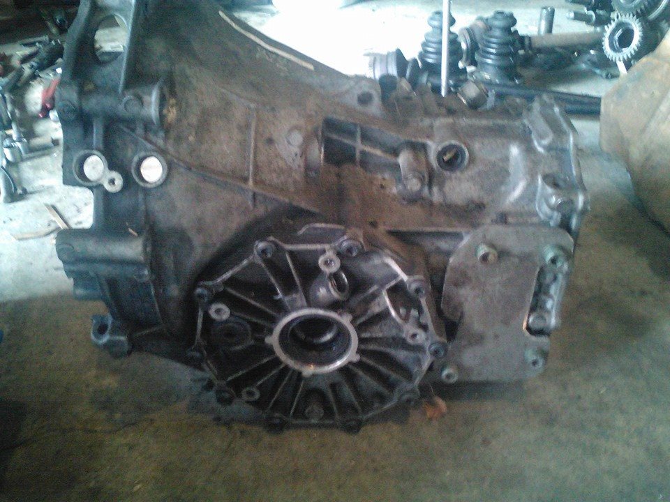

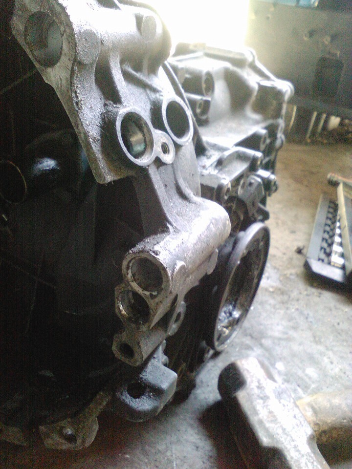

I rebuilt this awhile back. Had the locked 1 and 2 selector hub.
Attachment 23694
this is a way to pull the back off a 01e
Attachment 23695
Attachment 23696
Attachment 23697
Attachment 23698

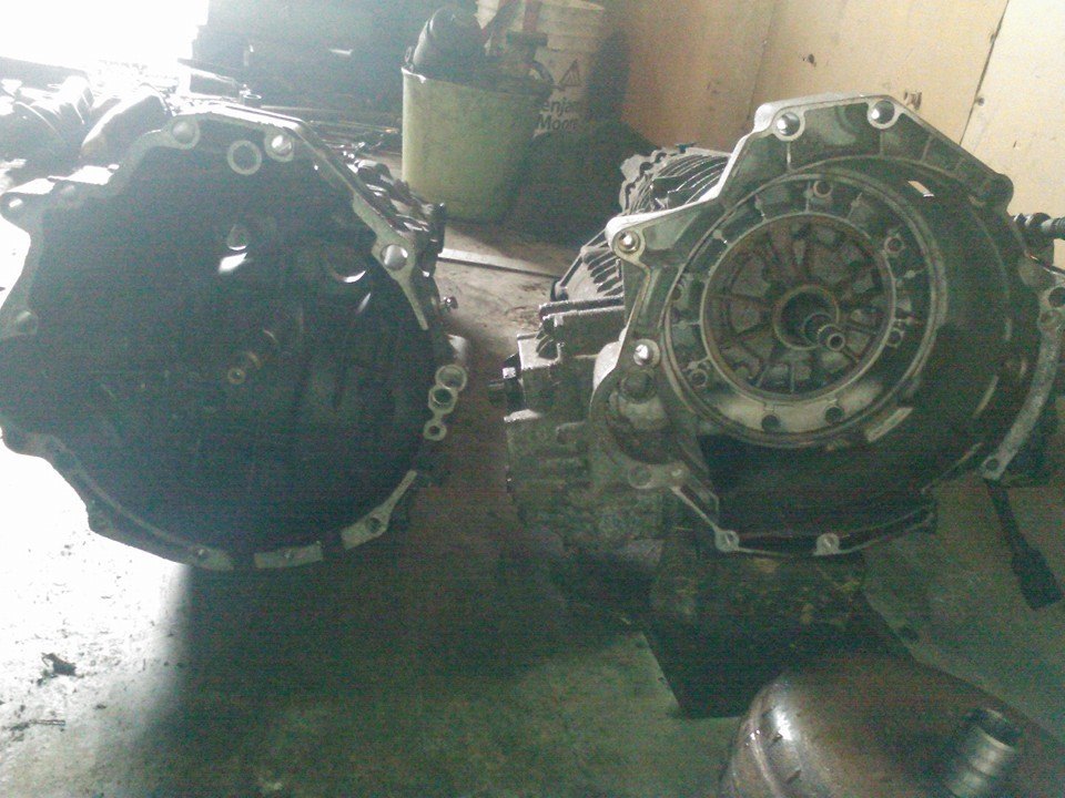

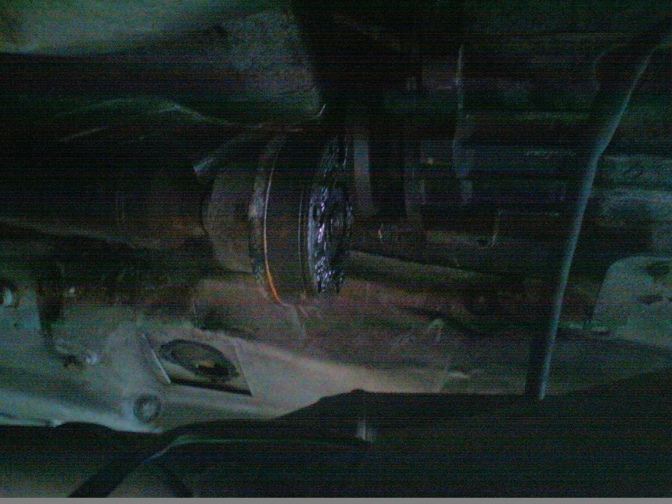

01e length
Attachment 23699
auto length
Attachment 23700
driveline
Attachment 23701
above was a EUC, have to get one with a 4.11 ratio to match trans
Attachment 23702
Attachment 23703
Attachment 23704
Attachment 23705
Attachment 23706
Attachment 23707

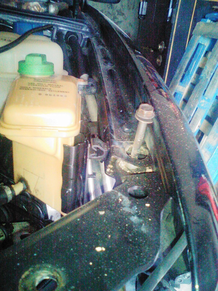

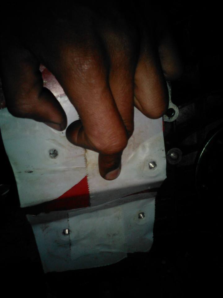

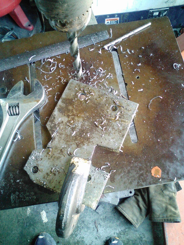

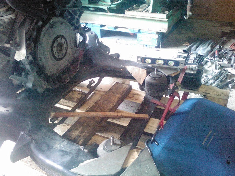

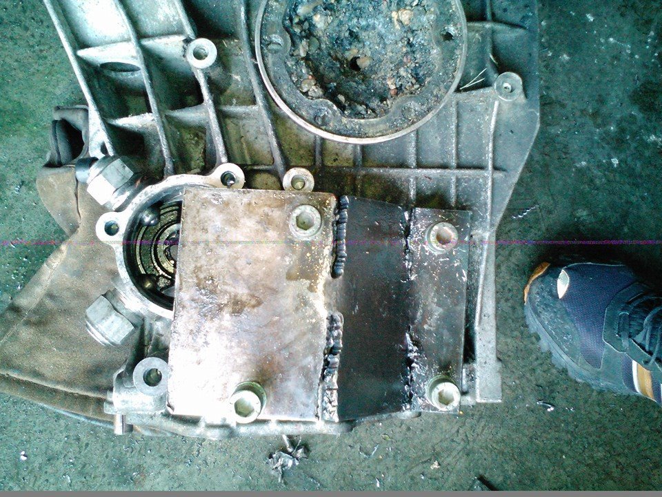

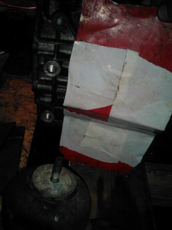

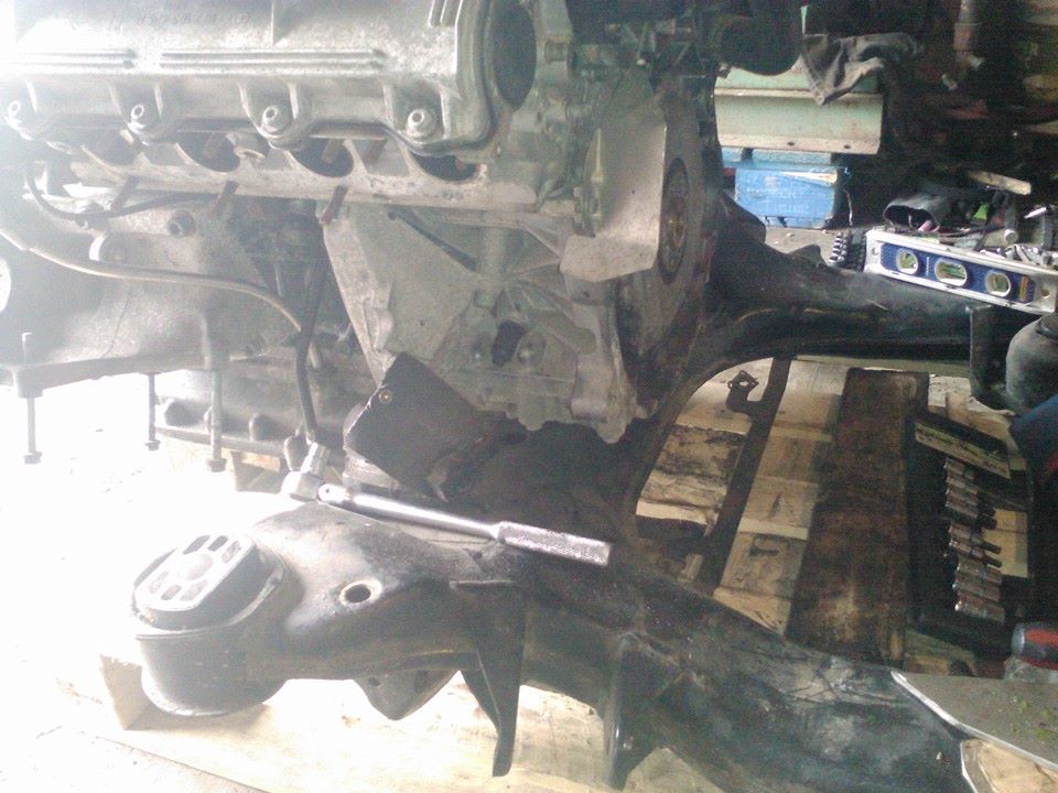

trans mount
Attachment 23679

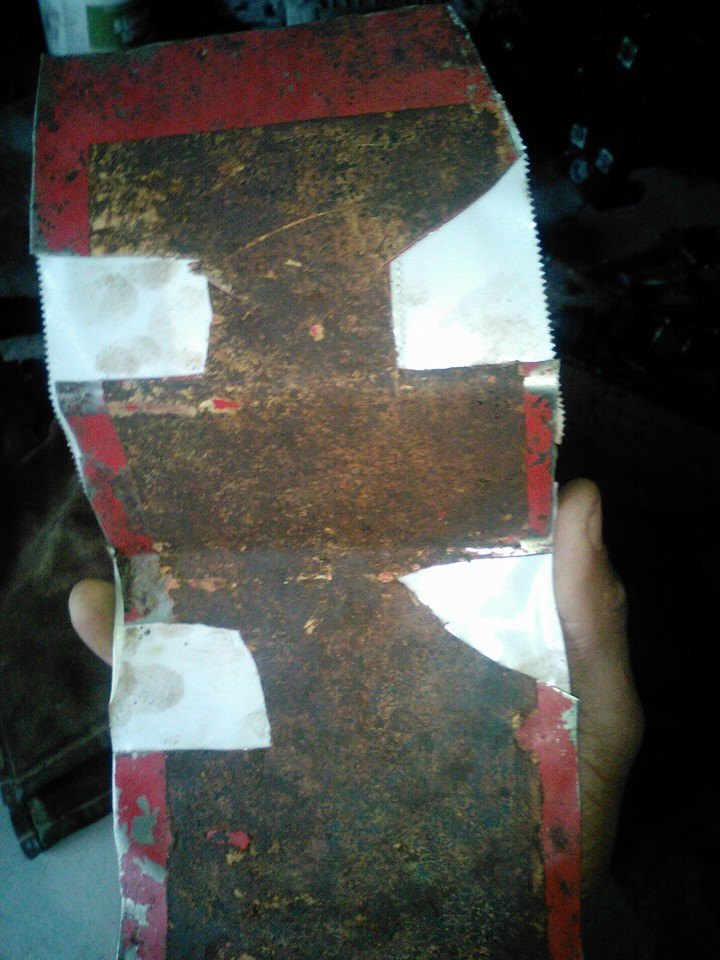

Template. I don't any blind punch screws
Attachment 23680
Attachment 23681
Attachment 23682
Attachment 23683
Attachment 23684
clutch
these are cheap on ebay
I have to get a custom button flywheel made
and buy some disc with audi's spline(tilton)
all that is still cheaper then what ive found for the price of the flywheel to fit the 8-bolt 4.2l 40v crank and a clutch.
Attachment 23685
Attachment 23686
Attachment 23687
Attachment 23688

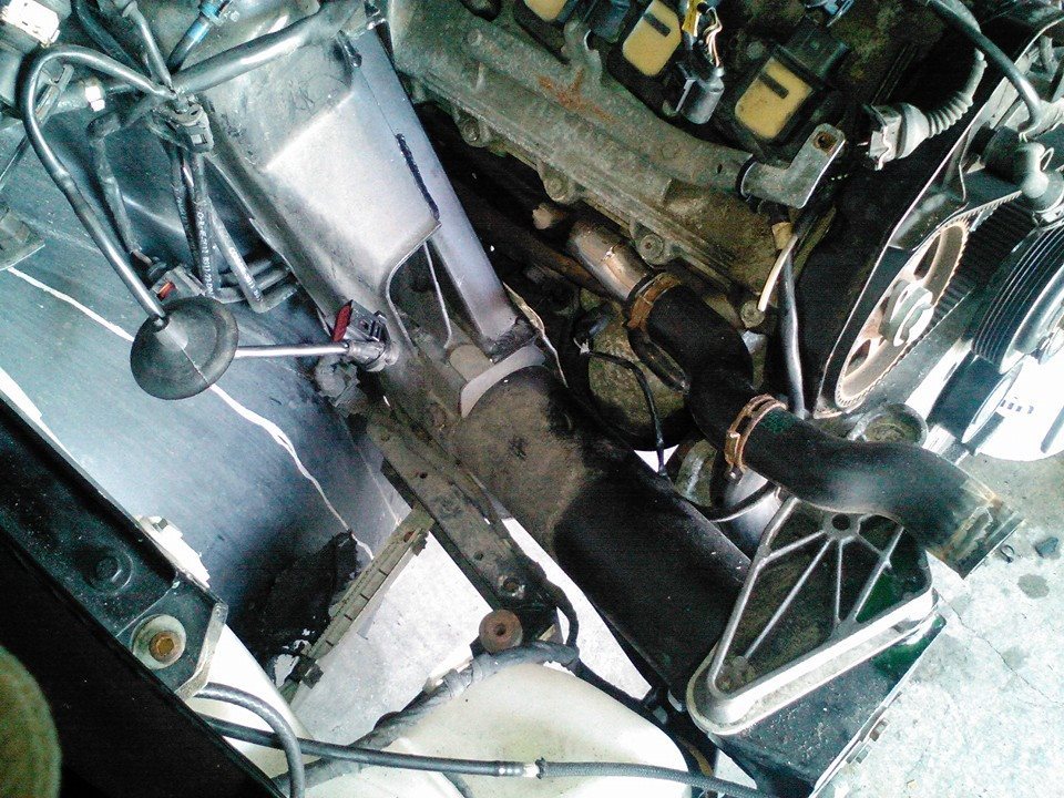

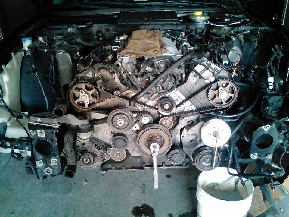

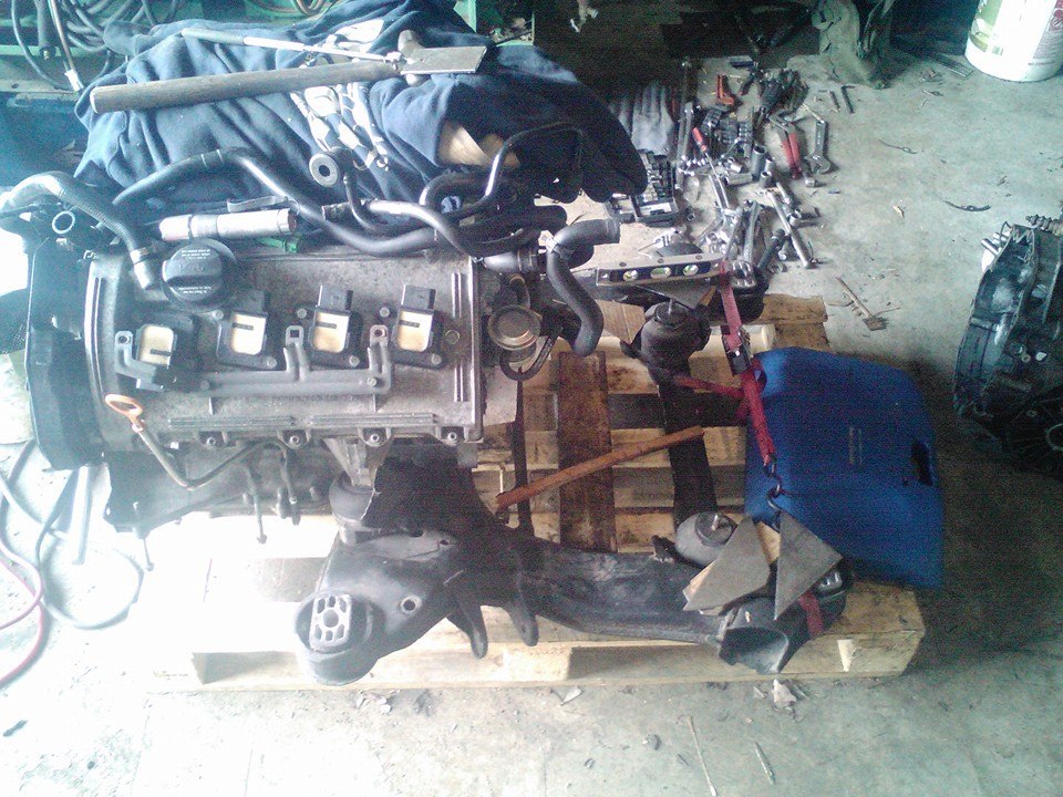

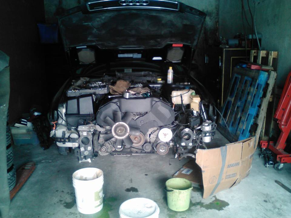

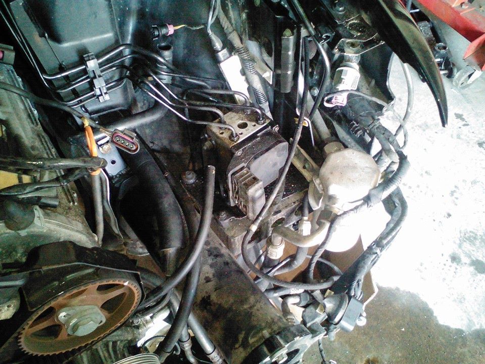

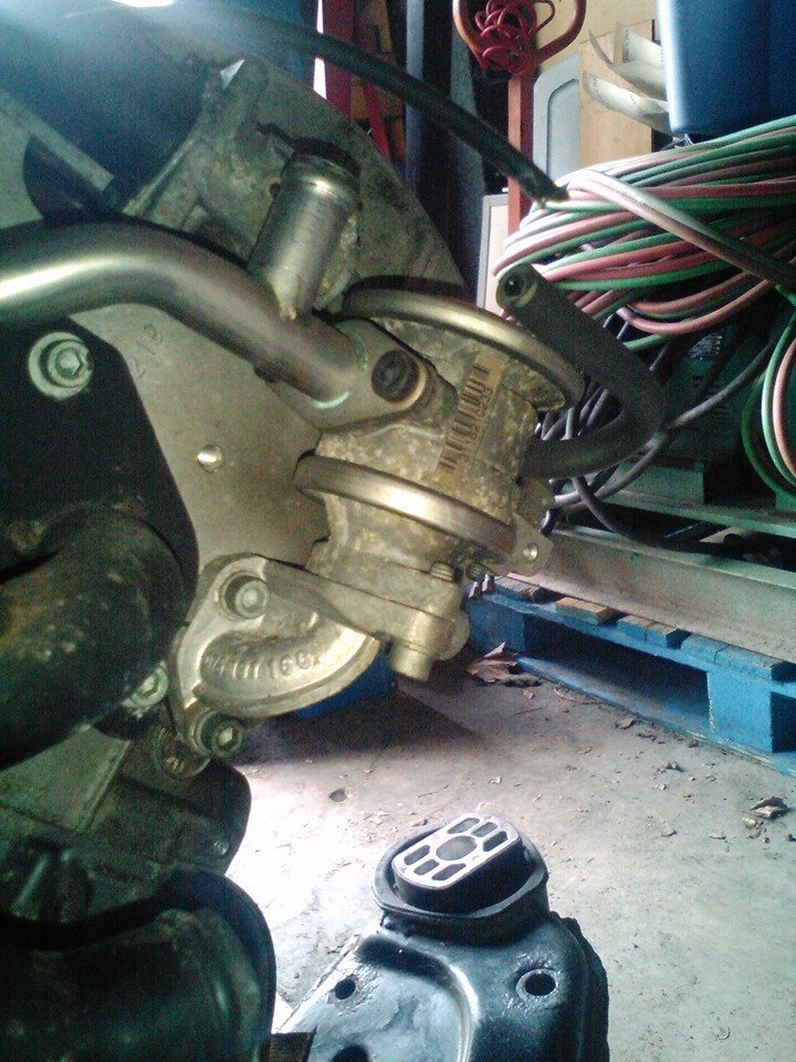

finally enginemoving oil cooler and it'll be air cooled
Attachment 23662
Attachment 23663
Attachment 23664
screw was welded to remove a stripped screw
Attachment 23665
Attachment 23666
Attachment 23667
Attachment 23668
Attachment 23669
Attachment 23670
This is scary
Attachment 23671
Attachment 23672
Attachment 23673
Attachment 23674
Attachment 23675
Attachment 23676
Attachment 23677
Attachment 23678

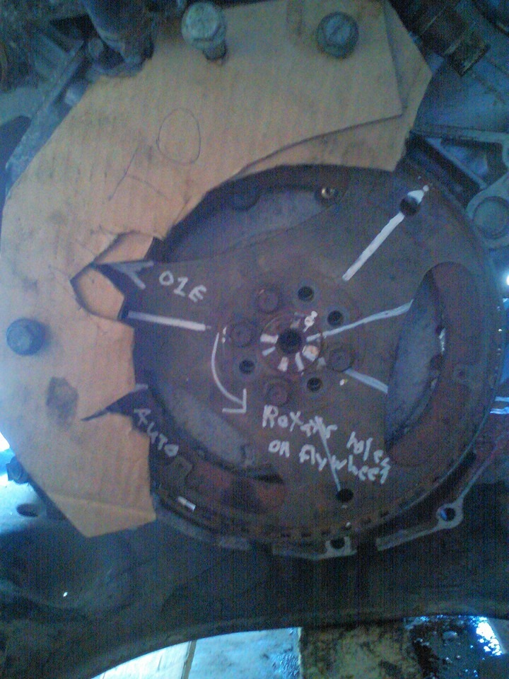

3 Attachment(s)
What project are you working on?
PS
I have some more pics.... The biggest hurdle I think.... CPS in different places on the two transmissions. Soooooooo if you wanna keep motronic then... Well y'all know the rest.
Attachment 23602
Have to adjust the triggers because.........
Attachment 23603
Attachment 23604

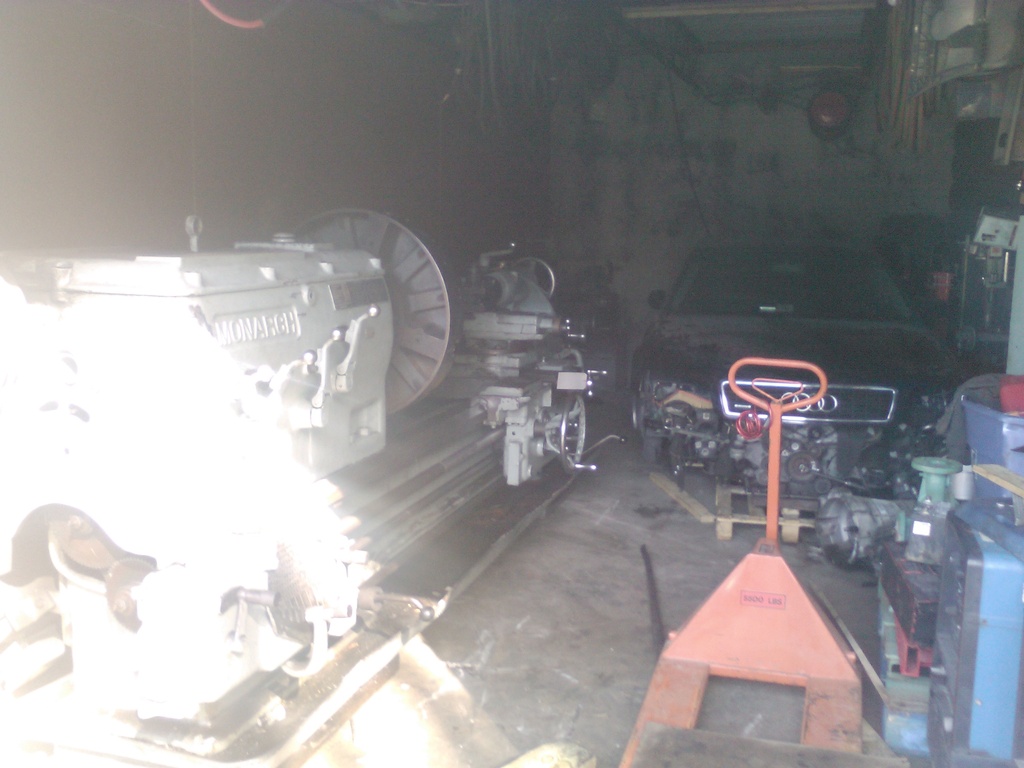

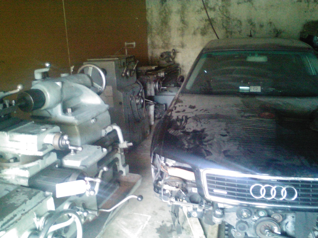

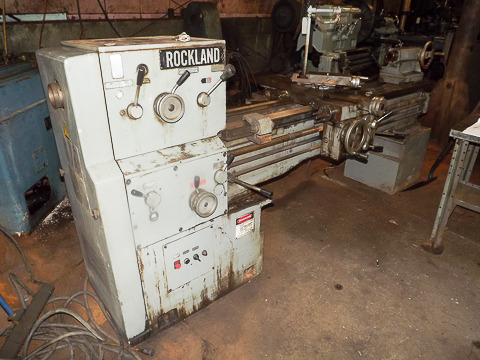

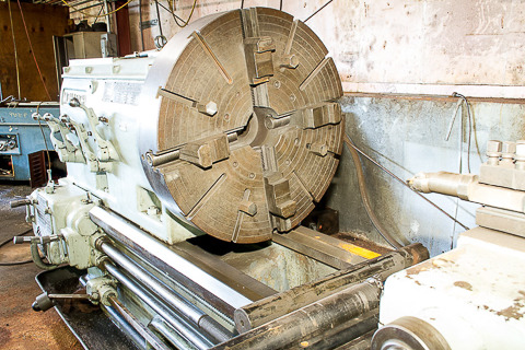

Ok finally got my lathe( lol lathes.... You know how when you hear a new word then all of a sudden you hear it often. Well I could not for the life of me find a big enough lathe for my custom flywheel at a good price. I was being cheap, then kept finding these things aren't cheap. So I kept upping my price still to no avail. Until last month found one on acceleratedbuysell.com. A 24N model monarch :-) 36" swing for a great price $1700 bought it and while up there also acquired a Rockland 19” for $350 smh and while buying tooling for them was sold a craftsman 6" for $40!! Lol yeah crazy, couldn't find one now I got too many.)
So now I can start back with this project. Well not exactly gotta convert to single phase or get 3 phase power. Surplus gov generator still run high so I'm thinking the former. But we'll see.
PS I figured a way to adjust the CPS correctly while learning about turning and milling. Use a dividing head. That will give me exact 360 increments.

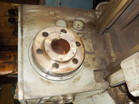

Monarch 36.5" swing smh
Attachment 23222
Attachment 23223

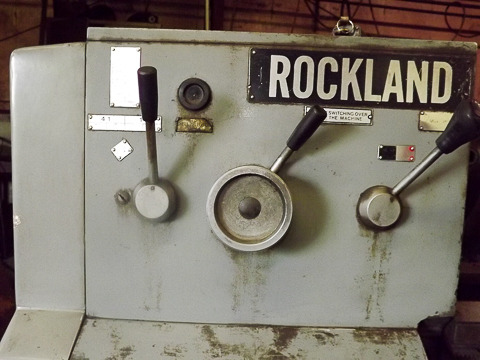

Rockland 19"
Attachment 23233
