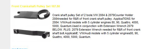

Jeff-AudiUSAParts Aug 6, 2014 05:03 PM
1 Attachment(s)
Here are the factory tools for when the engine is installed in the car. The one tool would go into the pulley, the U shaped portion goes around the snub mount to lock the crank into a fixed position. The other one with the socket on it is meant to be an extension that allows you to use a long handled 1/2 inch breaker bar to tighten that beast of a bolt down. I can't remember the torque it's supposed to be, something like 250 ft pds?? But you can't use a torque wrench with that extension tool since that throws off the actual value. If you can find the one tool online that's the way to go. Then you can bolt that down later on if you like. Engine out you could torque it down with a socket and I'm sure "not cheap" torque wrench, special tool 2x4 in place as well.
Attachment 24389

Jeff-AudiUSAParts Aug 7, 2014 02:22 PM
I remember doing this job on 5000, 5000 turbos and 4000q's and not having a lot of room to get a torque wrench and socket on that large bolt. That is where the narrow depth and built in socket of the special tool came in handy. Then putting the breaker bar on the end and cranking it down. I feel like a hack when I say I, nor could anybody else in the shop I worked at, ever use a torque wrench with the engine installed in the car. Maybe your URQ has a bit more room? When you break those loose by hand, after doing a few of them you get a good idea of how tight to get that bolt.
Creative way to hold the crank. I wouldn't reuse those bolts. I would snug them up to the wrench as much as possible, and I'd make a wedge out of wood to put I'd say 60-70% of the load on the wood. And put that between the crank and block. The more support the better. Once that bolt is off, the nose of the crank is not tapered. It might be snug, but should wiggle off the crank straight out.
So if you have access to a torque wrench that is capable of high values, if you don't have room with the engine in the car, torque it on before it gets installed and before your oil pan goes on.
