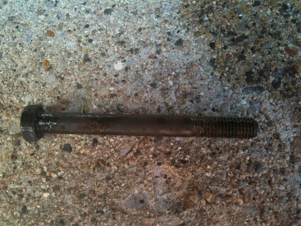

Hammer away at the punch until that pinch bolt is your beyotch and she pops out of the spindle and onto the floor.
Success!
Attachment 32047

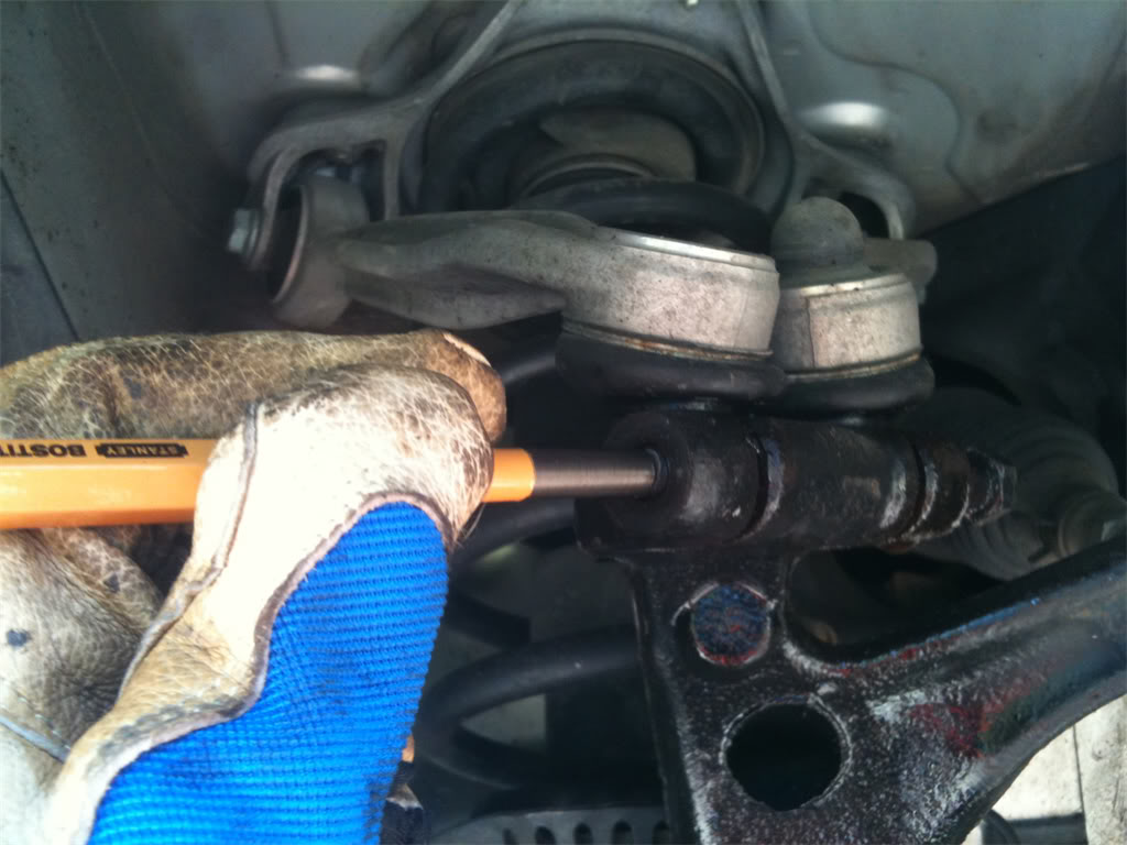

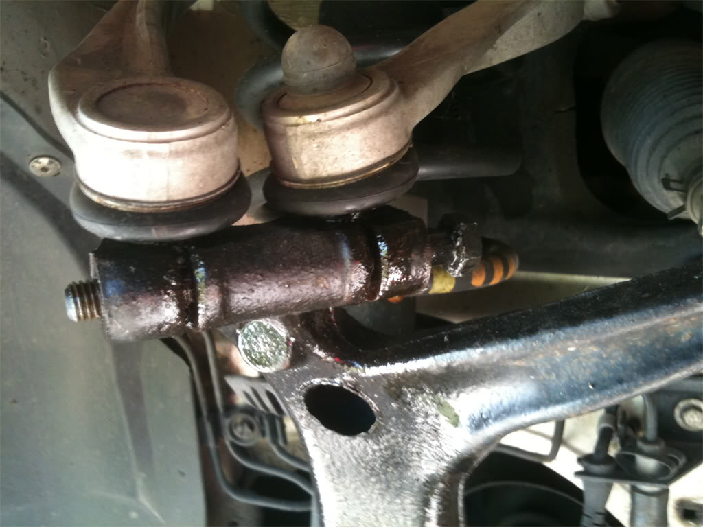

Step 22. Now that the pinch bolt is out, we can remove the control arm nipples from the spindle. You can either use the fancy tool from the Front End Service Kit that I showed you in part 2, or you can use the short screwdriver & hammer method and tap them out this way. As a review, here is the pic from the tie rod end removal showing the tool I used.
Attachment 32048

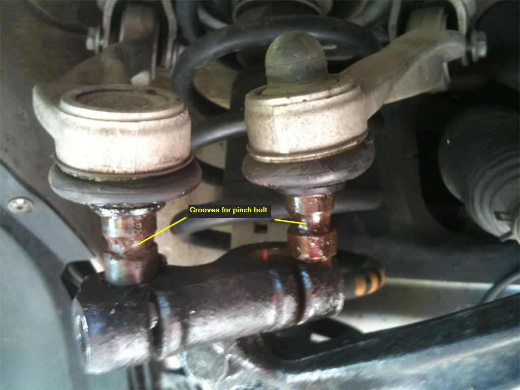

Here's a pic or the upper control arms completely freed from the spindle. Notice the grooves in the pic. When you install the new control arms, these grooves must line up with where the pinch bolt is going to pass through them in the spindle, otherwise the pinch bolt won't be able to travel through the entire spindle. So when you pound the nipples back into the spindle, make sure to get them down far enough so that the grooves are lined up in the hole.
Attachment 32049

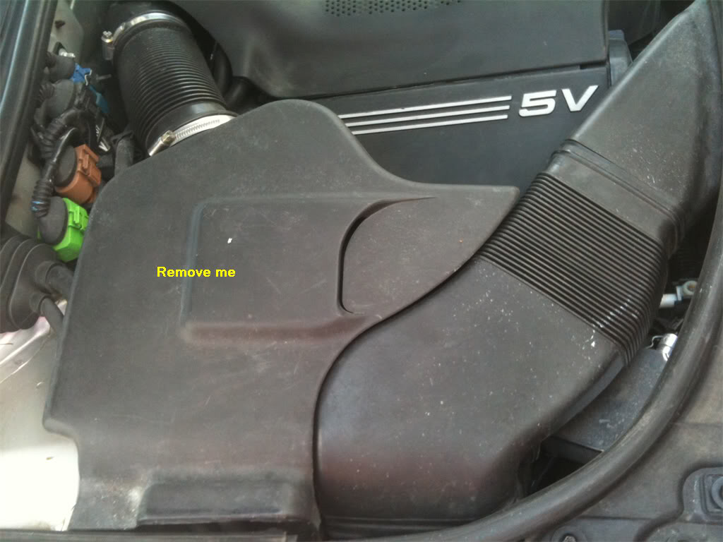

Step 24. Open your hood and look for three 16mm bolts that hold the shock tower to the car. On the passenger side, if you have the 2.8L V6 engine like I do, you'll have to remove this cover...
Attachment 32050

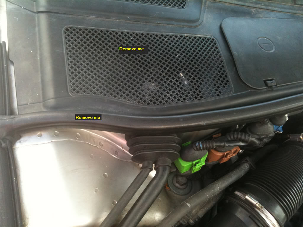

and this strip of rubber and cover.
Attachment 32051

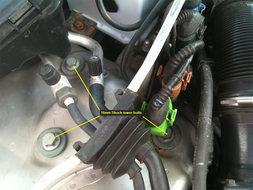

Now, we see our three bolts.
Attachment 32052
That little green module is in the way of one of the bolts. No problem, you can just wiggle it forward to free it from the two little plastic arms holding it in place. When free, move it to the side.
Attachment 32053
Now you may proceed to remove the bolts using a 16mm socket, or a 16mm box end wrench. Since I'm lazy by nature, instead of removing the cabin air filter cover to get at the bolt closest to the firewall, I opted to use a 16mm box end wrench on it instead of a socket.

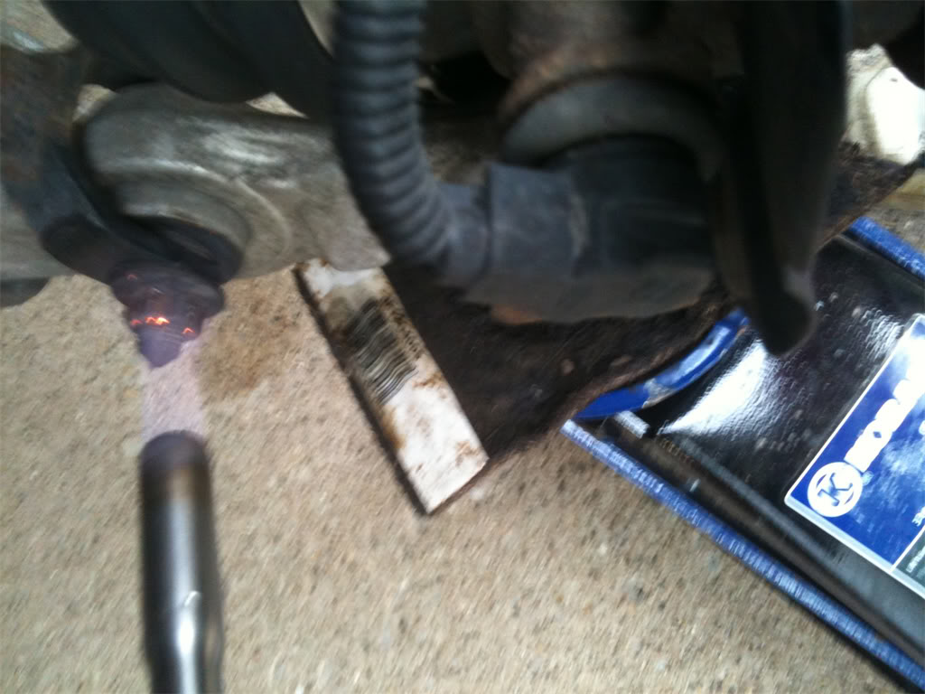

Step 25. One last thing to do before you can remove the entire shock tower. You need to remove the strut bolt from the lower front control arm.
The 18mm nut on mine looked pretty rusty, so I hit it with some mapp gas heat before I attempted to remove it.
Attachment 32054

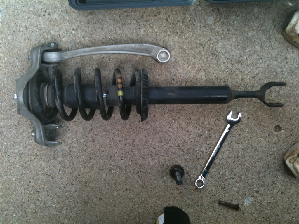

Step 26. Remove the entire shock tower and place it on the ground. From here, proceed to unbolt the remaining upper control arm.
Attachment 32056

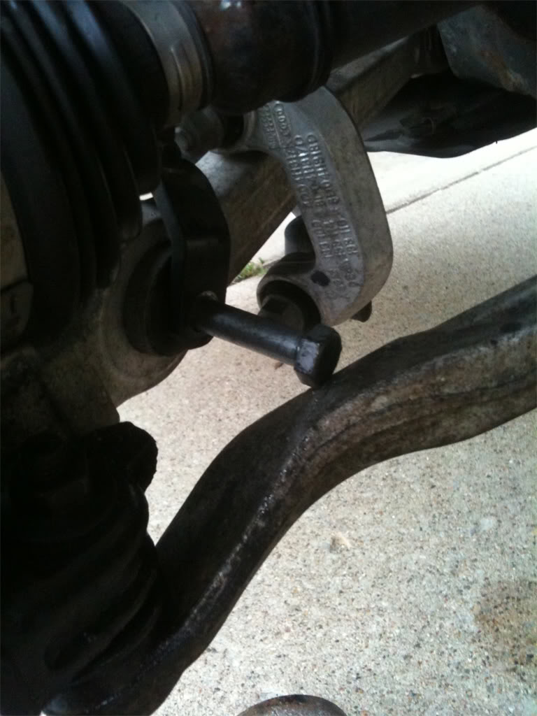

On the passenger side, I had no trouble, since the bolt head was pointing toward the front of the vehicle. But on the driver's side, the bolt head was point toward the rear of the vehicle, which means that the bolt ran into the lower rear control arm and before it was out of the lower front control arm. Here's a pic of this dilemma.
Attachment 32057
In my case, I had to wait to remove this bolt until I dropped the lower rear control arm out of the spindle. I won't spend time on that in this thread, as the lower control arms will be dealt with in part 4. Maybe I was just unlucky and your bolt head will point toward the front of the vehicle on both sides.
