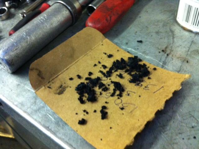

My 2006 A3 2.0 with 90k miles (bought new) has been sputtering for a while when cold and the engine light would come on every so often. Also mileage was down at least 3 mpg.
Computer always said random cylinder or #4 cylinder miss-fire. Dealer said to try some fuel additive – which I did for 3 weeks. Sill having same problems.
Decided to have my mechanic, a very good guy, change out the #4 injector. This is a big job that requires intake manifold removal. While he was there he saw the back of the intake valves (all 8) were very cruddy. He cleaned them up – another big job to scrape out and remove the stuff as we did not want it getting into the cat converter. One cylinder had the intake valves open so he covered the entrance with a gasket of some type while he scraped.
Attached is an image of what he got out. I’m not sure this is all of it. He took some pictures of the valves and I’ll try to add them later. As I said, they were crudded up pretty good.
I picked it up and it runs great. No sputtering when cold and acceleration seems noticeably better. Also, interestingly, the engine is quieter. I swear the normal growl of the 2.0 had gotten quite a bit louder and now it’s quiet again.
A few notes. This was a ~6 hour ~$680 job including the $100 injector. He also replaced the temperature sensor while he was in there, so it could have been that or the replaced injector that was the problem – but I’d bet it was the valves.
