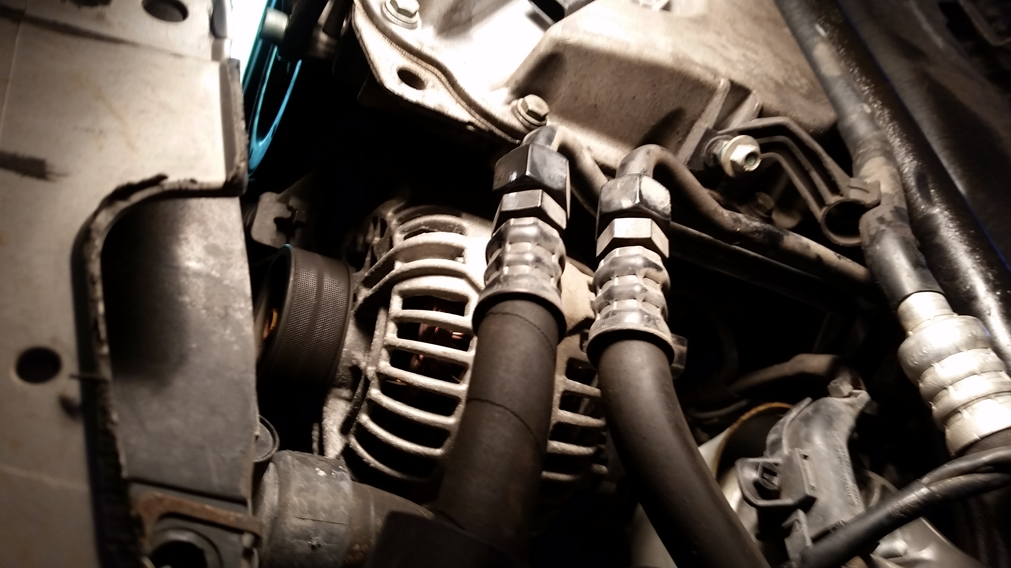

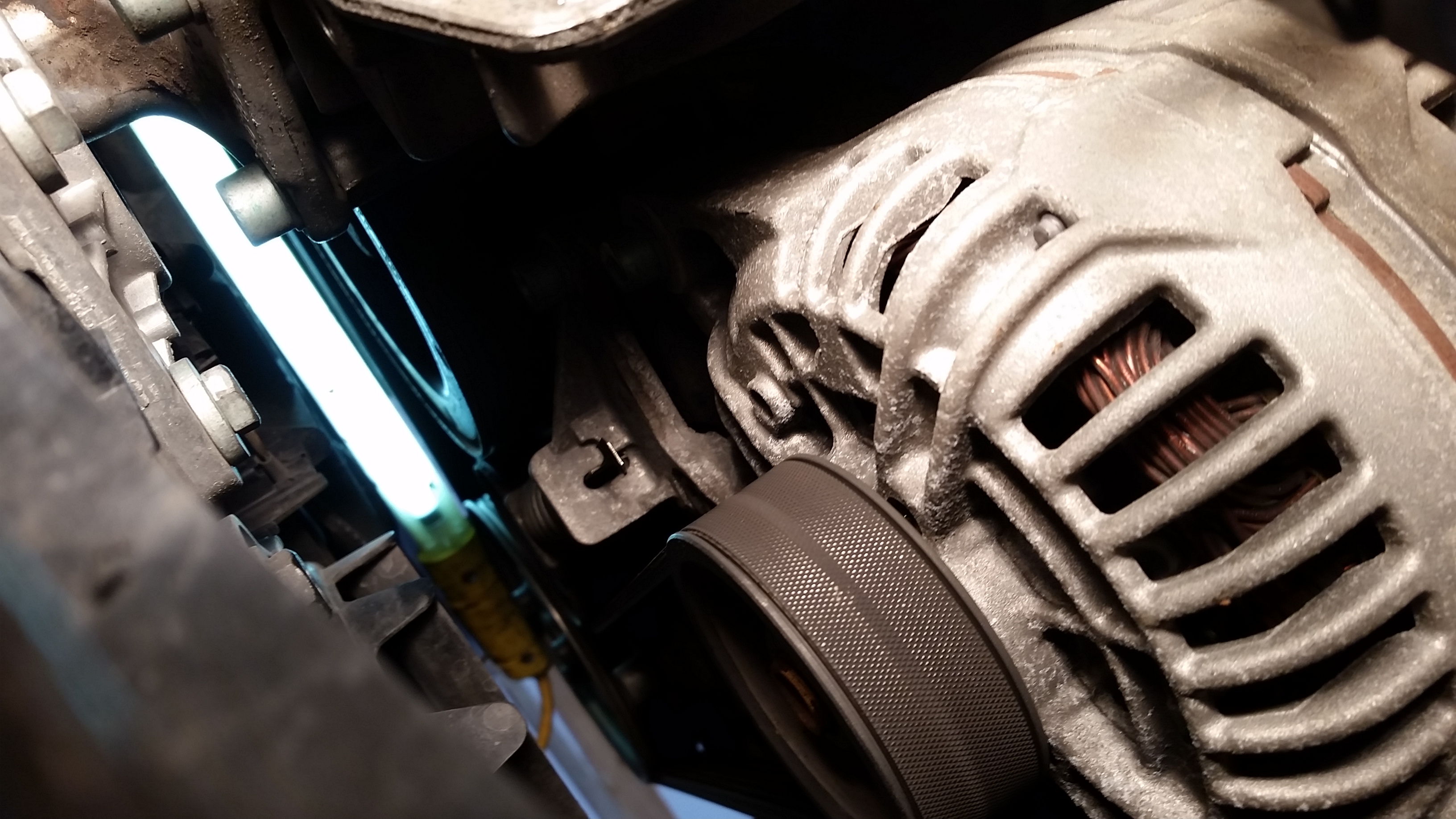

I cannot figure out the belt tensioner on this thing. There is no cast square visible to use a wrench on to loosen the belt.
Also, once I have the belt off, can't see how to get the alternator out through the small opening between the frame and the oil pan.
Anyone have any tips for getting the belt off and alternator out?
I have added pics of what I see of the belt tensioner. Just can't see how to operate it. there is a flat piece of metal sticking out the bottom, and it is sharp. not sure of there used to be something else attached to it?
