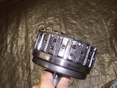

Default ZF trouble
I'm just finishing my rebuild, here's a photo of broken part off my trans. 259.00 from D&E automotive.
