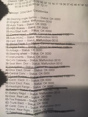

I need help badly. My MMI system died and show the normal symptoms of powering up for five seconds and turns off. I put the fiber optic loop on
1. Bose Amp
2. Telephone box (under passenger seat)
3. Navigation (next to bose amp)
What am I missing???? Here are the diagnostics. Sorry about the bad pic, it was a photo copy from the auto shop.
Is there anything fiber optic behind glove box?
The following highlighted (darkened on photo copy) on pic all read "cannot be reached 1100"
07, oe, oe, 37 47, 56, 77.
I had and correct the typical water on passenger floor so there could have been some water under passenger seat or glove box at some point.
WHat should be my next move?? I am stumped.
1. Bose Amp
