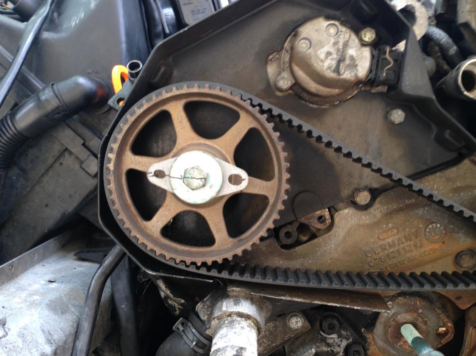

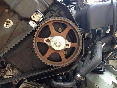

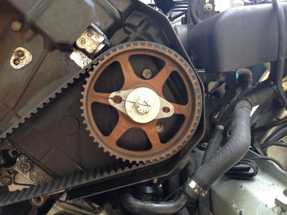

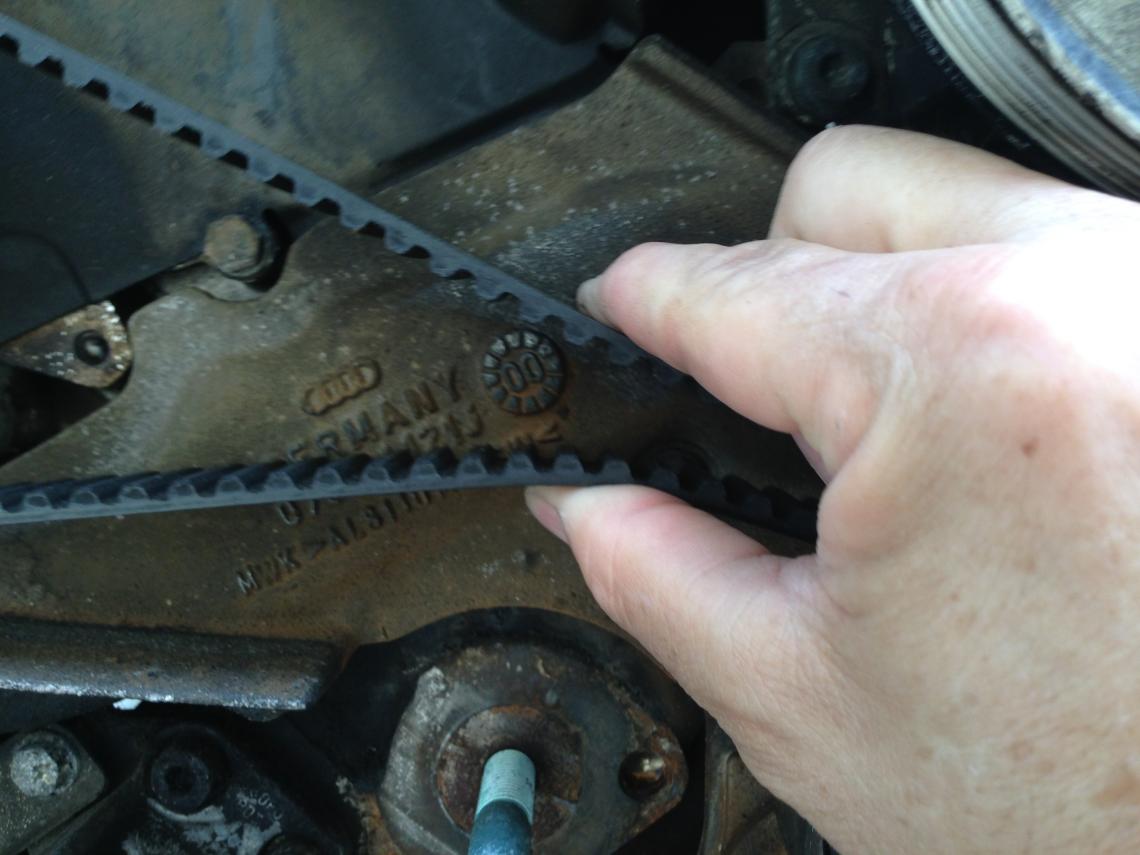

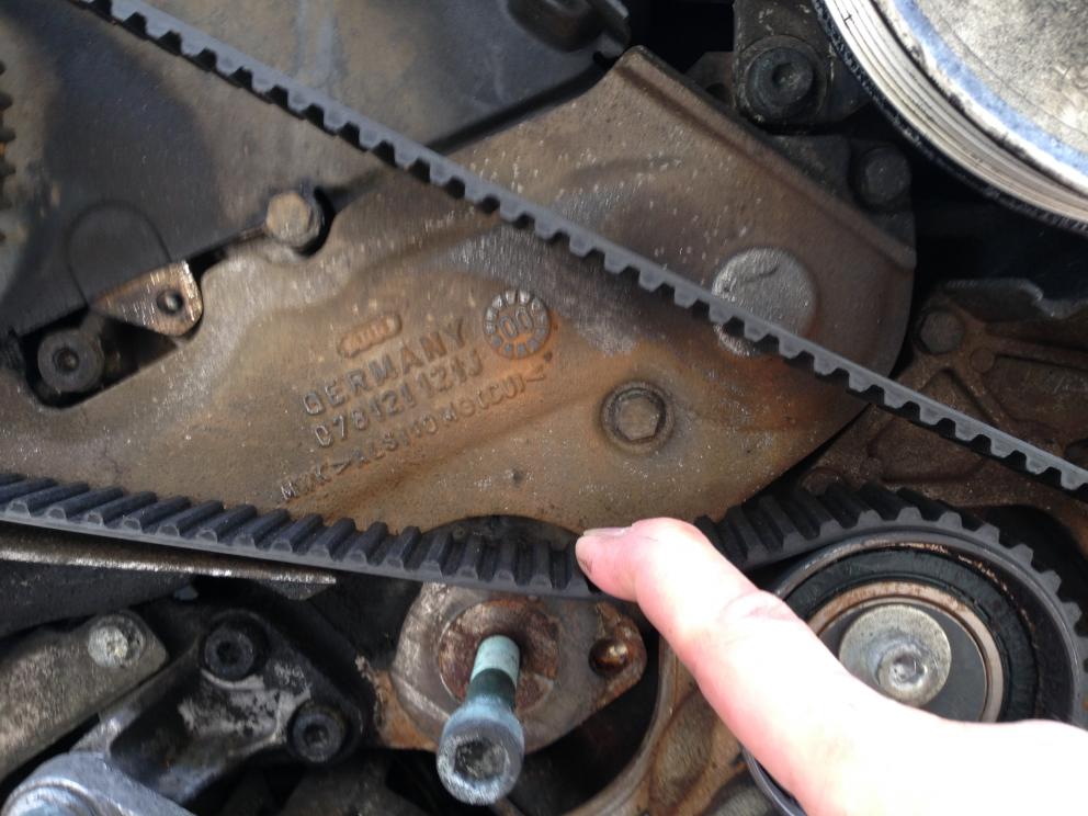

Sorry. I asked a general question in the new members area and it was about to turn into a more in depth discussion of my situation. To whit...this post for that discussion. The first was titled motor. I have taken some pictures to help illustrate but I am not sure how to go about posting them here. I will try and see what happens.

Cool so that worked nicely. It is plain to see from the pictures above that the timing on this car is almost guaranteed to be off from what i have learned in the last couple of days. The cam on the first picture appears to be slightly behind the rotation of the one on the right which based on what pictures of the cam locking tool in place look like means timing must be off. The timing belt is soo loose i could slip it a notch by hand if i wanted to. It was driveable but it was running rough and it had a "blown pulley bearing" like sound coming from the front end and it was leaking coolant.
Wouldn't it be wise actually set the timing properly rather than relying on the current setting to change the belt?
