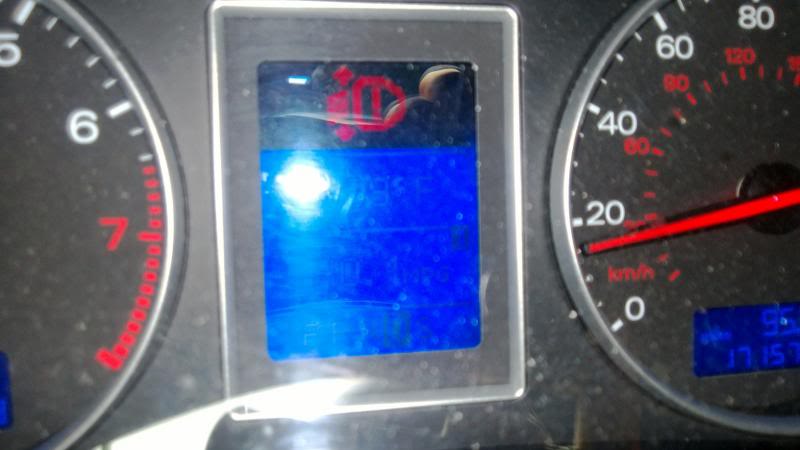

Cant find this warning light symbol anywhere to figure out what it means?

You have a light out somewhere...

no, thats actually a warning for the headlight leveling sensor. its a black box attached to the control arm for your front driver side wheel. the headlight out warning looks like a traditional light bulb with an "X" over it, and its yellow, not red

good call...
