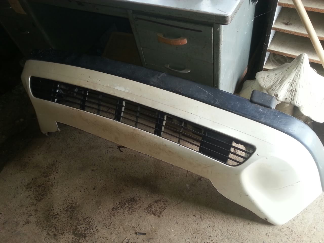

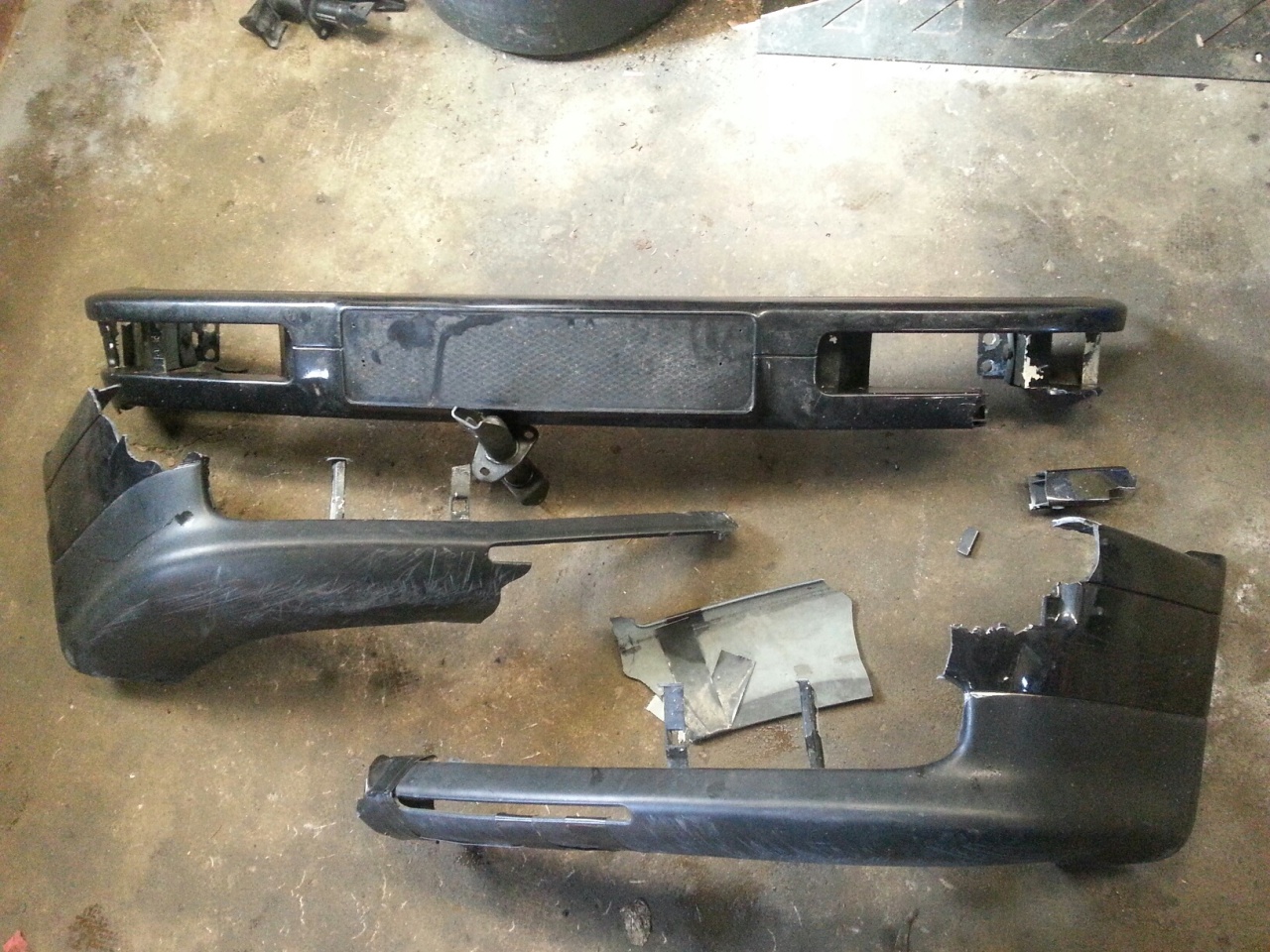

here's what happened to the previous s2 bumper. i'm missing quite a few pieces still

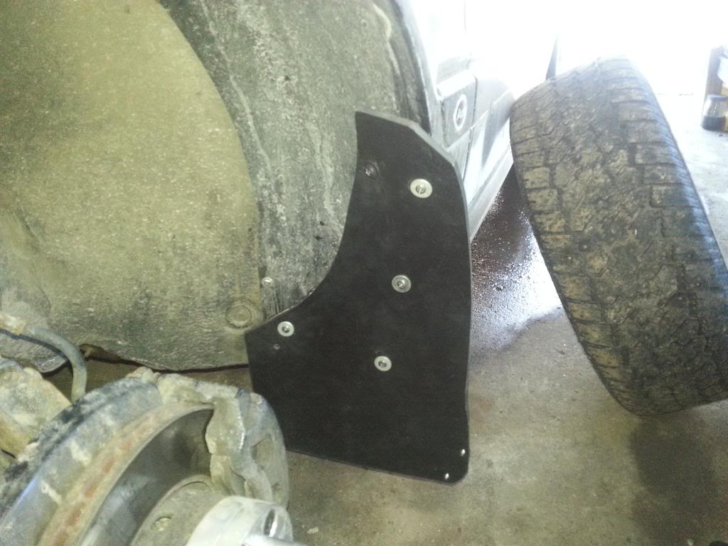

finished making my mudflaps. i think they came out great.

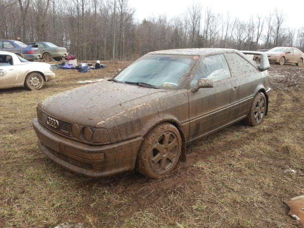

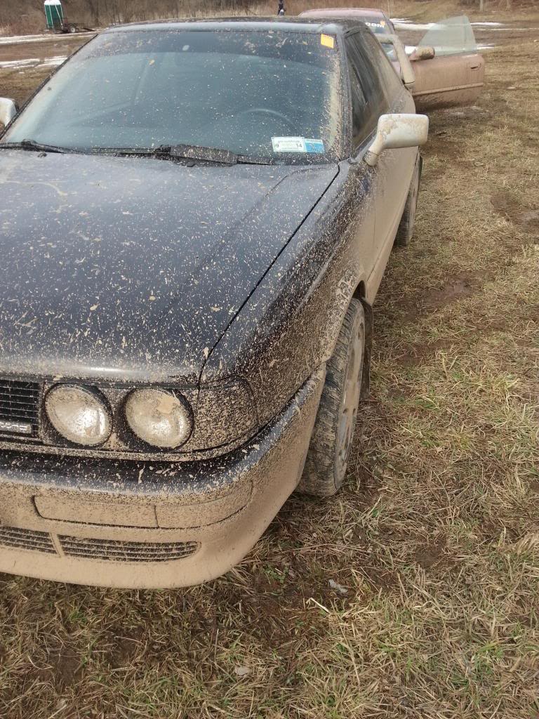

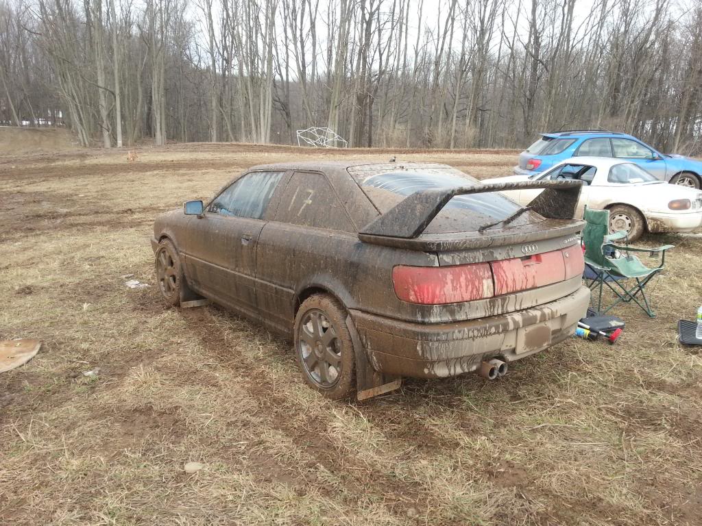

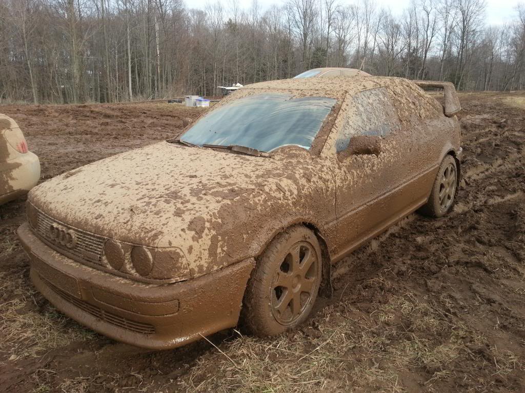

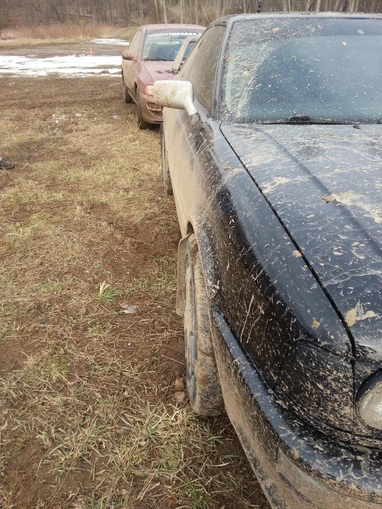

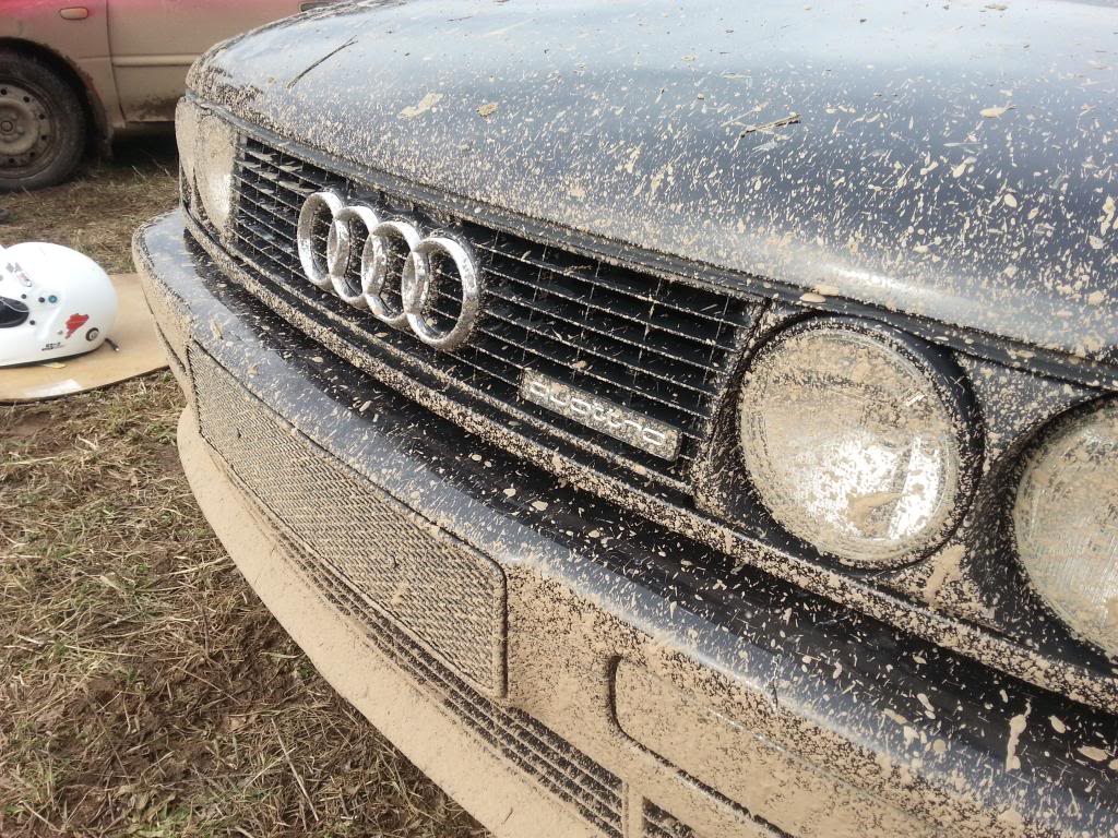

decided to go for a nice little rallyx. it was a ton of fun.
after 4 runs
after 8 runs
after 12 runs
and a picture afterwords by dan, definitely a beautiful photo

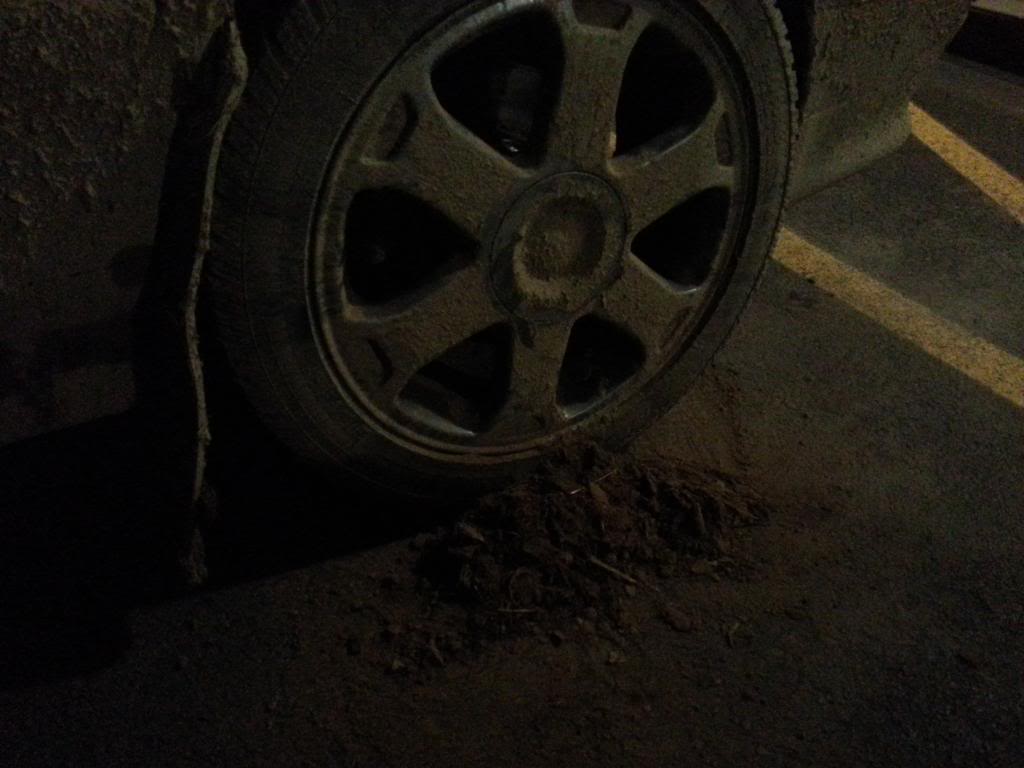

there was so much dirt in the wheels afterwords, causing some major vibrations so i stopped to scrape it out
here's a nice little pile from one wheel

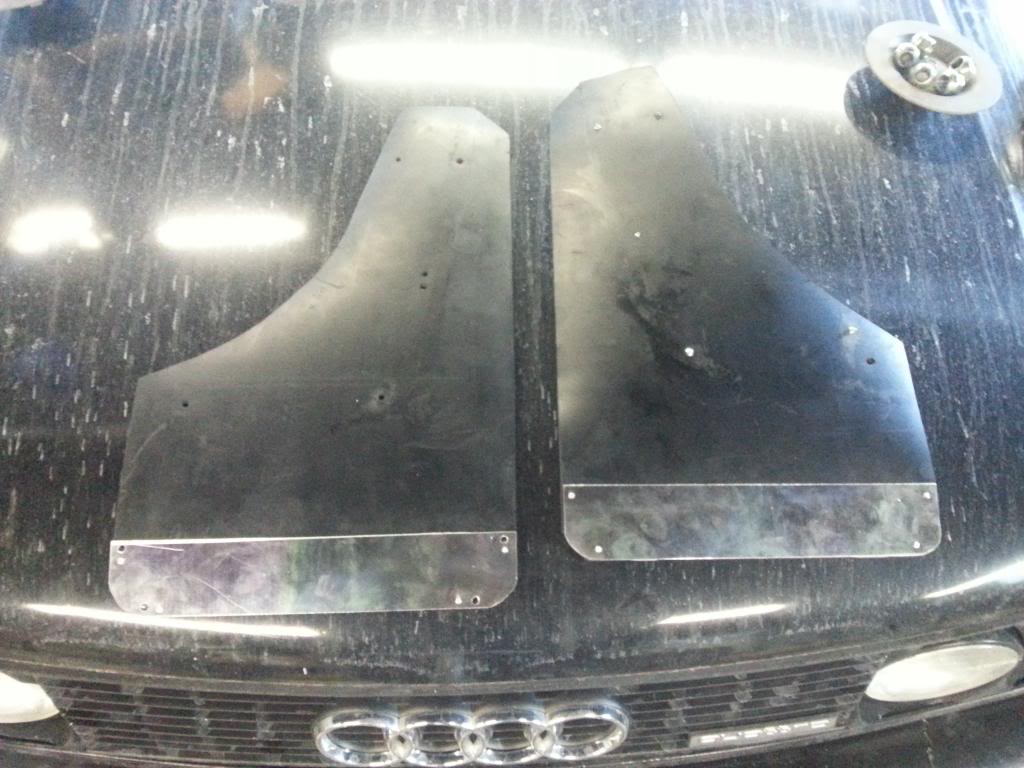

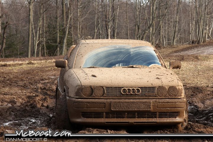

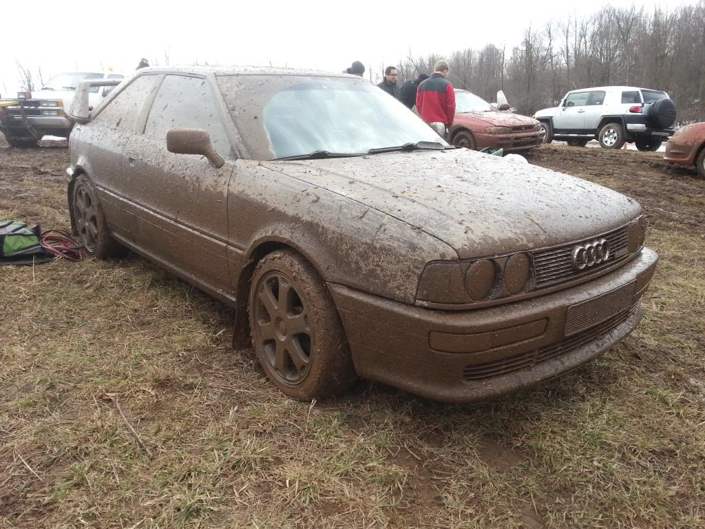

3-10-13
after 4 runs
after 8 runs
after 12 runs

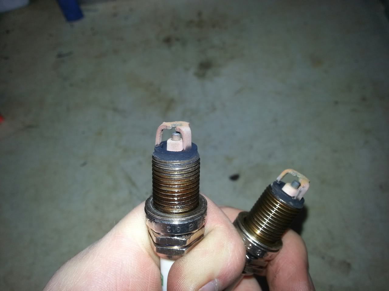

changed the oil with some 5w-40, spark plugs with some autolite coppers, and redid the isv hose to the intake mani with a flexible metal hose (power steering hose crossing in front of radiator)
old sparks look pretty shitty, there's a new O2 sensor in bout 500 miles ago, wondering if the previous one fouled them up, if they were shitty designed sparkplugs (ev3 platinum), or if something else is going on.

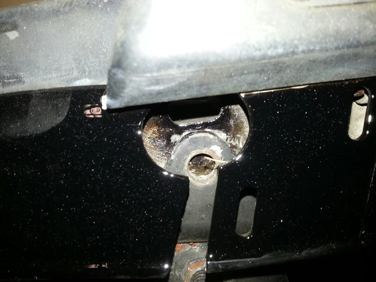

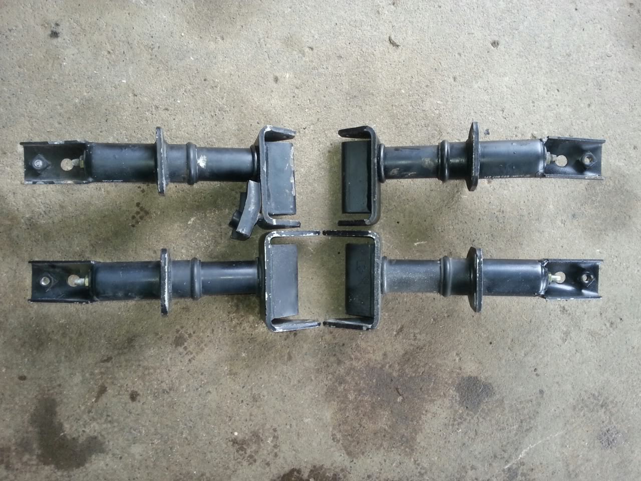

figured out in order to mount the 1 piece b3 usdm bumpers you need the shocks as well.
2 piece bumper shocks on top, 1 piece on bottom. (2 piece has the tow threads attached while the 1 piece has a piece attached to the crossmember.
cq shocks don't have the depth required, plus they are offset from center so they bumper would look off anyways.

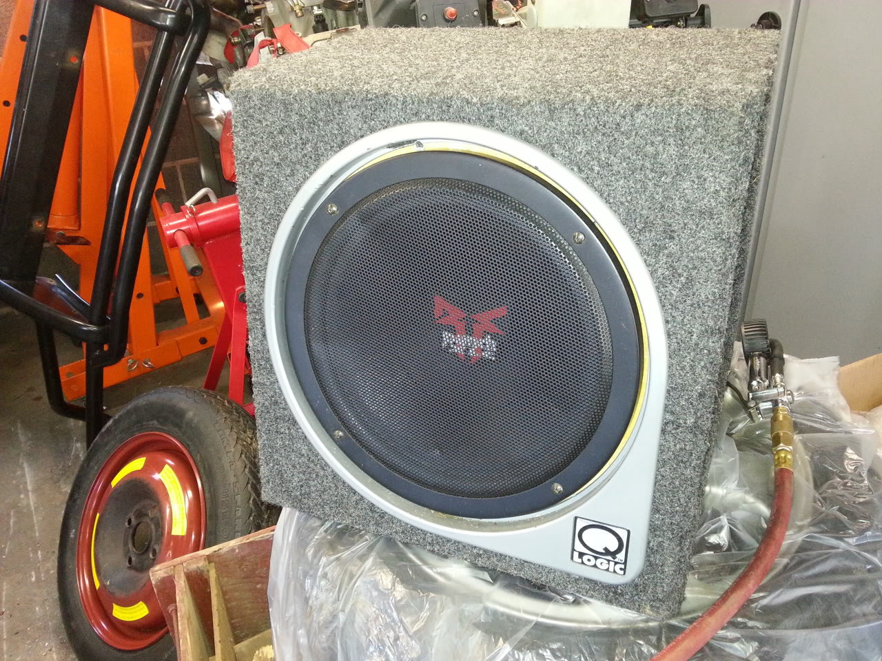

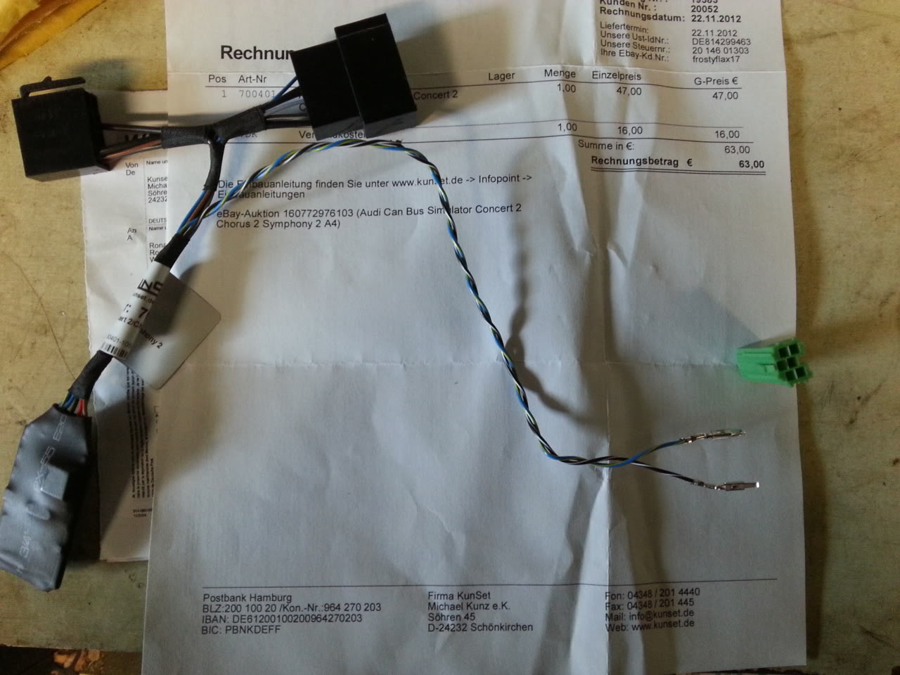

ooo lookie what i bought

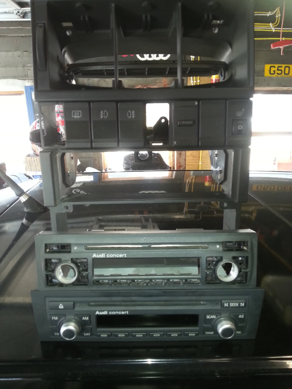

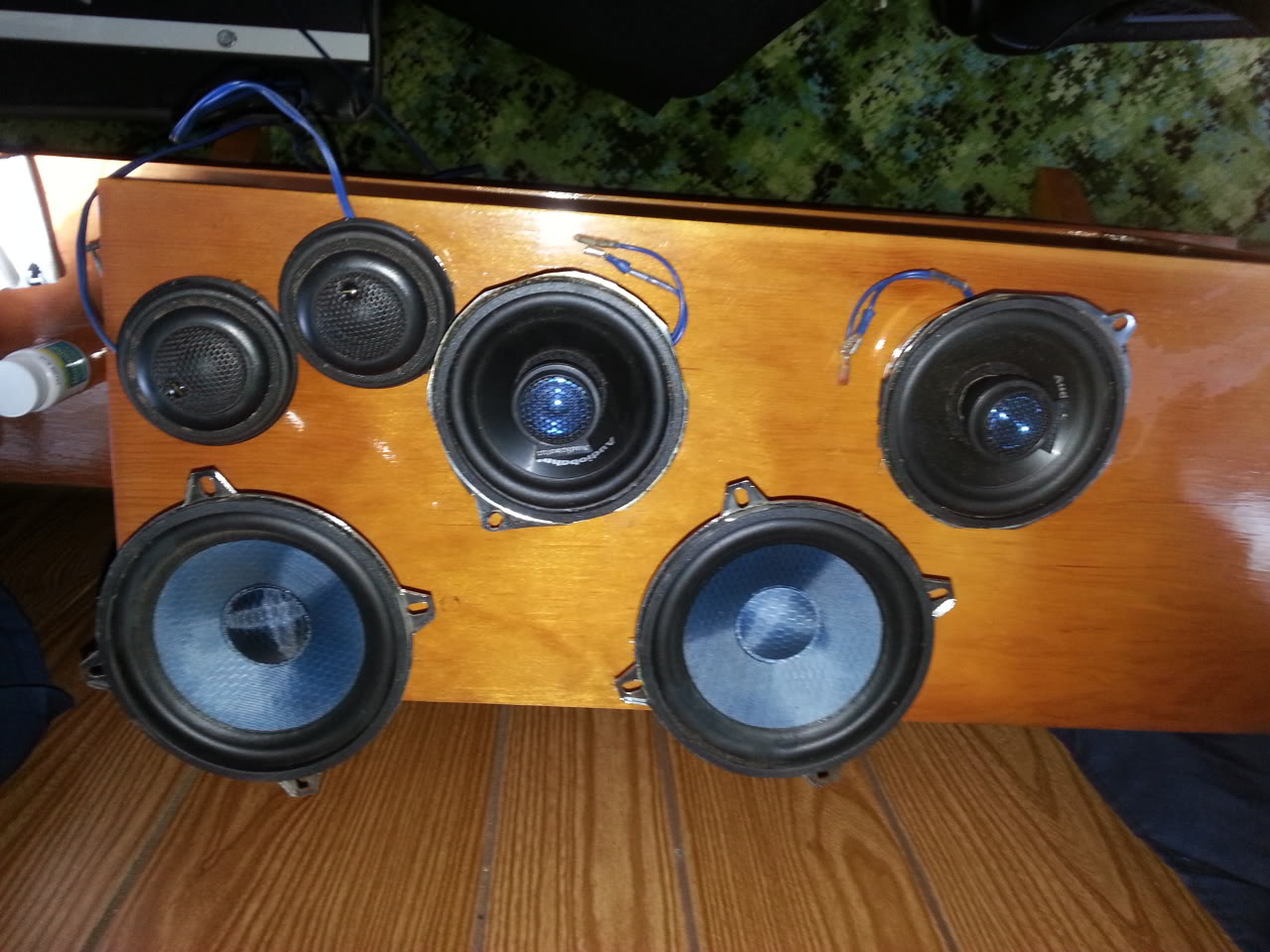

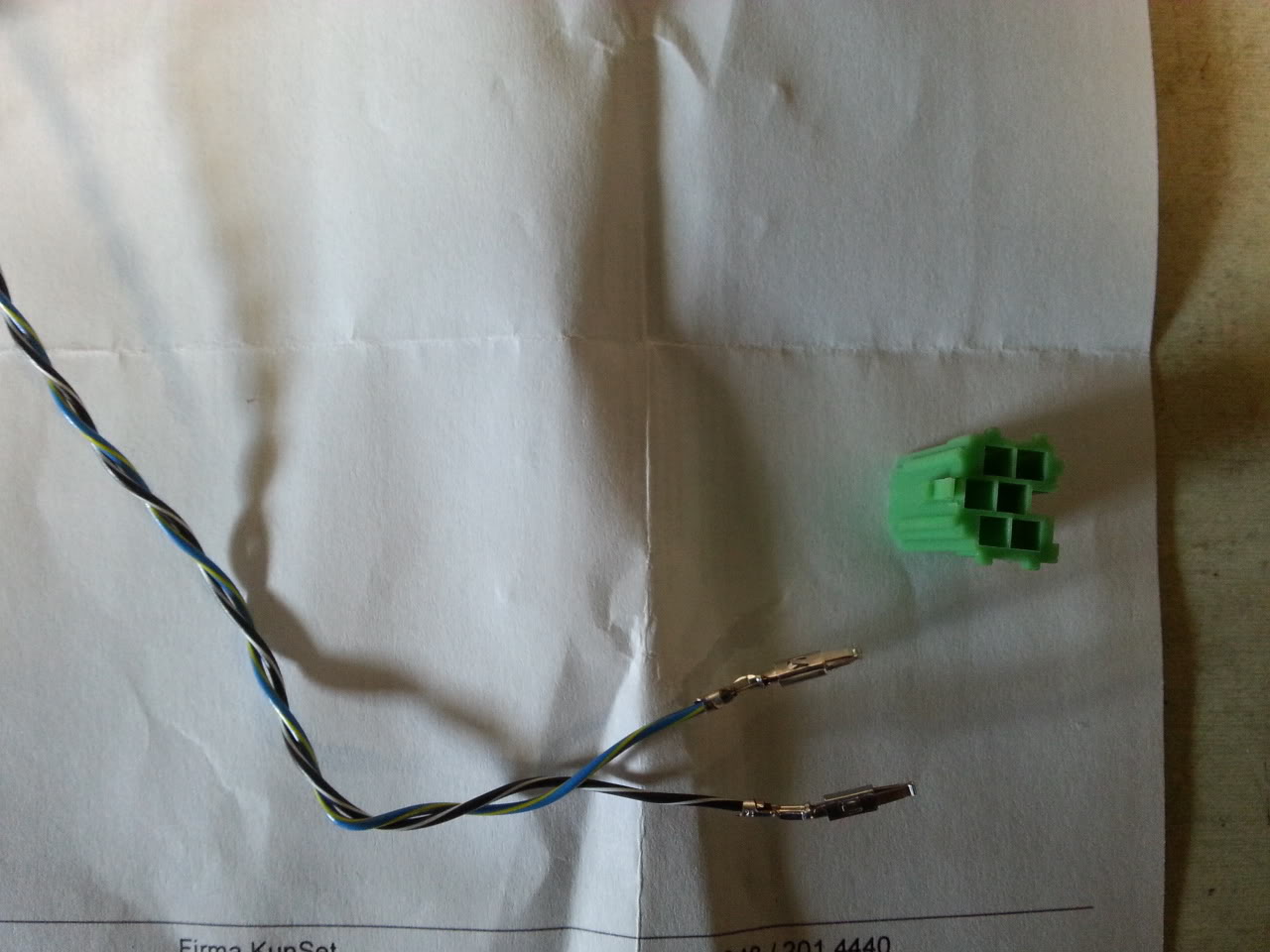

i am starting to work on the radio upgrade.

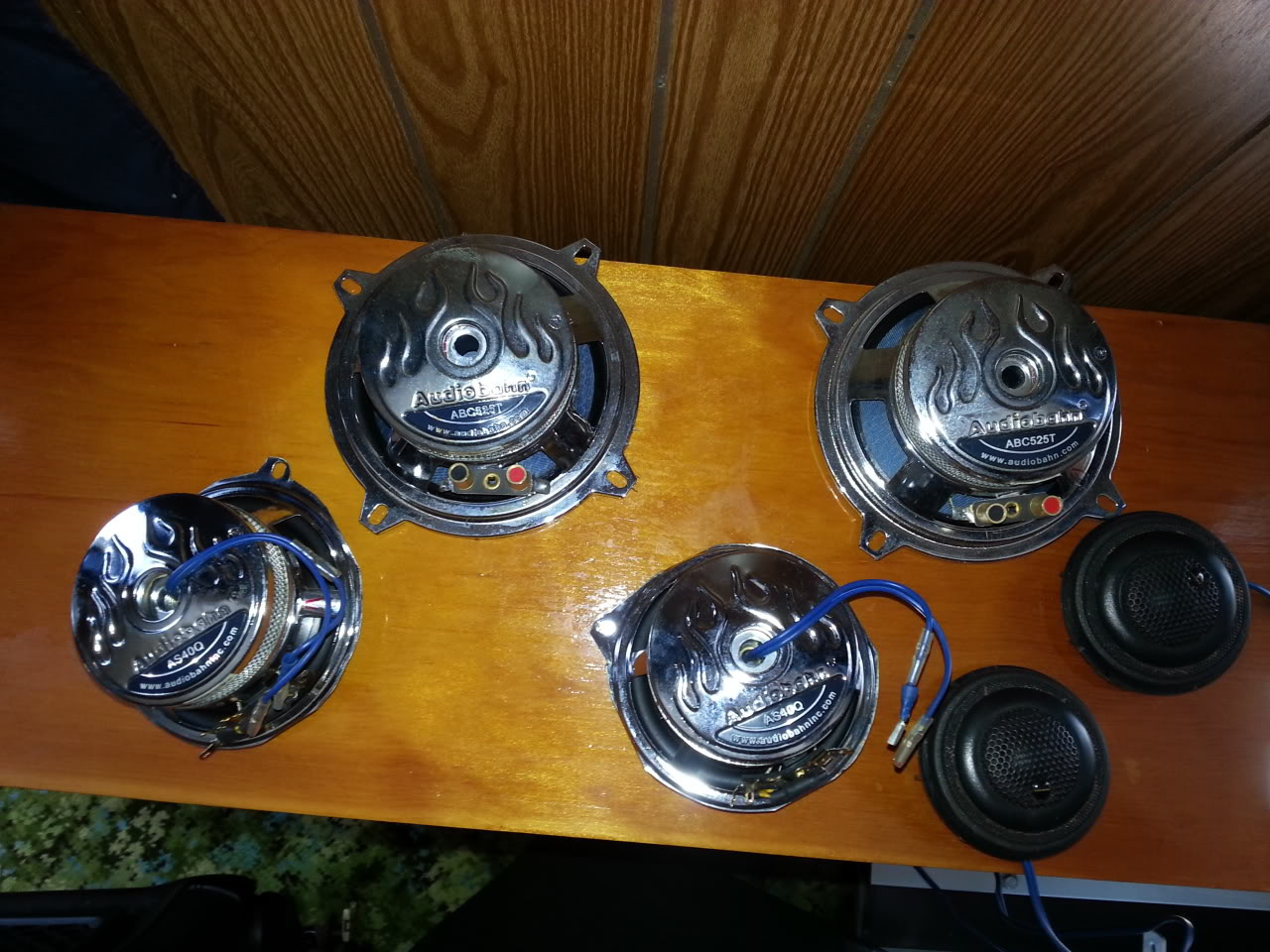

here's what we have so far.
not sure of the quality of the audiobahn speakers. i know the sub is pretty good though seeing it is a rockford.
i have to do some trimming on the stereo to get it to fit, then some more rewiring.
