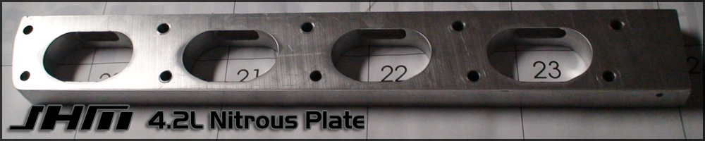

I found that the DP's are the best money spent. Most chips are just smoke and mirrors with no results. NOS is a great way to go for power of course. But remember you don't have a 88 dodge shadow. The B6/7 S4 have multi stage intake manifolds and if you even think of spraying NOS in the car you need to spray it after the intake runners or you will get a real nice NOS back fire when the flaps in the intake change and there is turbulence.
Here is a NOS kit made for the B6/7 S4... After you get the NOS you can get headers. I just got mine last week

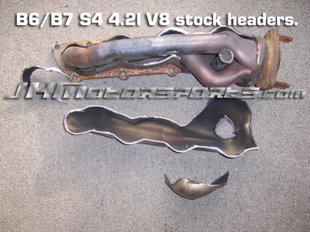

I haven't had the chance to install mine yet. But several of the people that have then love them and rave about the performance. If you look at the stock manifolds you can clearly see that is a weak spot.
As far as sound http://videos.streetfire.net/video/J...oit_643331.htm
There might be some other clips from people. But the video of my car was made by the same fella that dose some of the JHM videos so I saw it there. The blue car has the headers. Watch it take off at the end of the video.
