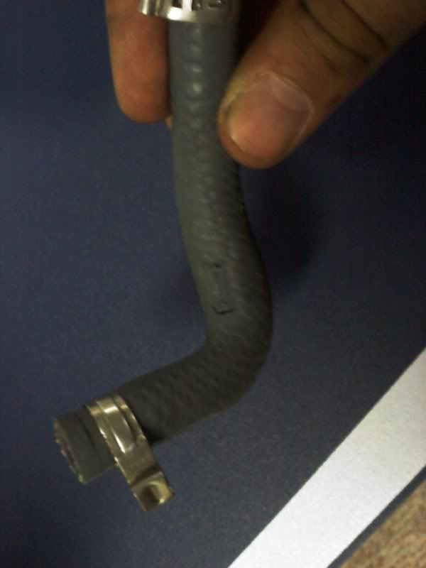

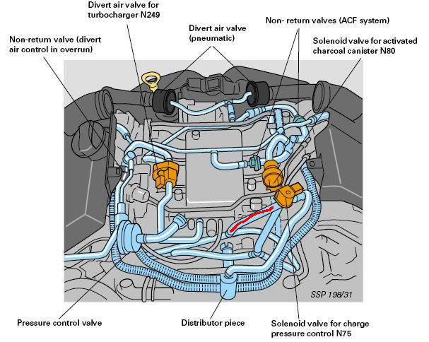

Default Found Boost leak
Hey guys, found a boost leak after testing it yesterday, here's the picture of what hose it is, highlighted in red.
Also here is the hole in the hose itself
When i found the hole.. i took the hose off, and since it connects to the n75 valve.. i removed it from there, but when i did the n75 valve pretty much feel off of the hose, spring and all, like it was barely attached. So i ordered one from audis4parts, and am now waiting for it to come in. Do you guys think that small of a leak, combined with possibly faulty n75 valve, would be enough to throw the p0102 code and make the car stall upon starting? Also any suggestions on vacuum hose sizes for replacement, auto zone has a kit that has 10 ft. of 4 mm., 5 ft. of 6 mm. and 2 ft. of 10 mm. hoses. Here's the Info
Think that would work? If i'm buying the kit i guess i'll just replace all my hoses. Any more input from you guys would be great. Helped a lot so far.. have a feeling i'm getting pretty close to having a working, chipped, S4 pretty soon.
