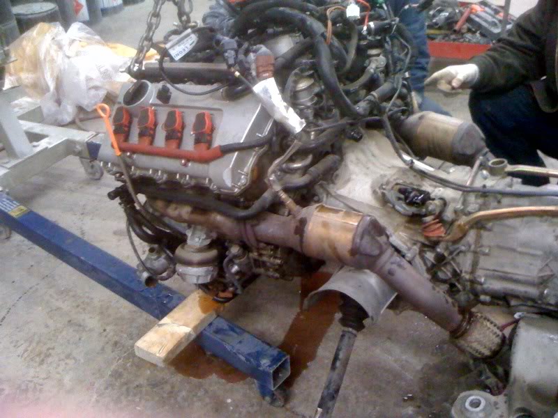

UPDATE:!!!!!! K so since the car wasnt moving lol, we took it all apart. I got pictures for you guys :D
Here is the beginning, starting to take the obviuos stuff off.
Attachment 40244
Got a little bit more off here. CHECK OUT DEM INTERFOOLERS man :)
Attachment 40245
Got everything out now, took quite a bit. This audi is impossible to work on haha, you have to take everything off in order, because you cant even get your hand anywhere in there. Very little space in this engine bay, since the motor is too damn big for this car haha
Attachment 40246
AND FINALLY....here is the culprit. We had to disconnect the trans cause i wanted to look at the clutch. And noticed that the front wheels wont spin, however the back ones are fine. So then we started taking apart the trans. And the Transfer case i believe is what this is....is broken :( lots of metal came out haha.
Attachment 40247
DAMN it!!! going to AUdi tomorrow after school.
The new clutch and pressure plate are coming in tomorrow, and i will also replace them :D just to make sure i have a new one.
Still not sure how this could have happened. I dont believe its from beating the crap out of this car though, cause something weaker like the clutch would have gone first. THe car could have been parked and left in gear and then hit in the back....something along those lines. But ill never know.
So the i will order everything i need tomorrow, the car should be put back together this week. ANd i will drive it haha :D finally

Went to Continental Audi today. The case in those pics is the case for the differential. Brand new with my Auto Body shop discount cost me $1116 coming from Florida haha its the only one in the country, and not even Germany has any right now.
Will be about a week till i get it.
Sadly im paying for someone elses mistakes
