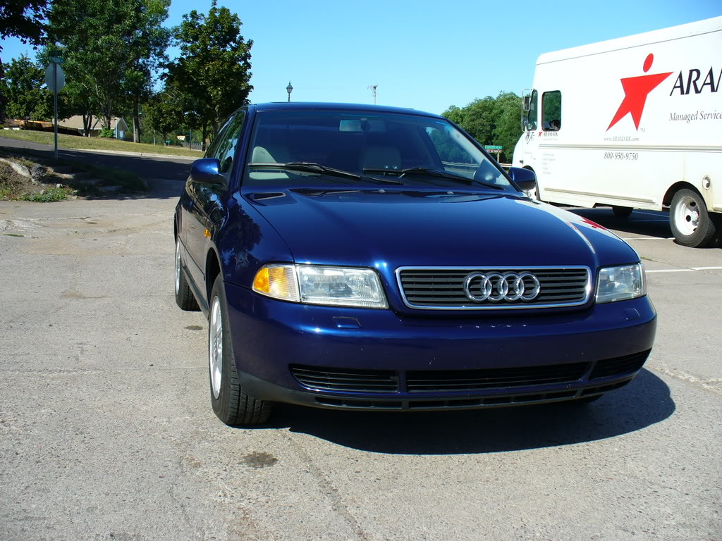

i love that color. do you have a check engine light on? i give you props for actually having a boost gauge, most people ask similar questions with no idea how much boost they are actually making. if something happens that your car doesnt like, to protect itself, it will go into 'limp mode' which limits boost to 5 psi and holds back timing and so forth to prevent more damage. i would go to autozone and check for any codes that might be stored in there. if there are none, then you probably have a leak somewhere. type in 'leak test' or 'tennis ball method' in search.

We should get pictures of our Michigan Tech plates together when it's not so crappy looking outside. You staying up here for the summer? I like how you took pictures in the Hardee's parking lot, right?

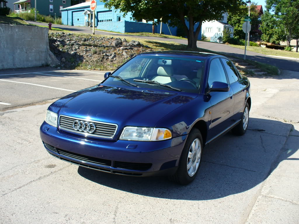

Why are your wipers so high up?
