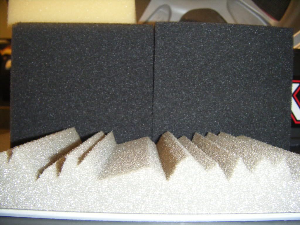

If you look closely at a road surface you can tell that it is really not that smooth as represented by the model in this picture:
Attachment 31787
With the high grip rubber compound used in your summer performance tires the contact area conforms to the irregular surface of the road:
Attachment 31788
That amount of contact can generate a tremendous amount of traction in the summer time but what if the road in snow covered?

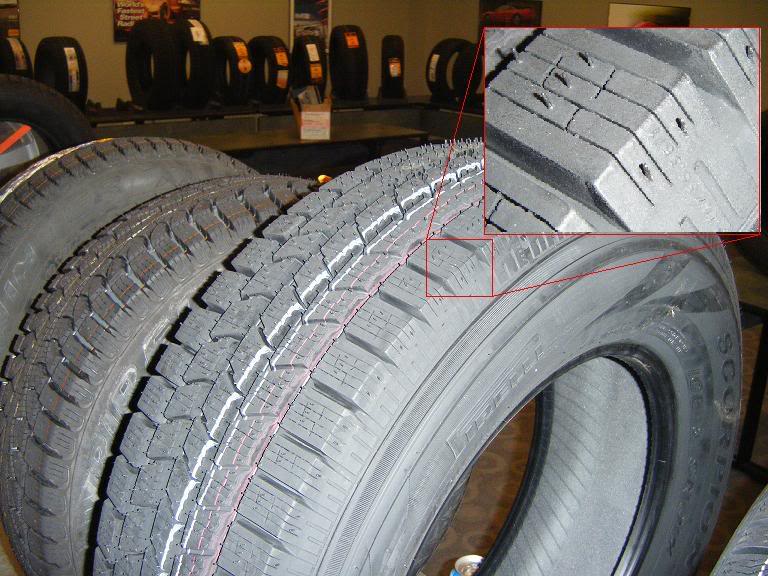

Let's look at the first part of the puzzle; tread design.
This picture shows a winter tire tread design which, as you can clearly see, utilizes a large number of sipes:
Attachment 31789

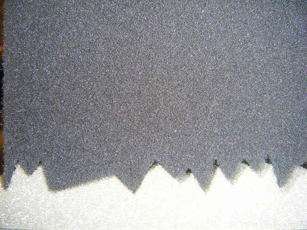

When the road gets snow covered the tire is no longer able to conform to the surface.
Attachment 31790

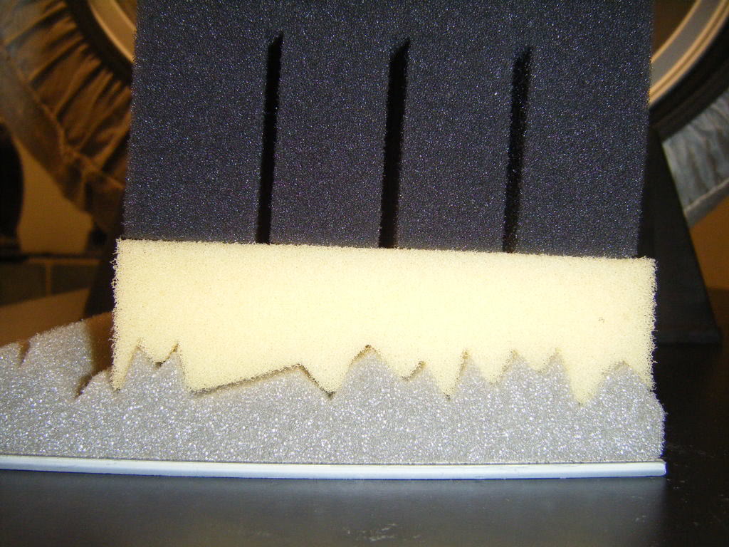

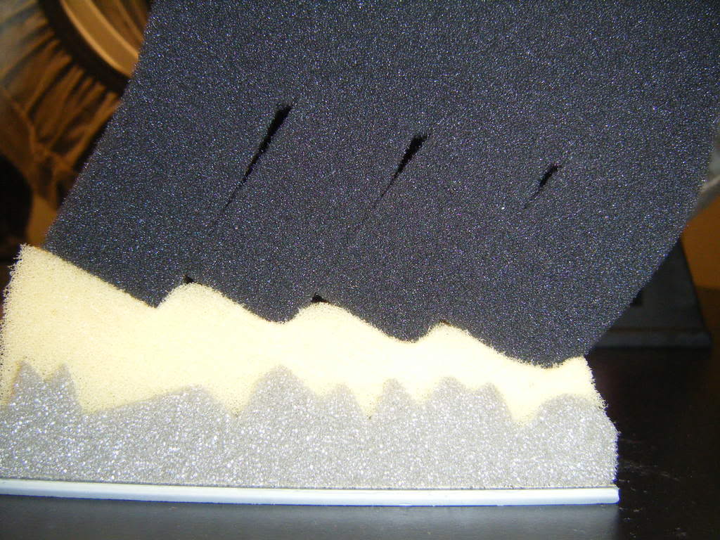

The siping allows the tread elements to flex under stress create aggressive "biting edges" when braking, cornering or accelerating.
Attachment 31791
