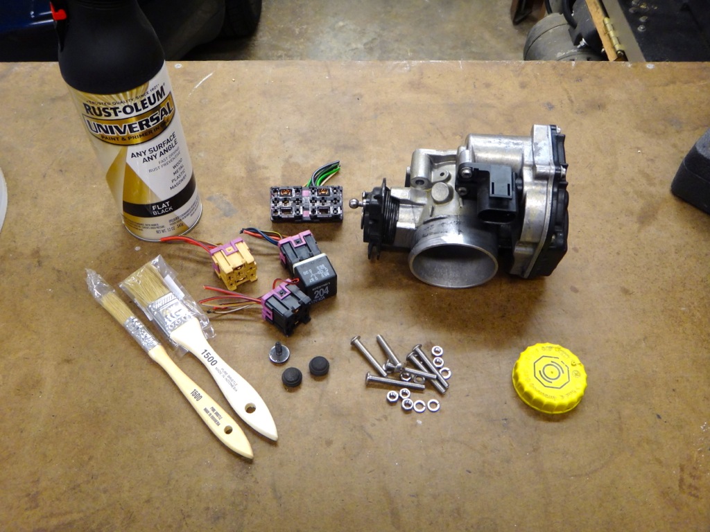

Stopped by the PnP today and grabbed a few things. I was looking for a specific relay but didn't have any luck. It's the relay that allows for programmable intermittent wiper speeds.
Got an AEB throttle body to resell, some relay plugs, a relay, a new brake fluid reservoir cap, and a couple fender screws and bleeder valve caps.
I picked up a can of rustoleum flat black paint to spray my lower grilles, they're looking a little rough. Got some new stainless hardware for my fog lights and a couple paint brushes for when I do my calipers/carriers.

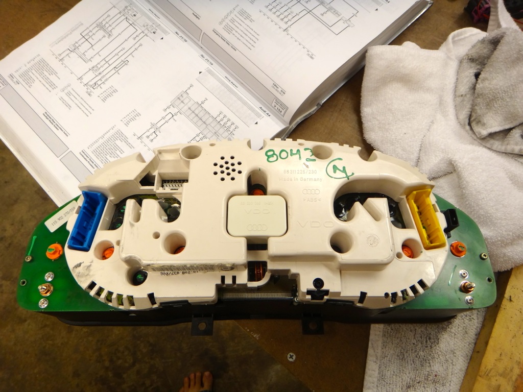

I started by checking continuity of the wire going from the VSS to the cluster, all was well. Next step was to check the connections within the cluster to see if the signal was passing from the blue plug to the yellow plug. I pulled out the cluster.
All looks fine and dandy...

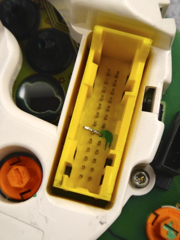

Wait a minute..whats that?!?
Cheeky bastard!!
Could that possibly be the pin for the VSS? Yes it is, T26/6, blue/white wire that goes out to the CC module and ECU.
Now, is it merely a coincidence that the green paint you see there is right next to my bent pin? That green paint is from the pick n pull when I pulled the cluster. The only thing I can imagine is that the paint pen slightly bent that pin. All was well for a number of months until the last time I pulled the cluster when I did my big rewire. It must have got shoved over when I plugged in the yellow plug last time.
I bent it back into place and made sure it was as straight as could be with a magnifying glass.
What I can't figure out is what pin it was shorted to. It was touching the opposite pin, #22. However I couldn't see pin 22 in the wiring diagram for the cluster processor. The wire is brown, so maybe it's just a ground.
I haven't driven the car yet since I've got the bumper off for realignment while I replace the fog light hardware. Tomorrow I'll give it a run and hope for the best. I cleared the vehicle speed signal implausible code tonight for hopefully the last time.
So after months of having the CEL on and a speedometer that worked 1% of the time, $100 in parts, at least 15 hours of diagnosis/labor, the fix took 5 minutes...

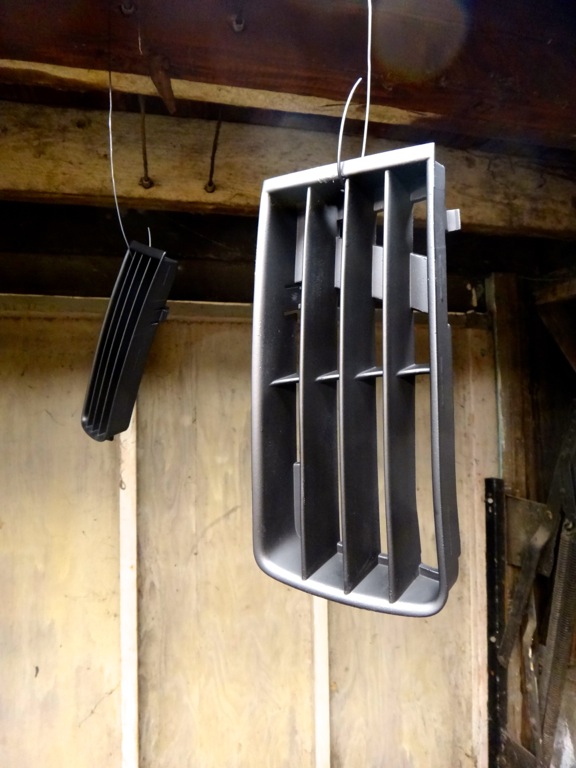

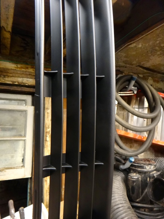

In other news, I pulled the lower grilles, sanded out all the rock chips and painted them. So far they look great, the color is a perfect match to OEM.
Cheeky bastard!!
Could that possibly be the pin for the VSS? Yes it is, T26/6, blue/white wire that goes out to the CC module and ECU. Now, is it merely a coincidence that the green paint you see there is right next to my bent pin? That green paint is from the pick n pull when I pulled the cluster. The only thing I can imagine is that the paint pen slightly bent that pin. All was well for a number of months until the last time I pulled the cluster when I did my big rewire. It must have got shoved over when I plugged in the yellow plug last time.

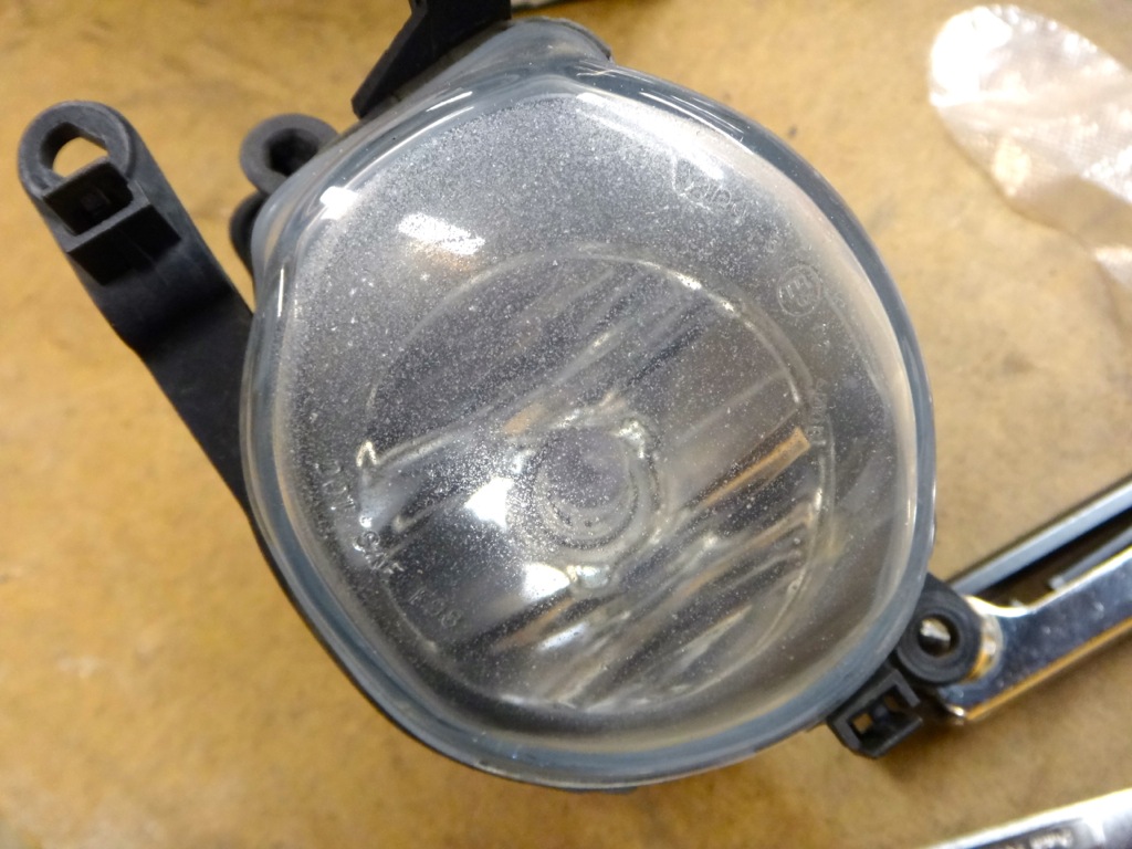

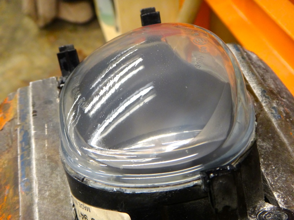

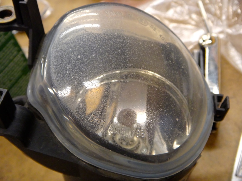

Today I restored my fog lights. I used a pneumatic right angle random orbit sander and went 60-80-120-220-320-600-1000-1500. I followed that up with the little sanding pads and compound from a Turtle Wax restoration kit I picked up for $8. All that was followed by the included base coat and sealant.
Before:

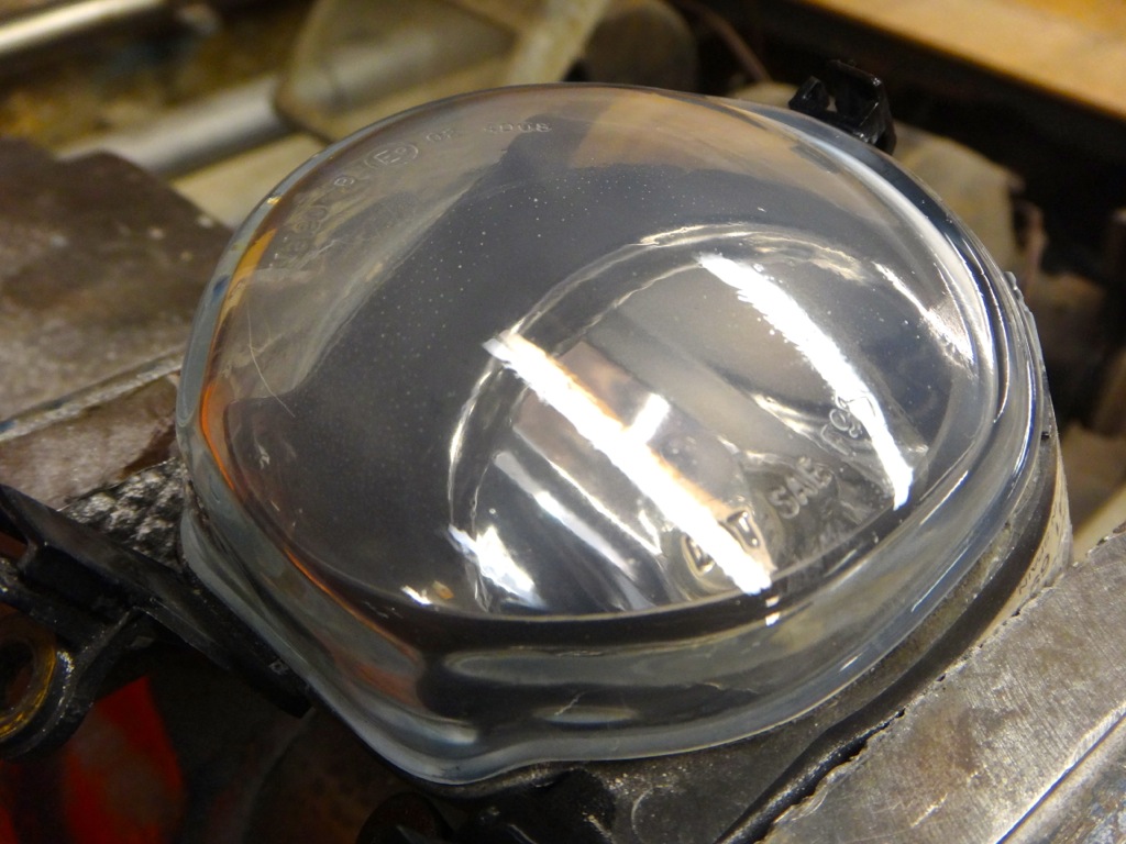

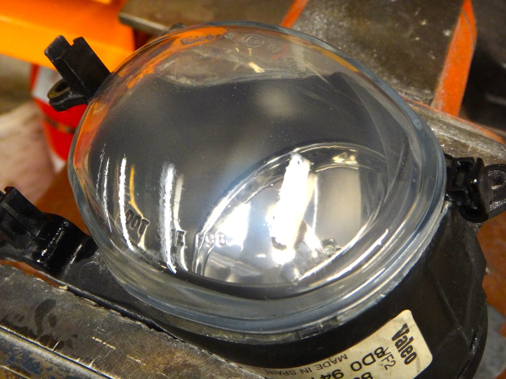

After:
The sealant is still drying, so hopefully they stay looking that clear once it dries.
Before:
After:
