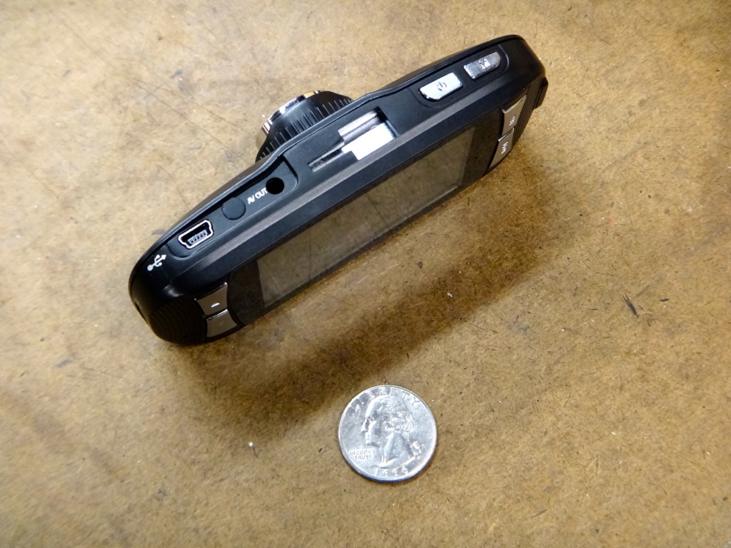

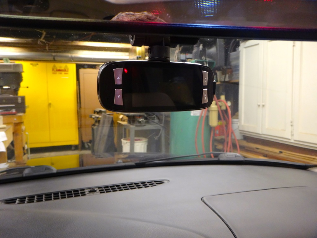

My G1W dash cam arrived today and I'm mighty impressed. It is MUCH smaller than I anticipated and super light. The mount it came with seems to be well made with easy to use but secure adjustments. I have it mounted just below my rear view mirror right now, I may move it further behind the mirror later. I wasn't able to record anything since my 32gb micro SD card hasn't shown up yet, but the picture quality looks great, even at night time. For $50 I'm really really impressed. With all cheap things though, it's the long term reliability that usually comes into question. Only time will tell there.
I'll post some pictures tomorrow.

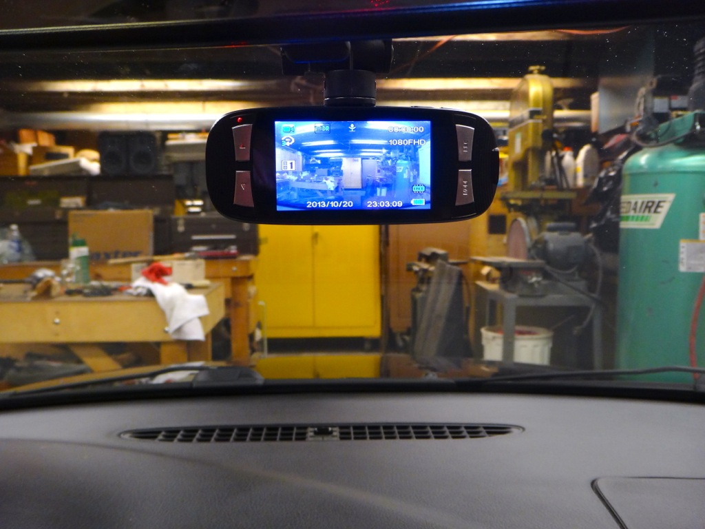

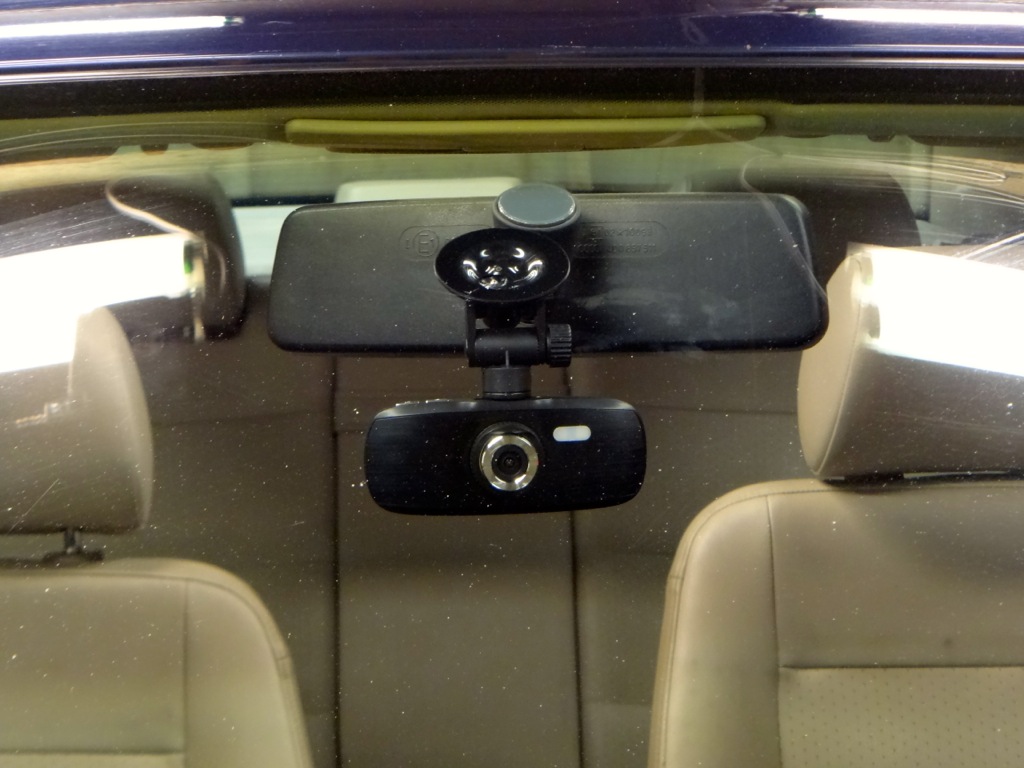

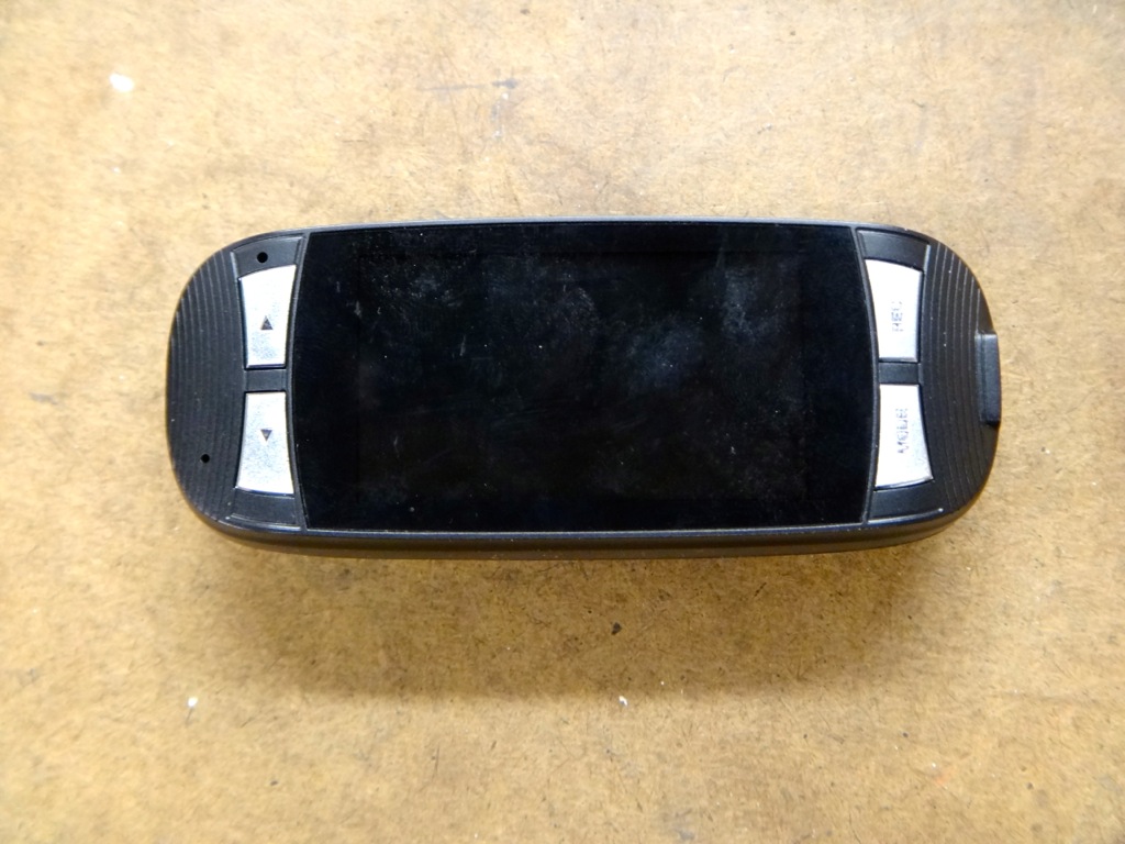

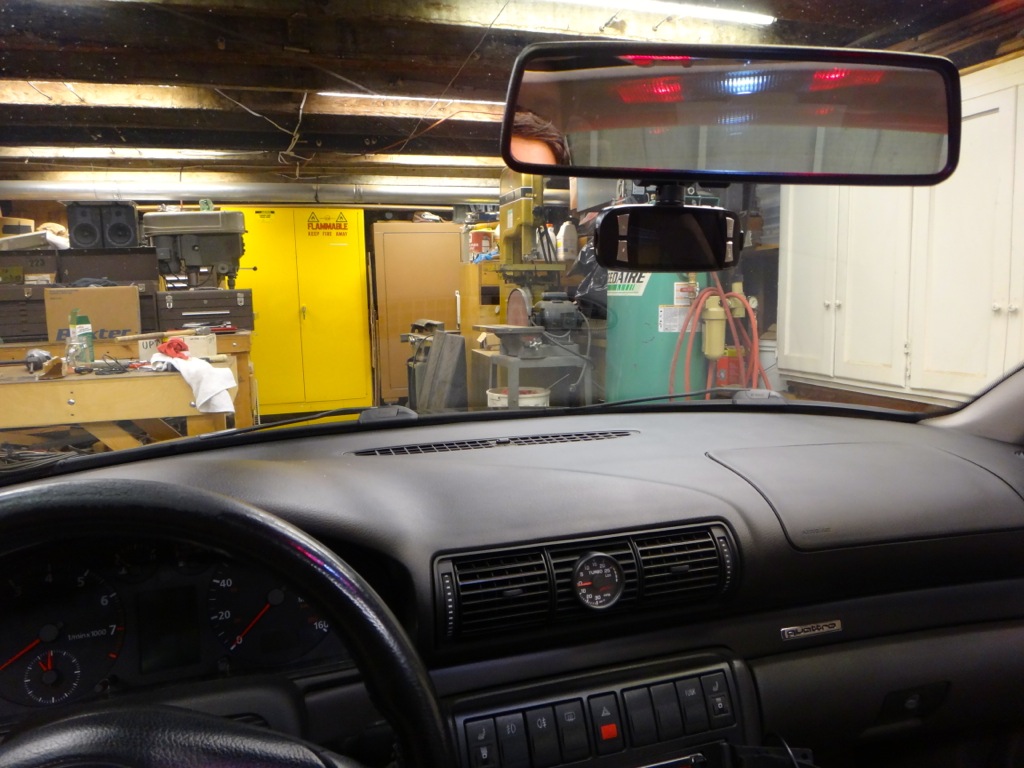

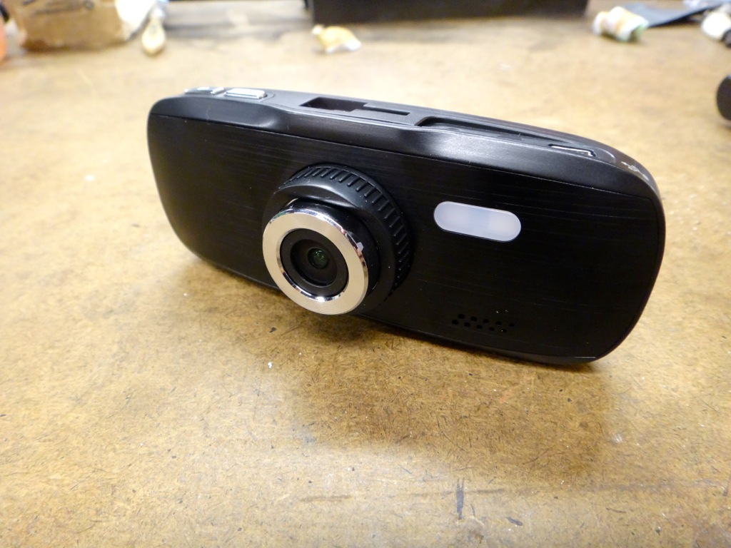

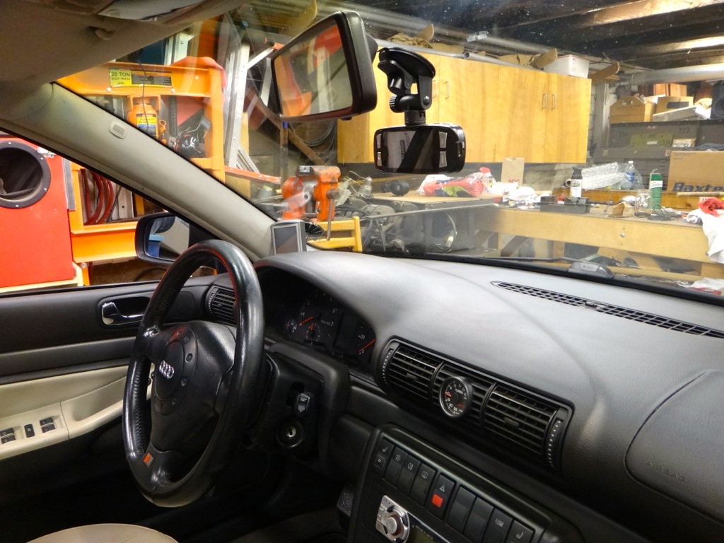

Here are a few pictures of the G1W camera installed. I've been having some memory issues with it. I have to restart the camera to get it to start recording again, a bit of a pain in the ***...sometimes it'll work for 5 minutes, other times 2 hours. We'll see how it does. When it does work though, it works very well.
