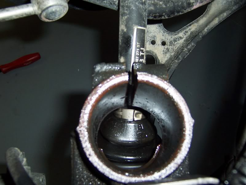

I'm trying to install Euro S-Line springs into my 06 A3 2.0T. I've done this before on several cars, so I'm pretty familiar with the process... I have the strut about 95% out of the socket that it sits in. See this picture for the socket I'm talking about (This is from someone elses install)

THe problem is, I cant seem to get the assembly pushed down far enough to release the strut completely. The whole piece the socket is part of is hitting the sway bar and pretty much can't go any further down.
1) Yes I've disconnected the sway bar link from the strut itself.
2) I've even unbolted the lower ball-socket from the lower a-arm.
3) I've loosened the drive shaft bolt -- but not completely taken it out.
I'm stuck right now and could use some help ASAP. I'll get some pictures in a few minutes..

Ok, I actually got it all done.. Found out that you have to disconnect the sway bar on both sides of the car at once for it to move down enough to allow the strut to come out. Ugh.
