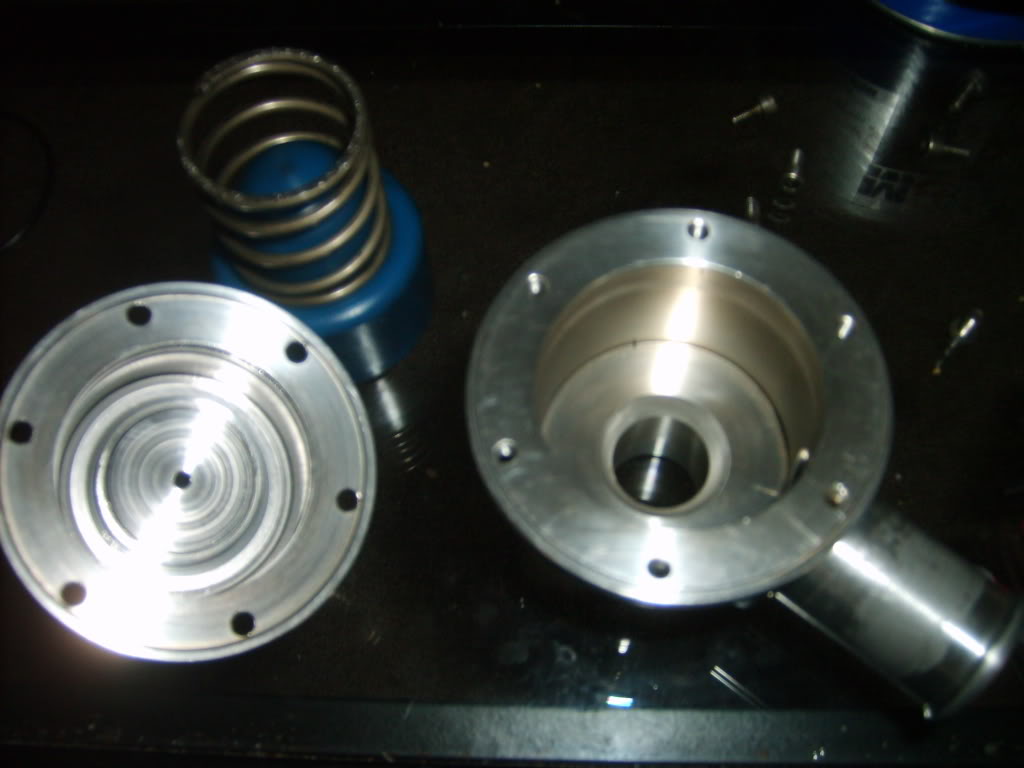

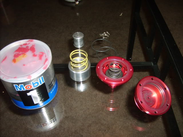

ummm.....what? im trying to make sense of this but cant...how do you fit a dv inside a bov? what longer screws? and what settings?

Hope we are talking about the same thing here. I have a bov that i bought from forge it comes with longer screws and your stock dv fits inside of that the whole unit fits like the oem dv.
I dont see what you find so hard to understand, this is also a adjustable bov 3 settings?????

oh ok i thought you were talking bout the 004. my mistake. which forge bov do you have? the rs? and why put your 710 inside of it?
