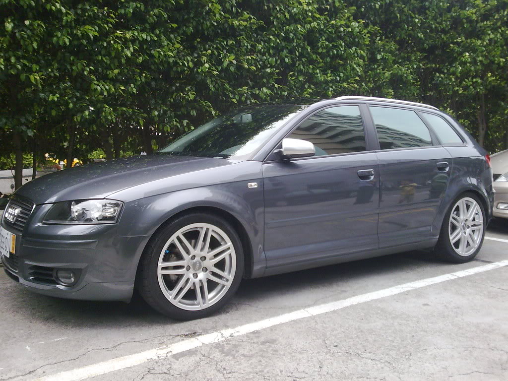

I will measure my drop with the KW V3s. As you can see on the pic, the back is pretty low, but the front is fairly high, and it is still not at its maximum height. I will measure the drop when I go out today. As for ride quality, with the 17s, it was indistinguishable from stock in terms of comfort, performance was substantially improved. With the 18s on 40 sidewalls, the ride is stiffer, but not harsh, and this is on Taipei streets.
This is with 18 225/40 PS 2s on OEM Audi RS4/Titanium package rims. These rims were actually lighter than the 17" stock "excalibur" rims that came with the car.
Ok, I did a measure. Fronts are 25.5inches and rears at 25 inches. No rubbing EVER. Scraped one (not the front chin, under the car) on a VERY steep parking ramp when it met the level surface at the bottom.
