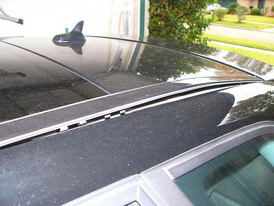

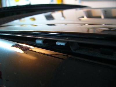

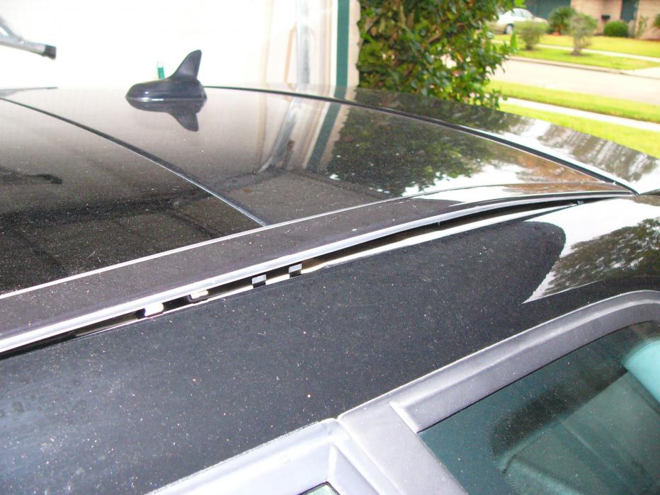

Hi. I came out into my garage one day to find that the molding strip on one side of my '09 A3's roof had popped out.
Upon closer inspection, I could see little white clips underneath had broken (I presume due to heat).
Any idea where I could get replacement clips online? Not really any Audi dealers near me (though there is a Voltswagon place).
Thanks.
