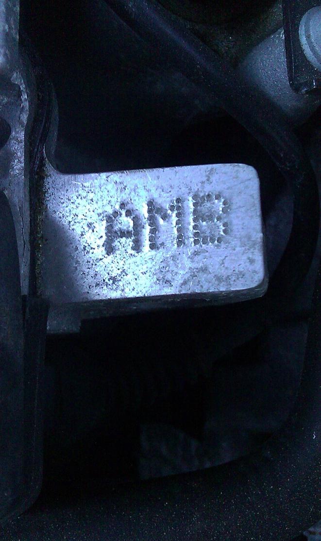

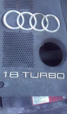

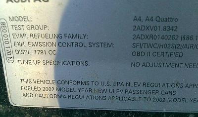

I also have 2002 Audi A4 1.8T and I am looking for TCM location. I believe one of the user attached the picture but cannot view them anymore.
Please help me in locating TCM module on 2002 Audi A4. I just bought this car couple of months ago and I have this issue now. I have another window regulator issue also but I want to fix this PRND flash issue before I touch anything else.
Is it safe to drive? Also, I've read that if I disconnect negative terminal for 15 minutes and then recoonect might reset ECU/TCM and might fix the issue but I don't know if I should do that. I don't want to end up where I cannot turn back on my car. Baby on the way by end of next month.
Please please help me locating TCM module in 2002 Audi A4. I am new this car and I am searching on web to find more information.
Thank you very much in advance.
