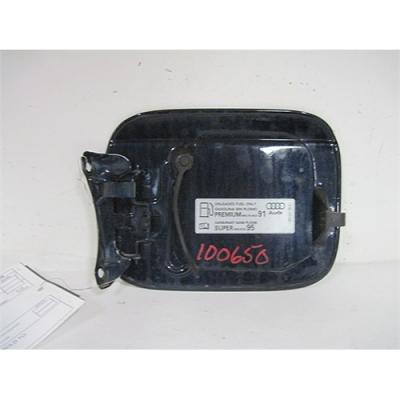

Hi everyone, I had a 2005 audi a4 and the fuel door doesn't lock. The switch retracts the black plastic rod but it doenst seem to come out far enough to engage the fuel door latch. Maybe a plastic piece is missing somewhere in tue fuel flap? Can anyone post a photo how their fuel flap looks like ?Thanks in advance.

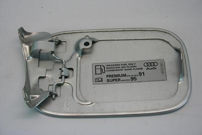

02 05 Audi A4 Fuel Filler Door | eBay. The second photo is how my fuel flap looks it.

I pulled the plastic ring and it's not catching anything. It does not stick out enough to lock the fuel door. the first photo is exactly how my fuel flap looks like and the second photo had a plastic/metal clip that the first photo don't have. Am i missing the plastic/metal clip? is that why it doesn't lock?

I pulled the plastic ring and it's not catching anything. It does not stick out enough to lock the fuel door. the first photo (audi fuel door) is exactly how my fuel flap looks like and the second photo (audi fuel door 2) had a plastic/metal clip that the first photo don't have. Am i missing the plastic/metal clip? is that why it doesn't lock?

Yes i can hear the lock solenoid clicking when i pressed the fuel door button or pulling the plastic ring but wouldn't lock. I pulled the plastic ring and it's not catching anything. It does not stick out enough to lock the fuel door. the first photo (audi fuel door) is exactly how my fuel flap looks like and the second photo (audi fuel door 2) had a plastic/metal clip that the first photo don't have. Am i missing the plastic/metal clip? is that why it doesn't lock?

No, the solinoid engages the metal ring at the rear of the flap... If you leave your fuel door open and lock the car with the fob you should see the solinoid pop out about an inch..
