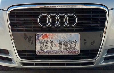

I have a 2007 Audi A4 2.0T and the front grill has had its fair share of wear and tear. There are quite a few blemishes on the plastic. I've done some research on replacing the grill, but I want to make sure I do this right. A pic of the grill is attached.
So my question is this: should I replace the entire front grill, and if so, what is the most affordable online retailer to go with? Additionally, I would prefer a replacement grill that houses the front license plate as well (state law).
Really appreciate any help offered.

Auto parts ware house, or ebay, i just ordered the bottom part for my 99 a4!
the peice should be under 100, if you dont want to spend that then just get some 2000 grit sanpaper water sand the scuffs and spray paint it.

You don't have to buy the entire grill to get just that license plate filler/holder that is damaged in your picture. There are a couple choices from 96.72-126.48 that I saw that fit most cars. We need a vin number to ID correct option codes in order to figure out which one you'd need. Or as another said you could try to repair the one you have. In my experience you have to get a good primer and paint that will adhere to the plastic or it bubbles on you.
I really appreciate the help guys. For anyone that finds this thread in the future the OEM part number to search for is 8E0807285BM3FZ.
Also, here is a very simply guide I found in replacing the part: Audi A4 B7 Front Plate Delete | Audiction
