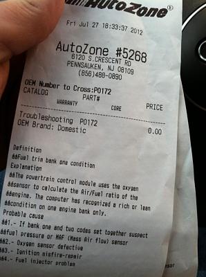

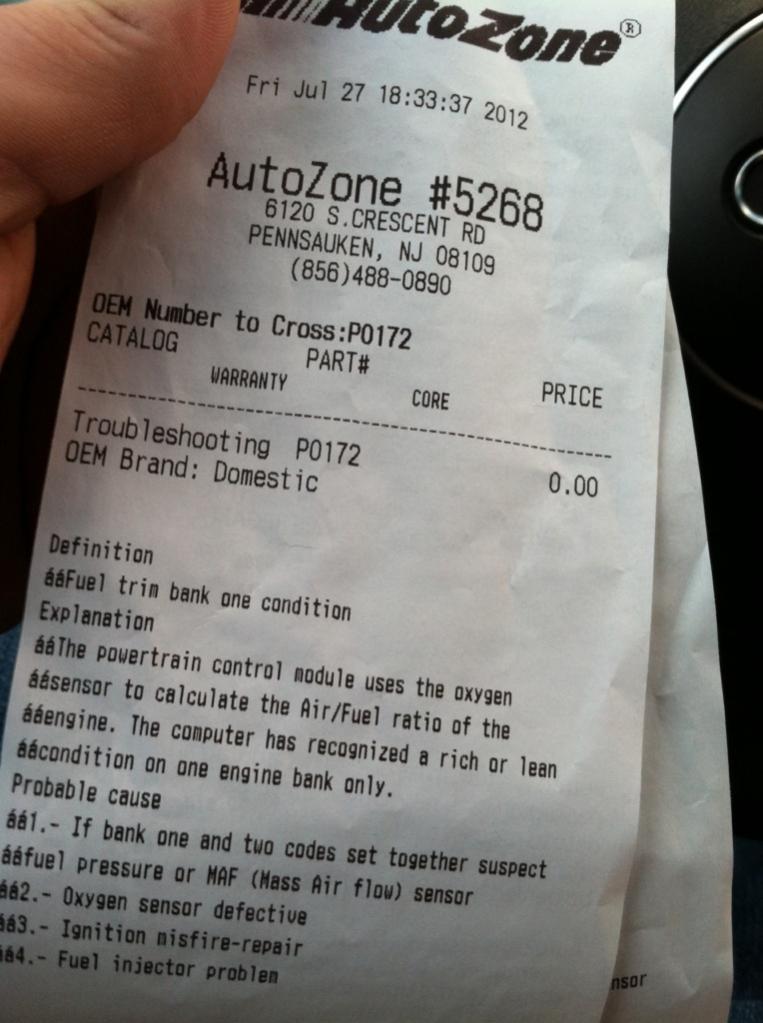

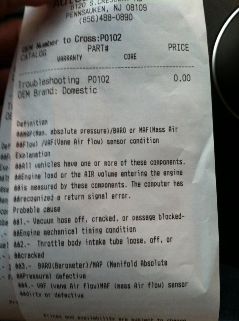

Just got these codes for the check engine light. Is it nothing to worry about or what? car runs fine.

first step, especially if the car runs fine is to clear the codes and see what comes back
P0102-MAF problem. try MAF cleaner, check wiring, replace MAF sensor
P0172-Bank 1 too rich. air leak or more likely related to the MAF problem
good luck
