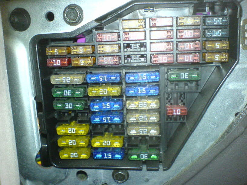

u check the one on the driver's side between the door and dash? looks like this

yeah huh, not the problem(as far as i can tell). The strangest thing is that when i used a voltmeter the the plug(which connects to the blower fan) it showed current in the lines, which makes me wonder if there is either:
-a remote trigger signal of some sort that isn't working properly(since that plug has 5 wires total)
-or a bad connection. If this is the case (and i hear Audis are notorious for loose connectors) does anyone have any clever ideas for making a better electrical connection? I've thouroughly cleaned both ends(plug and fan) with electrical cleaner, scrapers and wire brushes. Does anybody know of a product that increases electrical conduct(ability?), like a grease or something? PLEASE HELP! I'm open to anything, no suggestion is too crazy, because i've already tried everything that popular opinion views as sane.
