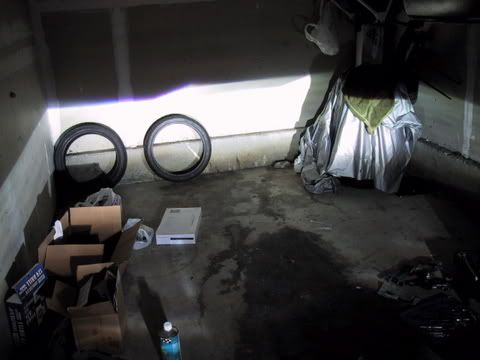

Pretty sure http://www.epimporters.com sells them, but not sure if they are the cheapest. Check ebay too.
E-code lights throw a pattern of light like this:
Notice the sharp cutoff of light.

very nice.hmmm? i like that but between the HID kid and everything, this is getting pretty pricy! any other options on the stock headlamp tp make them work better? I heard some one say about dremeling it out
