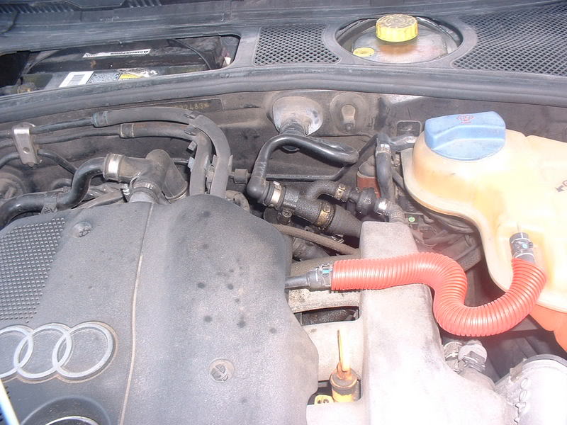

does it do it when you drive to, or has it at all?
if it is:
its the connection right above the red hose.

also he has a 2.8, that pic is of a 1.8t motor
