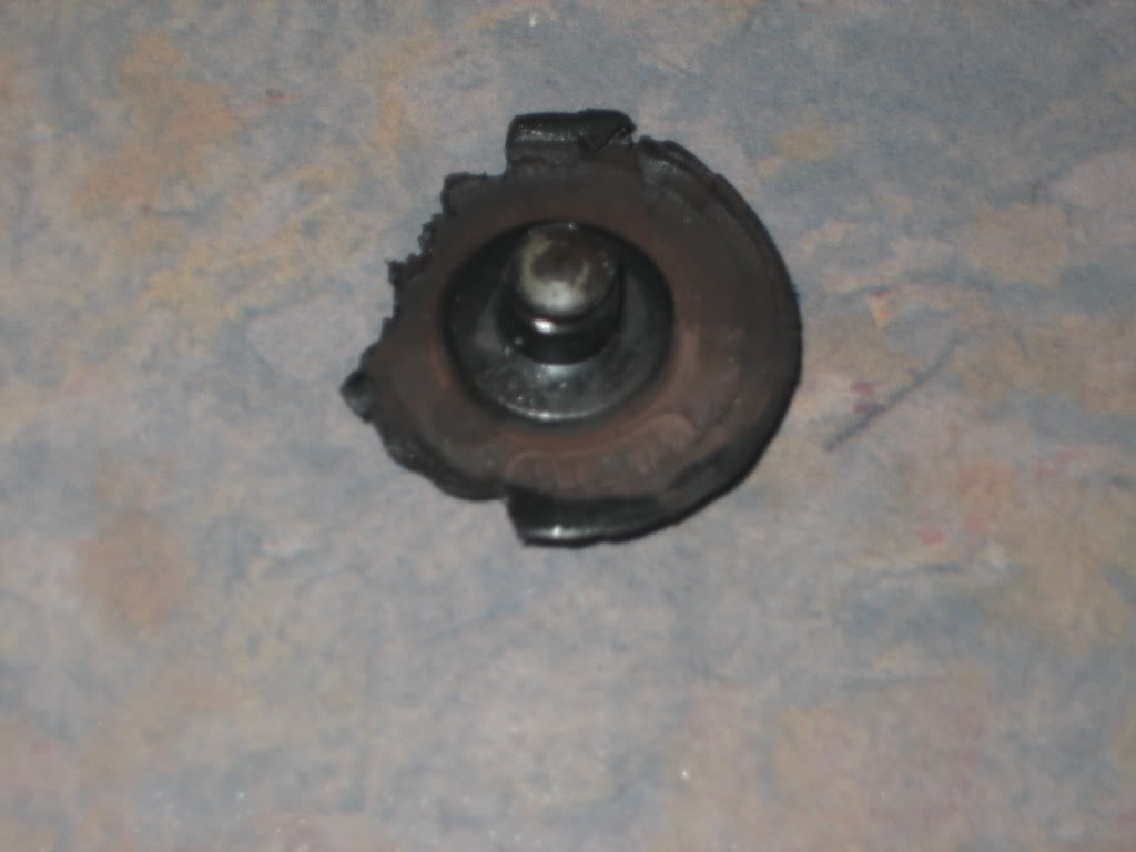

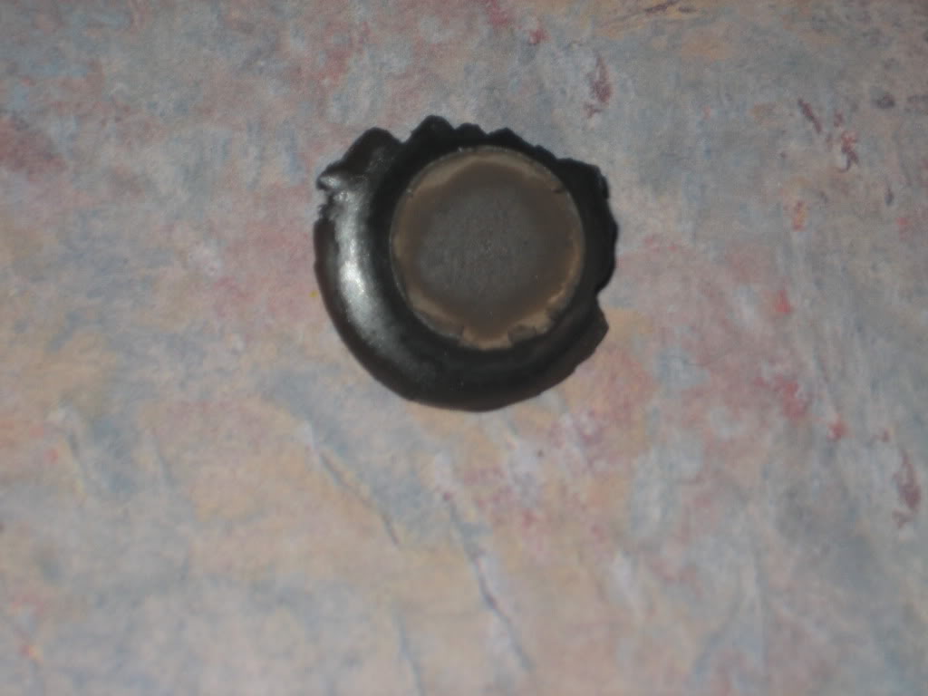

I had the exact same symptoms (no power, no red glowing turbo, rattle). Unfortunately, I did not check on the issue for months. Finally took the turbo out. While my flap is still (somewhat) in place, it was wasn't cloing (by the spring of the actuator) at all. Just hanging there and wobbly.Originally Posted by sweetjumper32
Well I got the turbo put back on. I guess I can't beat this car in a footrace after all. What a difference. When I got the car I wasn't sure if the turbo was actually working. I read that if you drive it hard enough the turbo will glow. This prompted me to go out and drive the **** out of it and the turbo didn't glow. After I got it installed and checked for leaks I took it for a spin and got back and the turbo was glowing a little bit. Also, no more rattle. Which is equally exciting.
Probably could have all been avoided with a boost gauge and tighten the the set screws on the actuator to ensure the flap is held close (yet open when needed).
Here is the flap:
The links to your pics are expired. Could you repost or PM the pics and how you did the fix?
Or does someone has a fix to replace the flap?
Thanks.
