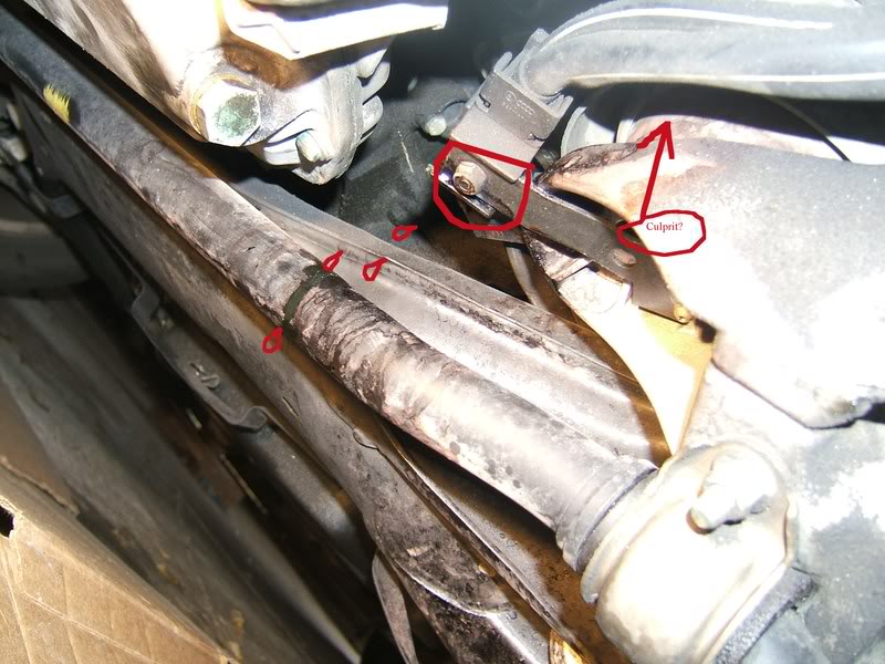

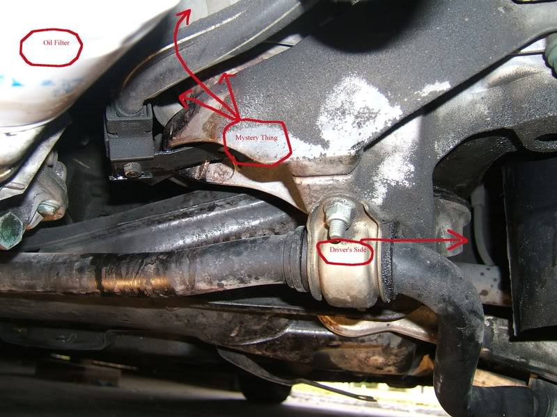

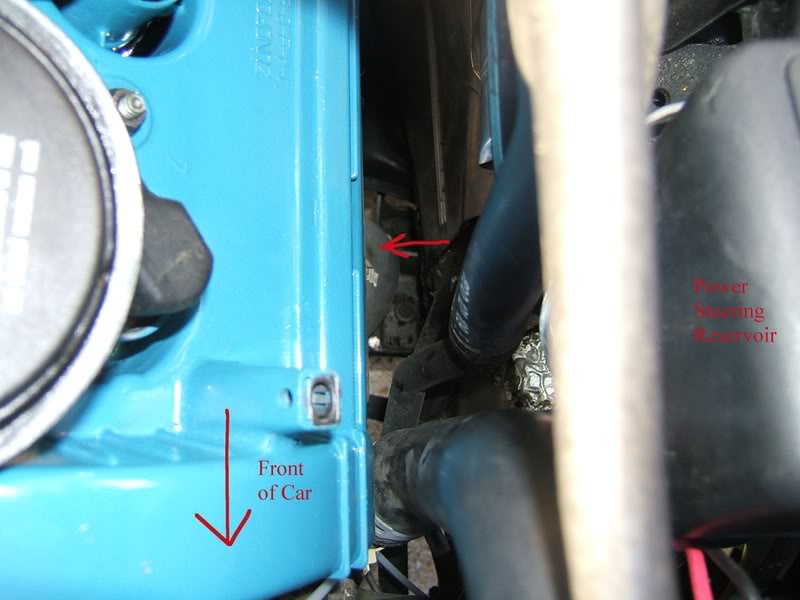

I've got a leak. It drips down onto that nut from somewhere above. What is that canister, drum, looking thing above it? I took a pic from above of the mystery thing, but it's pretty hard to see, I know. Maybe mine is just dirty, but apparently it's white on some cars. The leak itself is very slow and even appears to be slowing. If it drips, I'll get a drop or two over night after it sits for about 15 hours. I'm pretty sure it's oil, though my PS hoses are pretty wet...anyway, it looks like oil. Any ideas?

That mistery thing in your pic is one of your motor mounts, and yes, it has RED hydraulic fluid in them. Change both of them out.

Well, it's good to know what that thing is, but it's not leaking red fluid, what's dripping is oil. Or if it's not, then it's obscenely dirty (I'm almost sure it's oil).

the fluid on the pipe looks green, i woulda said you were leaking power steering fluid. but i would trust auditech over me
