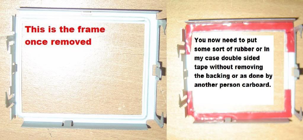

Old Sep 21, 2007 | 07:40 AM
  #16
docurley's Avatar
Joined: Aug 2004
Posts: 573
From: UK (London)
Default RE: Maybe easy fix for fading LCD on instrument panel!
This should help
Step 1: Take out the instrument cluster.
Step 2: Disconnect the plugs.
Step 3: Remove the remaining plugs.
Step 4: Remove the cover. Take out the screws and snap open the cover.
Now put it all back.

I tried it today and it did not work.
In short I used 1/32" thick silicone rubber and made a frame to fit inside the metal frame...
Took a good look at the ribbon that is bonded to the LED plates and it looked intact...but the factory rubber strip was attached as well.
The guy that did this first "DID" say that he made strips to go "UNDER" the plates but I was unable to do the same.
