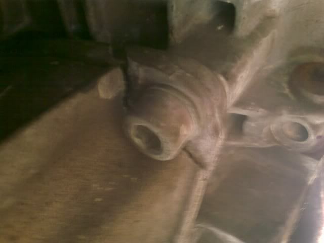

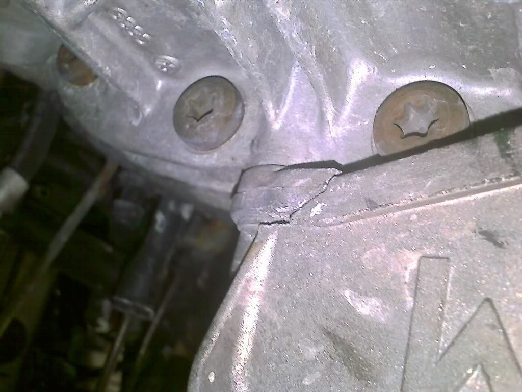

i installed my motor mounts, snub mount and passenger side tranny mount today. i couldn't get the driver side on and realized there are some small cracks in the section that connects the mount to the tranny, so im gona have to order that part from the dealer and get a friend to help me install it.
so i go to drive it. there's a vibration at idle, which i expected since everyone complains about that, i just need to shave the mount a bit so its not hitting the spindle housing. but then i whenever i step on it a little bit, the car starts shaking back and forth quite violently. so i stopped, turned around and parked it[&o]
what could be causing this problem?

so you think its because i have 1 stock tranny mount and 1 street density tranny mount? the driver side is so hard to remove, i gotta get these 4 8mm hex bolts out and they are tucked up under pretty damn good. anyone swap their driverside mount without removing the bracket? how did you do it?
and i just got the snub, not the circular mount to go with it, it seemed to clear the stock spindle bracket by a few mm, but im gona try to shave it a little more to get rid of the vibration at idle. it doesn't really bother me that much since my system vibrates my car a LOT more than the mount lol
but i definitely gotta get the violent shaking fixed. i only went 50 feet, and turned back around. i think im gona try and install the stock passenger side mount back on if i can't get the driverside one on and see if that fixes my problem

got the new mount in, still have the same problem. anything over 20mph and it jerks like crazy. im almost certain its cause of the bracket connecting the mount to the tranny is cracked by 2 of the bolts on the ride hand side. when i tried to remove it, the distance between the crack increased and stayed that way even when i tightened it. guess this was why my transmission had so much slop before lol. wonder how much the dealer is gona rape me on this one...or could i possibly fix it myself? some jb weld? would that hold?

pics
bottom right

top right
