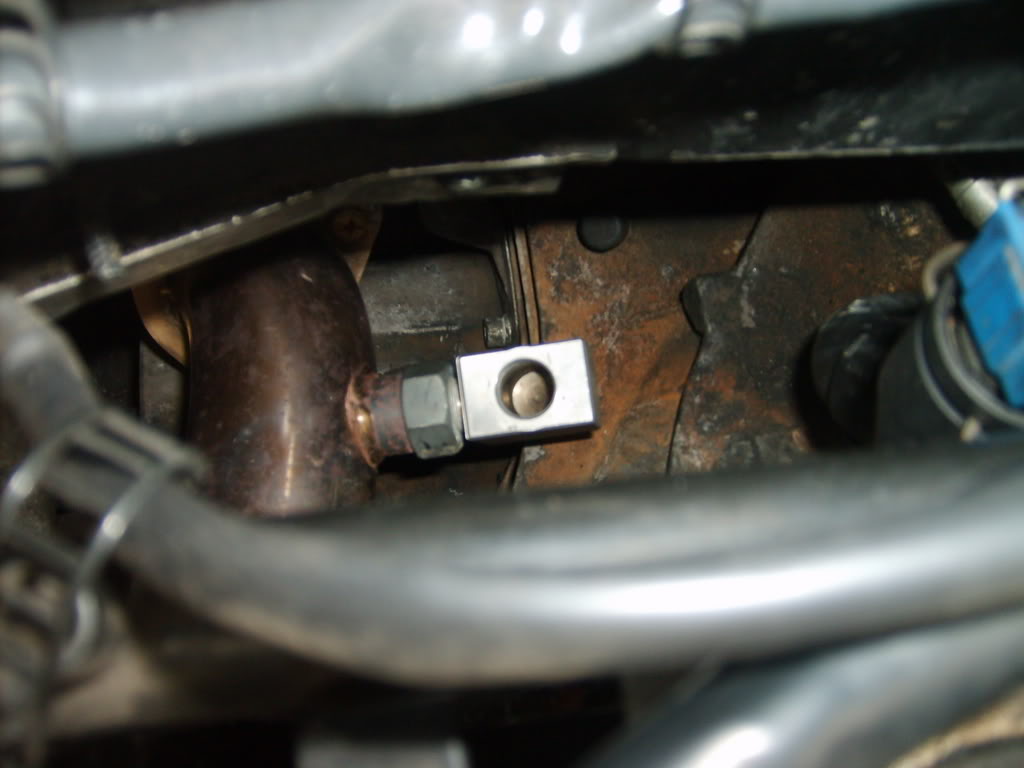

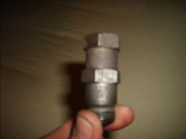

I bought a angle block to get rid of the cel. You can also do the non-fouler mod, but people have seen CEL's even after doing so. The guy i bought this from never had a CEL, and mine is gone right now. The angle block is from Roncho Industries
Non-Fouler Mod
You just screw that into the 02 sensor bung and the o2 sensor into that
Angle Block Mod

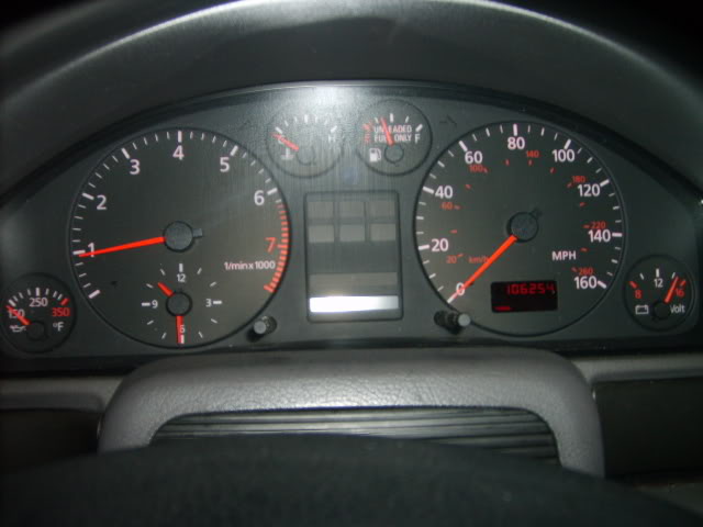

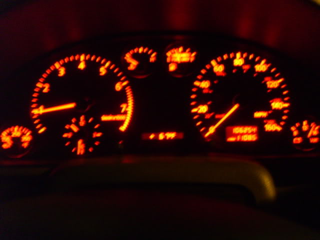

The result
No more CEL
