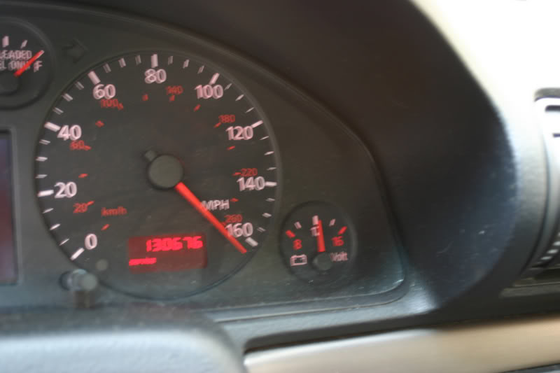

i have hit 132ish on my b5...
but then i gotta cell when i turned the car off...
Stock wheels are rated for 130mph... i think thats why i got the cell...
the cel said something about auxilury speed or some crap...
and as for the rpms... when i was using the stock air box my rpms would be at around 4000 while going 80... but when i got my short ram K&N filter their about at 3700 while going 80...

157ish mph is what i have got on my car. with a little bit of rpms left.
and if you try to get to that mph, you are going to find it comes A LOT faster than if you tried it with your k03

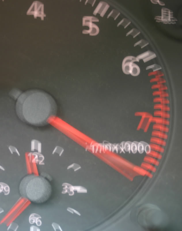

That's sick Chaos. Was that pick taken driving on the highway,track,or on a dyno?And is that your car? you didn'tsay.
anyway, i like it. buti wouldn'tdo iton the street. notin most places in new england anyways.
the pic actually belongs to a user over on audizine, "Tifun". he took the pic using vag com(his car was not actually moving or even idling)
you'd need at the least, rods and custom software to reach that rpm/speed
well for the bottem end, with rods, you can do it no problem.. but stock pistons could melt at that point. just a possibility..
and anything over 8k rpms(sometimes over 7500k)you'll get what's called valve float. which is basically the valves are moving so fast that the stock valve springs aren't strong enough and have enough rebound to push the valves up enough between each engine cycle.. so if you plan on reving your already built engine past 7500rpms regularly, you should upgrade your valve springs also
