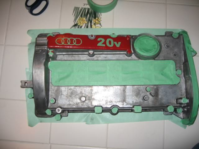

So i decided to paint my valve cover while i was replacing my leaky valve cover gasket.
So first i pulled the valve cover scrubbed it with a wire brush, then sanded it down.
i next sprayed brake cleaner on it to get all the gunk off for painting.
I chose a custom route with audi rings and "20v" emblems(you can choose your own or copy mine..just please give me credit)
First i masked off every hole with some tape since i was useing Krinkle Coat finish

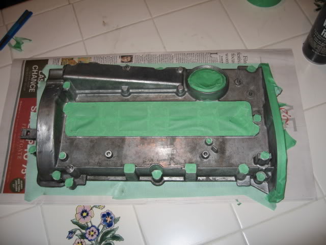

Then i painted the red part(below) with caliper paint because thats what i had and its heat resistant. i just brush on a few coats.

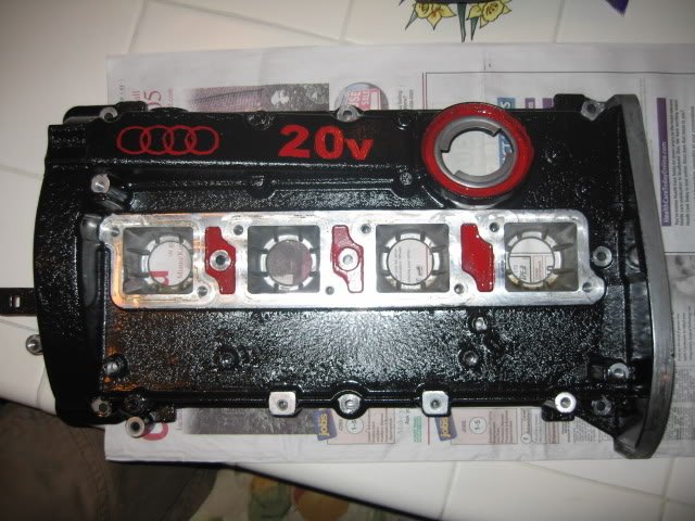

Above) I also added my pre cut emblem and 20v that i had drawn on a CAD program and cut them out on to masking tape(very hard even if you have great focus so take your time)
My plan was to stick those emblems over the red and paint over it with black Krinle Coat then peal away the masking to reveal the emblems.

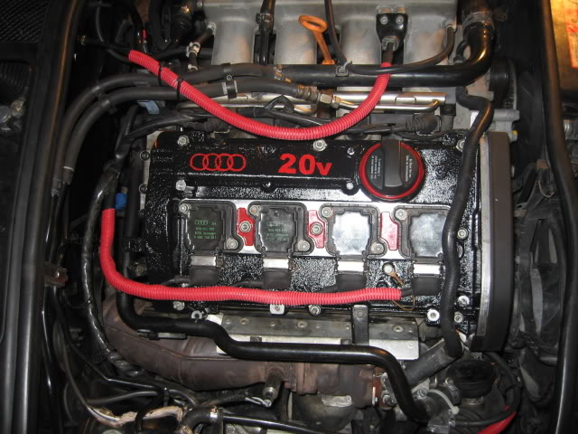

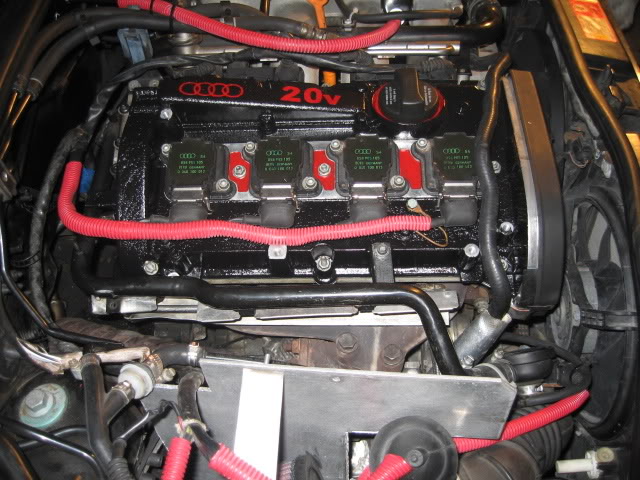

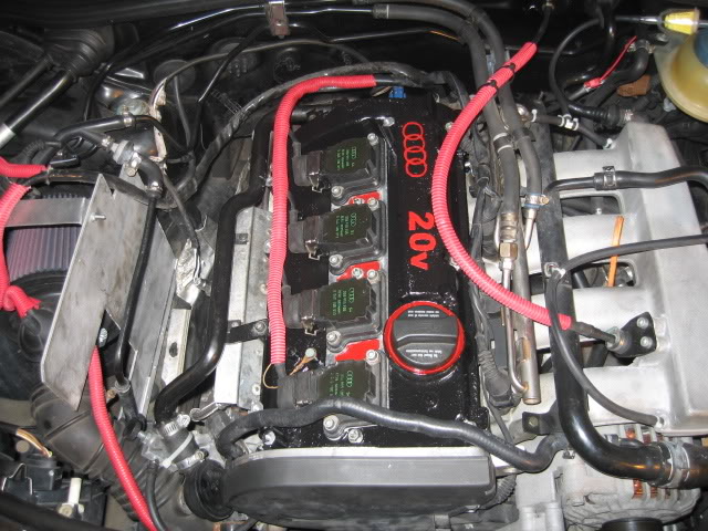

it turned out great and was worth my time. here are a few pics for you guys and remember if you copy my ideai dont car..just give me credit. Thanks and enjoy

what do you guys think of the valve cover?
Old Jan 19, 2008 | 12:48 AM
cincyTT's Avatar
I'm make believe
Joined: Dec 2006
Posts: 17,587
From: In my head
Default RE: Painted Valve Cover *PICS*
busy
Old Jan 19, 2008 | 12:49 AM
Rhinop21's Avatar
Joined: Nov 2007
Posts: 946
From: Behind
I cant stand those ricer red wire looms. But the cover looks pretty good. The quality of paint seems like its lacking but you did a good job. Please just get rid of the red looms.
