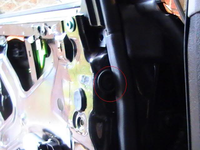

all in red are screws that u need to unscrew, that's how its gonna look

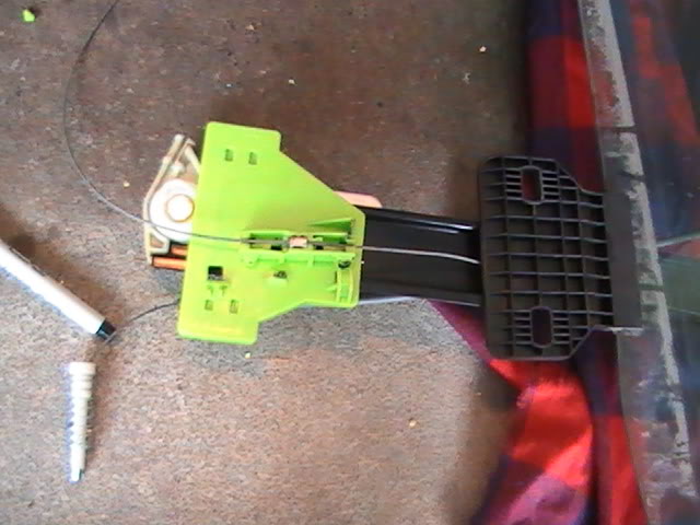

here is the"green thing" that broke(cant really see but it was not holding that ankor)

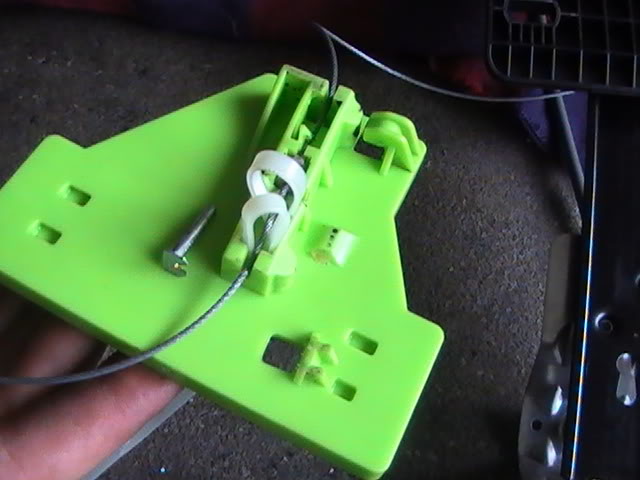

here is where i put nail on top of that cord and zip-tied
looking like this
then i just put glue(epoxy plastic-weld) around that cord inside. I also glued the other side, that looks like waffle.
looking like this
