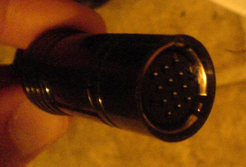

ORIGINAL: a4owner
Guessing non bose because there are no bose emblems. The Rear speakers have the audi emblem on them. The wire with the connector goes about 3 inches and just dangles down. I will take a picture and post it hopefully you guys can help me out with this! Thanks Guys
Does it look like it plugs into this:
If so, that's the cd changer plug.

No i have the concept ones connector is blue with 4 wires going into it
