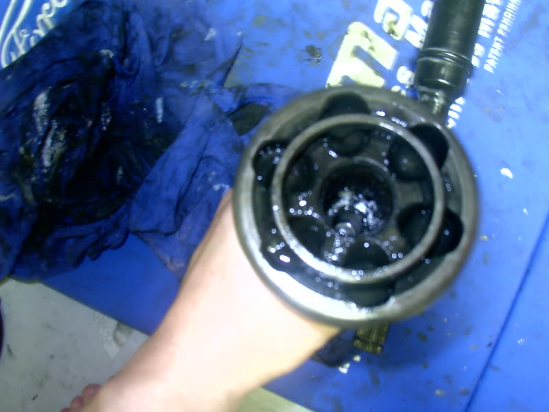

a new half shaft is like ~120 at ecs and will take half the time then to replace the boot itself cause you gotta pull off the cv joint and then you gotta repack it with some grese put the boot on. I had to replace my boot a while ago and if ecs had the half shafts for that price when i did it, i would have just did the whole half shaft. Also its not hard at all, just messy.

so started on the CV boot replacement, there is the axle disconnected from the hub, didn't feel like pulling it off the tranny. now i just gotta wait till friday when my replacement boots come. i'll revive the thread then.
