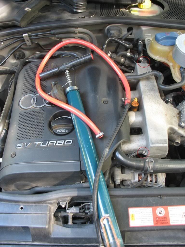

I just did the intake today. Will do the crank case pretty soon before I change my oil. Already ran it through the gas tank a few months ago.
I used 1/2 bottle through the intake where the red circles are in this pic (dont mind the bike pump, this pic is from back when Idid aboost leak test):
I thought it would be best to put it in through both sides of the intake to be sure it wasnt just the first 2 cylinders that was getting all the love/seafoam. There was a lot of smoke through the first application on the front of the intake. Eventually no matter how much I fed it the smoke died down so I figured it was cleaned up pretty well. Then I did the opposite/firewall side of the intake, and there was again a lot of smoke and then it died down. So I feel like it got the job done. After that I changed the plugs.
I honestly dont feel a difference, everything sounds/drives the same (which is good, except for a noisy water pump.) But it was nice to see some crap was buring off, peace of mind is good. I highly recomend, if you do this, to do both sides of the intake. That way all the cylinders/ports get cleaned.

Been wanting to do this on the 30v for a while. Which vacuum line(s) did you use? Pics would be great too.

What about all the other ones at the back, above the throttle body?
