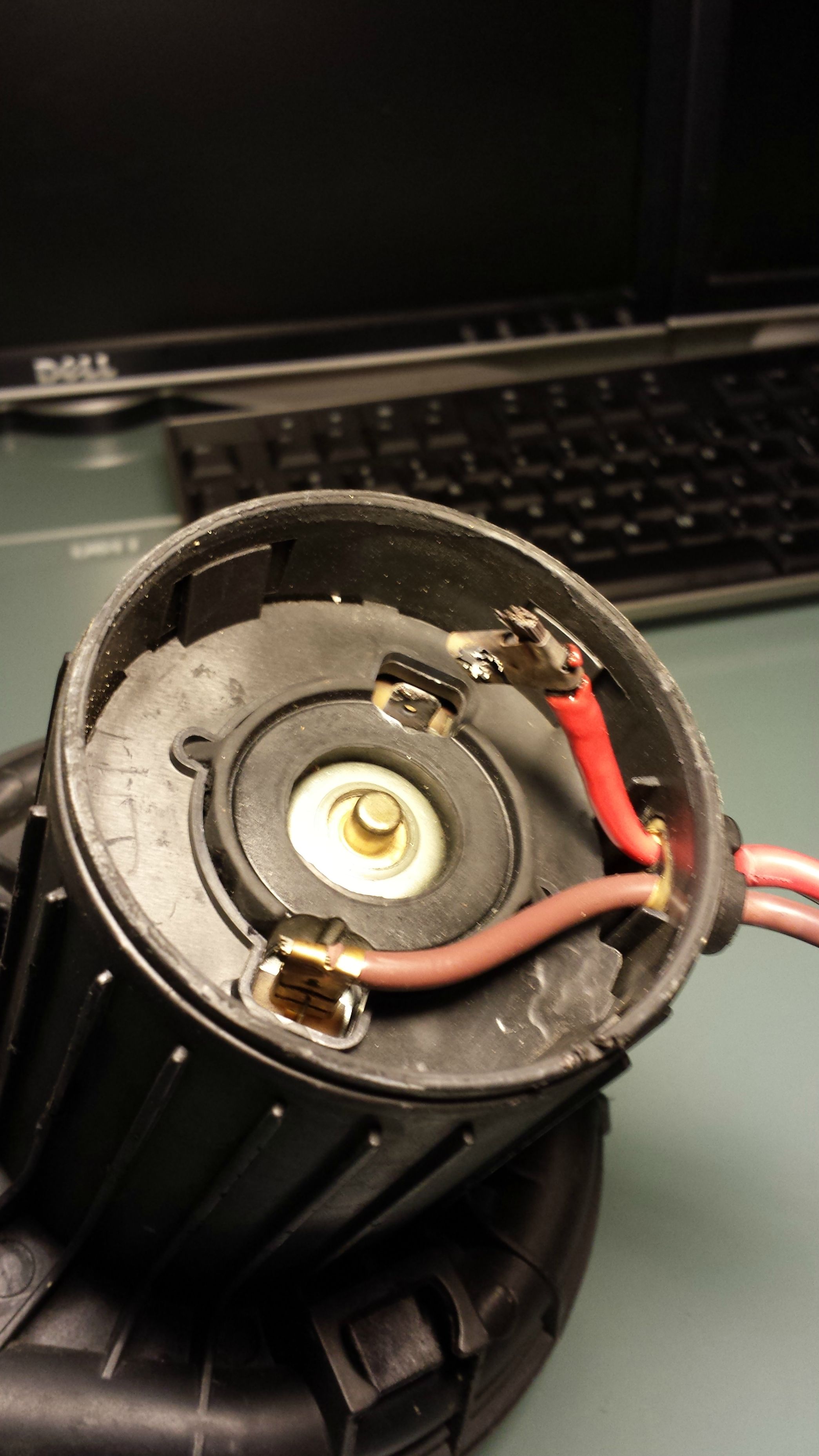

Based on some threads here and some videos on Youtube I went through the steps of narrowing down the problem. Relays, fuse, solenoid, cracked hose check, power and ground all good but no pump running. Well last time this happened (about 5 years ago) the pump was filled with water and seized, but this time it was dry. Well, i went the cheap route and got a non-OEM air pump since a replacement OEM pump was like $600 bucks.
I removed the pump and ordered a new one any how, but decided since i was going to throw out the old one i would open it up and see what was up.
Here's what was up:
So the wire was just disconnected, hanging there. It also looked like there was some build up on the contact that was disconnected but not too bad. I decided to try and fix it any how.
Cleaned up the contacts, threw some new wires in there and used gasket sealant on the cover and wire entry points. Maybe a bit messy, but after a continuity test i plugged it in and turned it on from the VCDS and it came right back to life!
Here's what was up:
