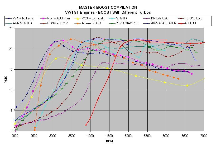

you want boost levels?

where you get that
You should put that in the newbie thread asap

lol, saved that as you as you posted it
and yeah thats a good idea
