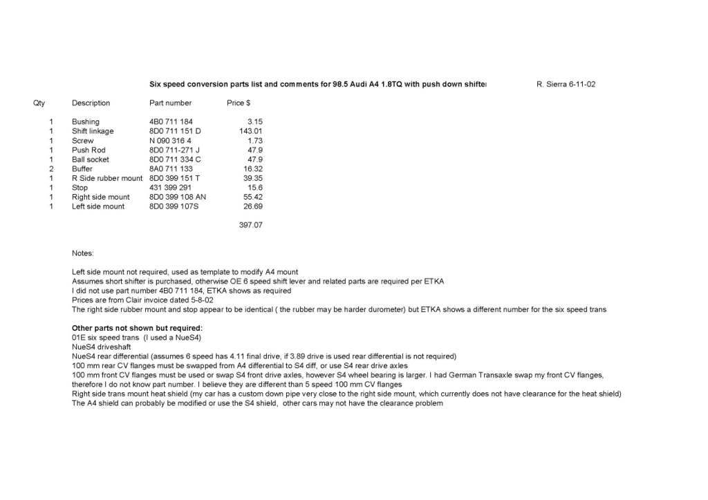

if you go with a 2.8 tranny you dont need a whole bunch of extra parts. its got the exact same housing as the 1.8T tranny. but with an s4 tranny you have a quite a bit more work to do
